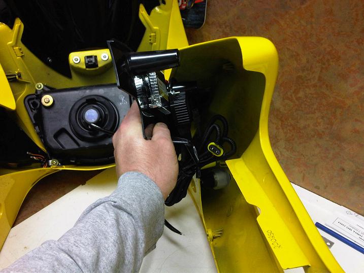

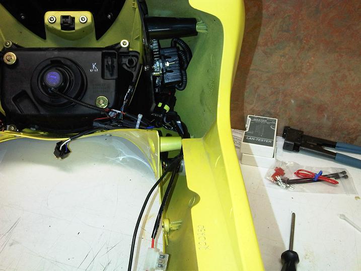

your arm twisting motivated me to take a second look. fairing removal was even easier than you describe. i am embarassed that i stated "too much work" above. see, i listen.
i undid the mirrors, bolts, and rivets. i only had to slide the fairing ahead a couple inches to make the bulb fit. i did not even have to unplug any wires. piece of cake.
i temporarily fit the bulb and wired it up. it worked very well. i hit the high beam switch and up the beam went. high, low. high, low. high, low. there is a very distinct difference between the low and high. i did that a few times and i was happy. i disconnected the temp wiring and buttoned the fairing back up.
hopefully my neighbour will help me finish the job when he gets home from out of town. i'll get him to splice in extentions so the hot lead will reach the battery. he's fussy so i hope he'll arrange the ballast, relay, and the wiring. i briefly looked inside the fairing and saw a few potential spaces to hide everything.

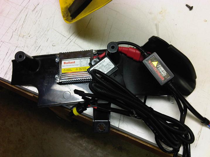

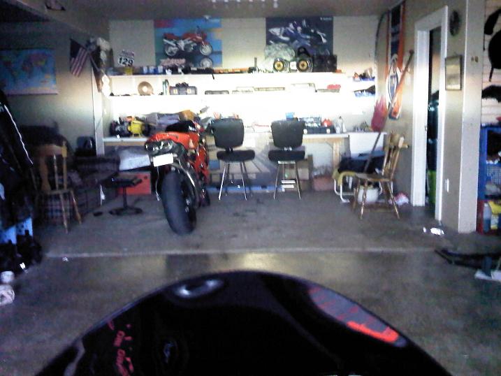

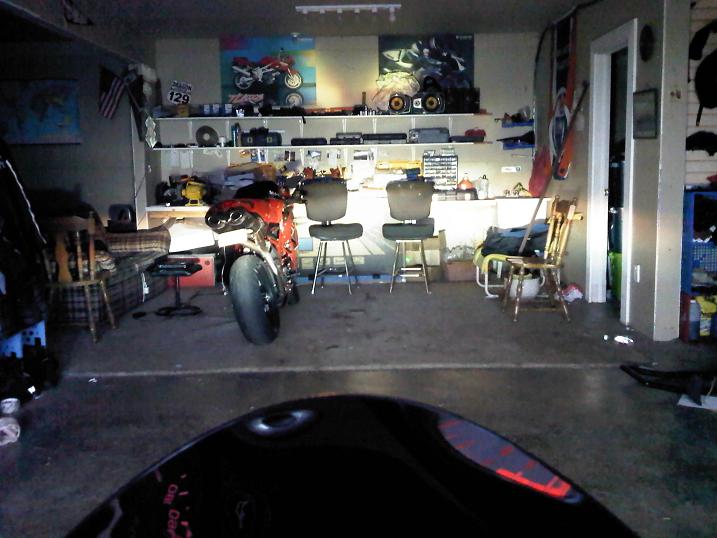

it is done. it works like a charm. i have got to say that i am impressed with how easy the install is and how well the kit works.
i mounted the ballast and relay in the fake ram air tunnelon the right side. everything fit nicely, and snug enough that it should not rattle around.
Attached Thumbnails bi-xenon lamp fitment?-img00375-20110626-2034-resize.jpg   bi-xenon lamp fitment?-img00374-20110626-2034-resize.jpg   bi-xenon lamp fitment?-img00372-20110626-2030-resize.jpg   bi-xenon lamp fitment?-img00371-20110626-2030-resize.jpg   bi-xenon lamp fitment?-img00367-20110626-1951-resize.jpg

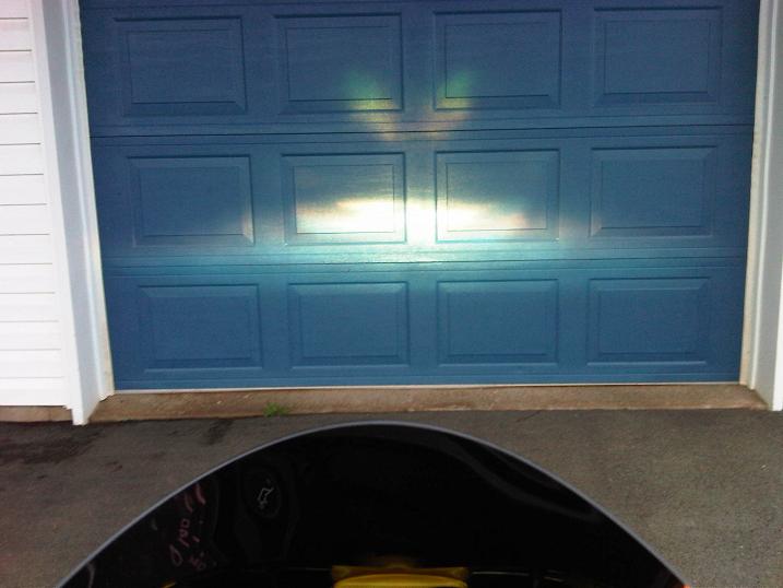

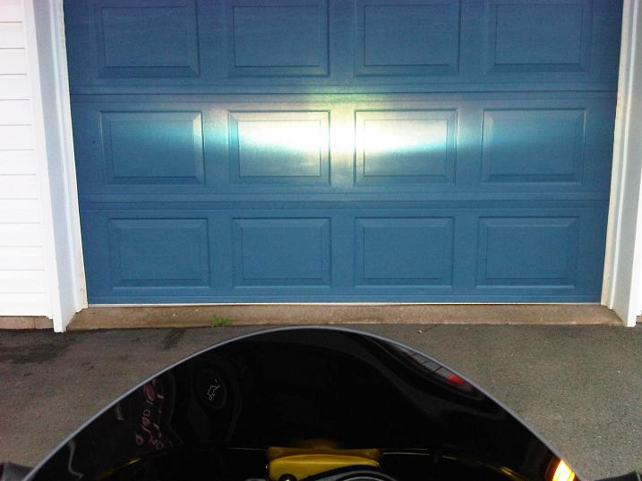

you should take a picture of it on low beam so we can see the cut off. and you are going to re aim it correctly right.

post #18, pics 2 and 4 are low beam.
i may re-aim if cars flash me at night. there may be no need to because the light source is supposed to be designed to be in the same position as the filament in the halogens. i know some of you are intent that the beam pattern is thrown off with hids in a halogen assembly but it was not with my rc51, and may not be on the hawk. one other blurring(pun) factor is that i lowered the bike for my lady, and that may have thrown the aim off. so, we'll never know for sure.

it doesnt look that bad at all,it doesnt seem to be broken up like others i have seen.
which kit did you buy off of ebay,if you have a link,post it.im curious which one this is.

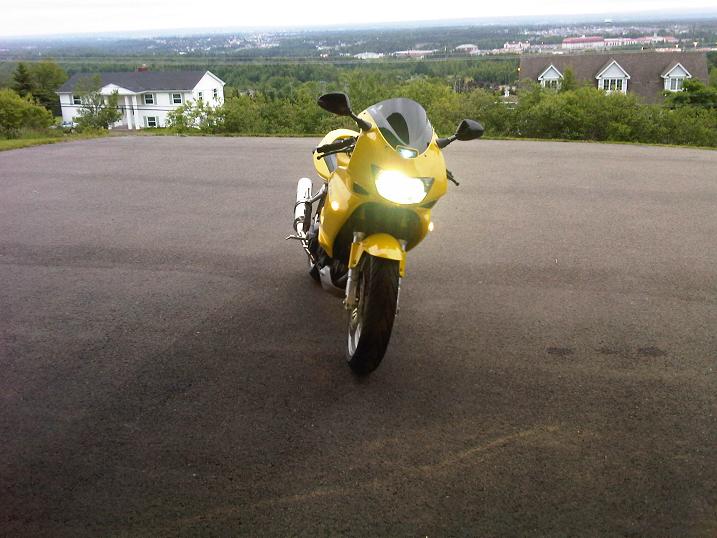

update, i pointed the housing properly. my bets are that i will not get the "turn off your high beams" flash. time will tell.
