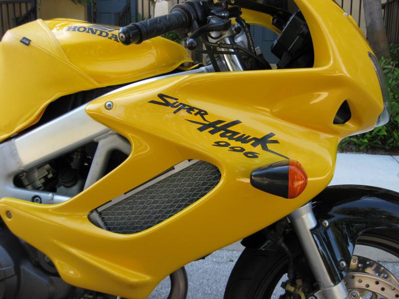

These were fixed with the permatex plastic weld. Came out real nice & the body shop did a great job matching the yellow, which I'm sure isn't the easiest color to match with the flake in it. Obviously real plastic welding is the best fix but I wouldn't have gone through all this trouble if I hadn't had success with this stuff before. Hard to tell from these small pics on here but the paint and bodywork was flawless.
