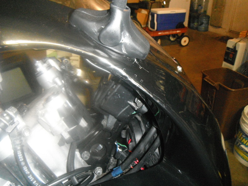

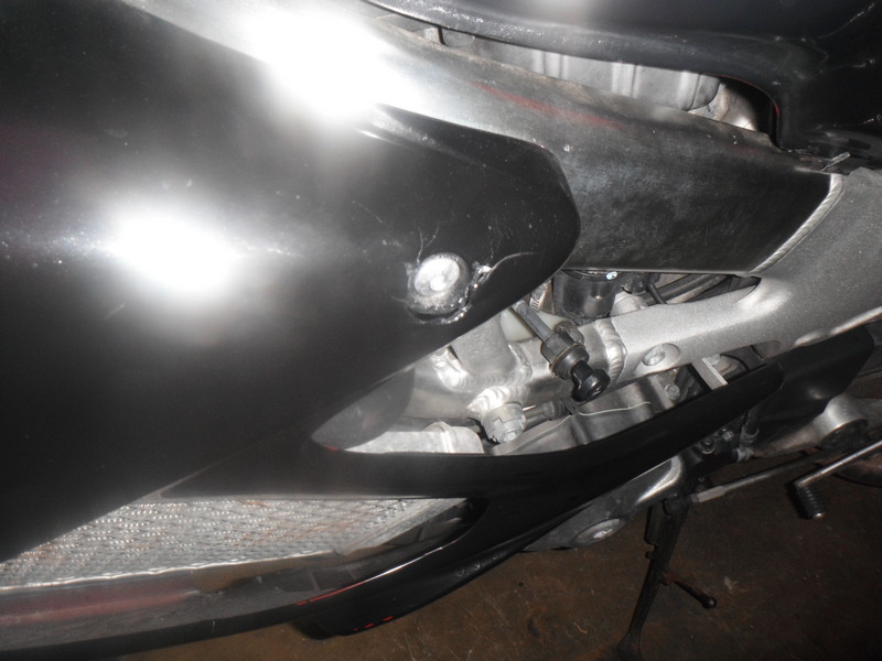

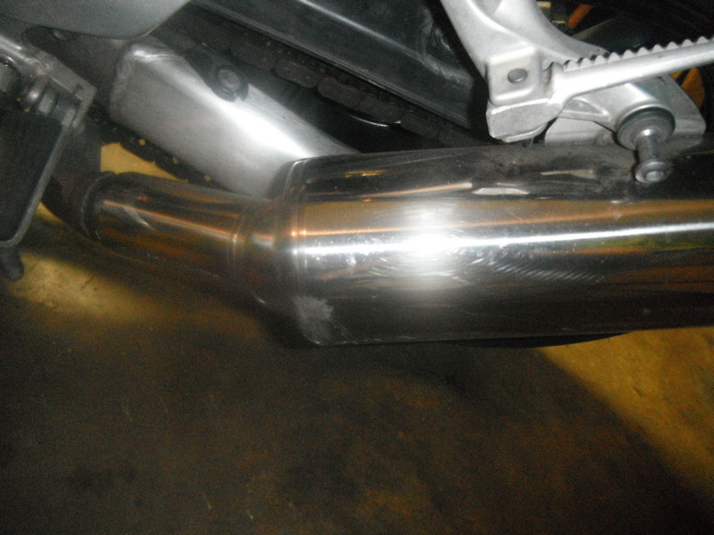

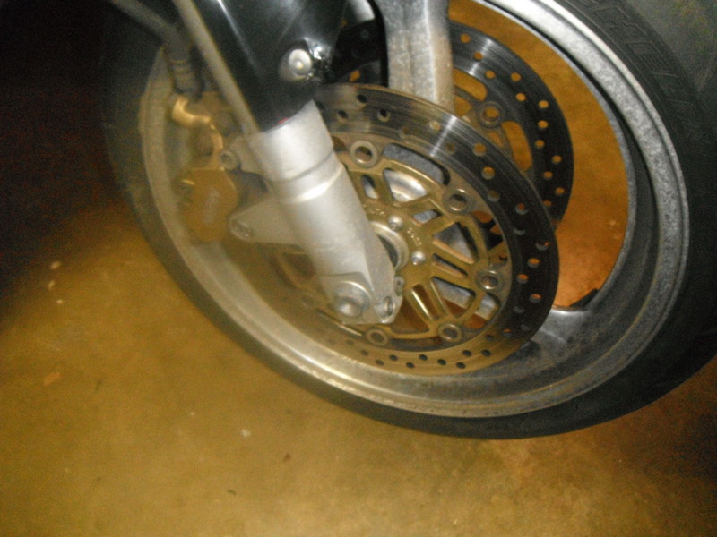

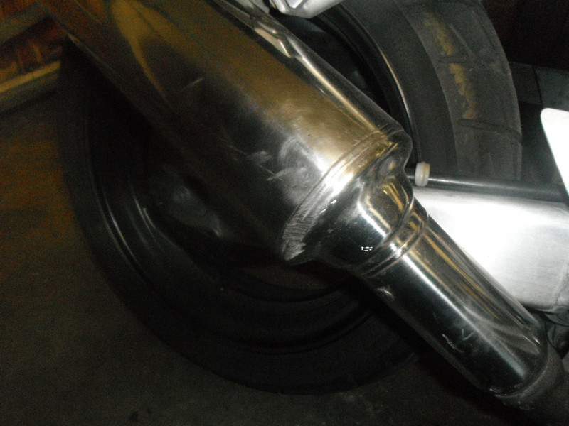

Here you go.
SuperHawk Forum - mike21091's Album: Mike21091's 1998 VTR1000

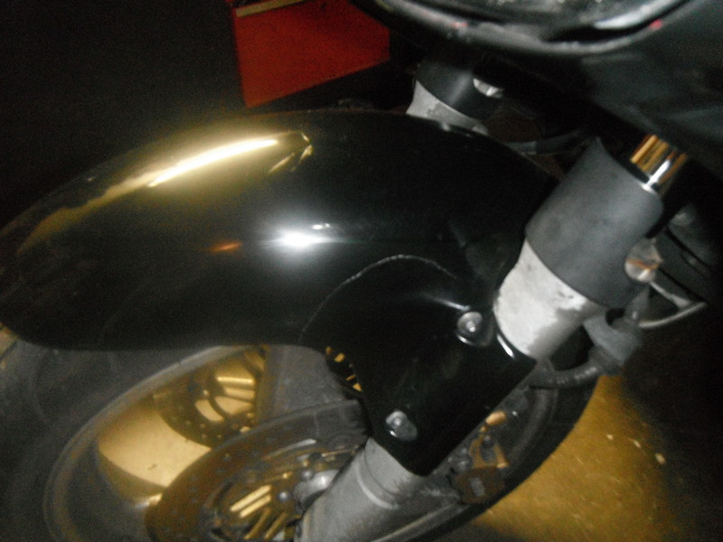

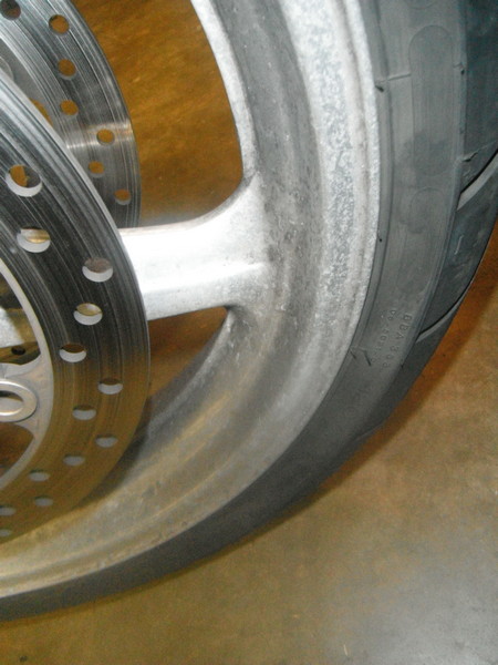

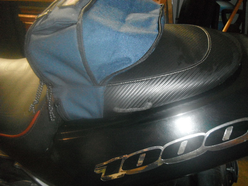

Now the flaws.
Oh and this isn't the original color, it was red originally but was repainted black which I suspected since the decals were not clear coated over and just stuck on.

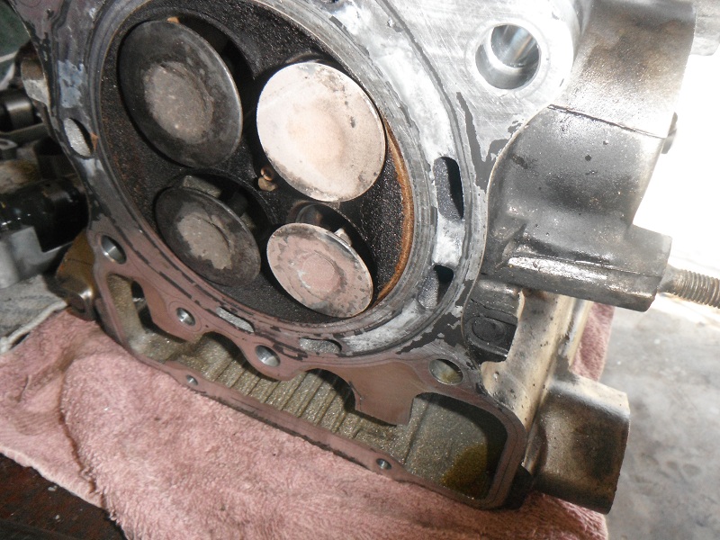

Well I installed the tensioners on the 6th and had the front tensioner assembly mounting bolts work their way loose on the 8th. So now I have a front cylinder head with bent valves due to improper torquing of bolts and/or no loctite.
Just bought a used cylinder head and will be ordering new head bolts, head gasket, valve shim kit and a new cap that goes over the stator plug cover since the previous owner mangled the internal hex on this one.

Well it's confirmed that the valves are bent.
So now the bike sits until I get the rest of my parts, valve shim kit, head gasket, among various maintenance items. I should have everything somewhere between Feb 22 and 28 and hope to be riding within the first week of March.

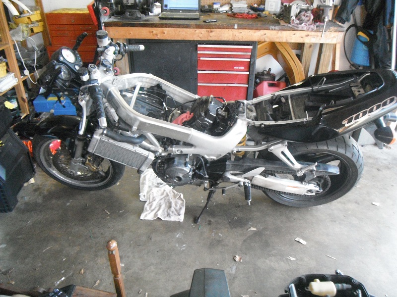

Here how it sits for now.

Ouch, that really did let go.
Loctite or gasket seal around the thread is important. This serves two purposes, first, it acts as a brake to slow the thread from unscrewing if it becomes loose. Though it shouldn't! And second, it stops any slight oil leaks that may creep along the thread. Just unscrew the tensioner all the way before applying it, so when you tighten it up it gets right in between the surfaces where the thread makes contact.
