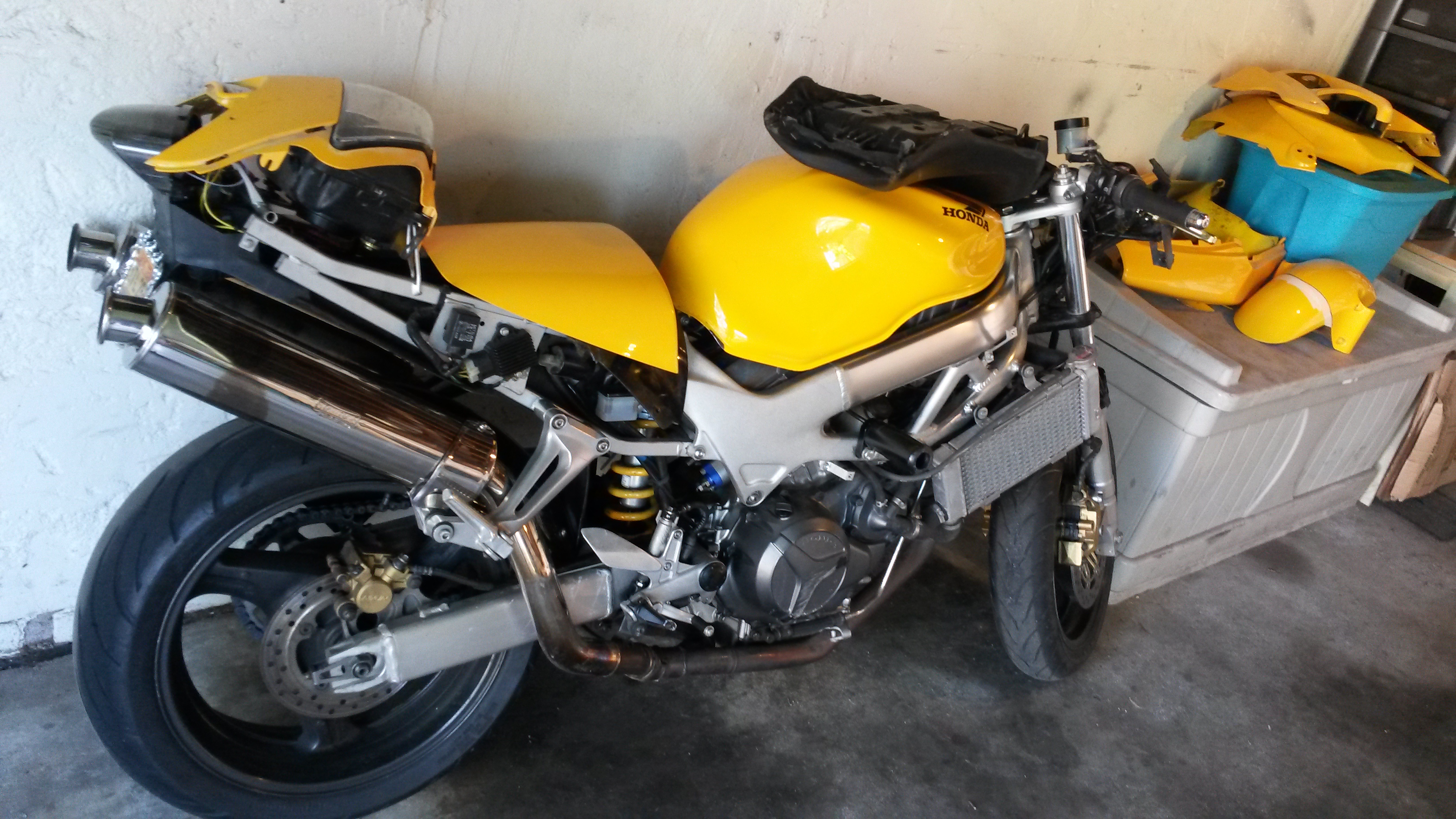

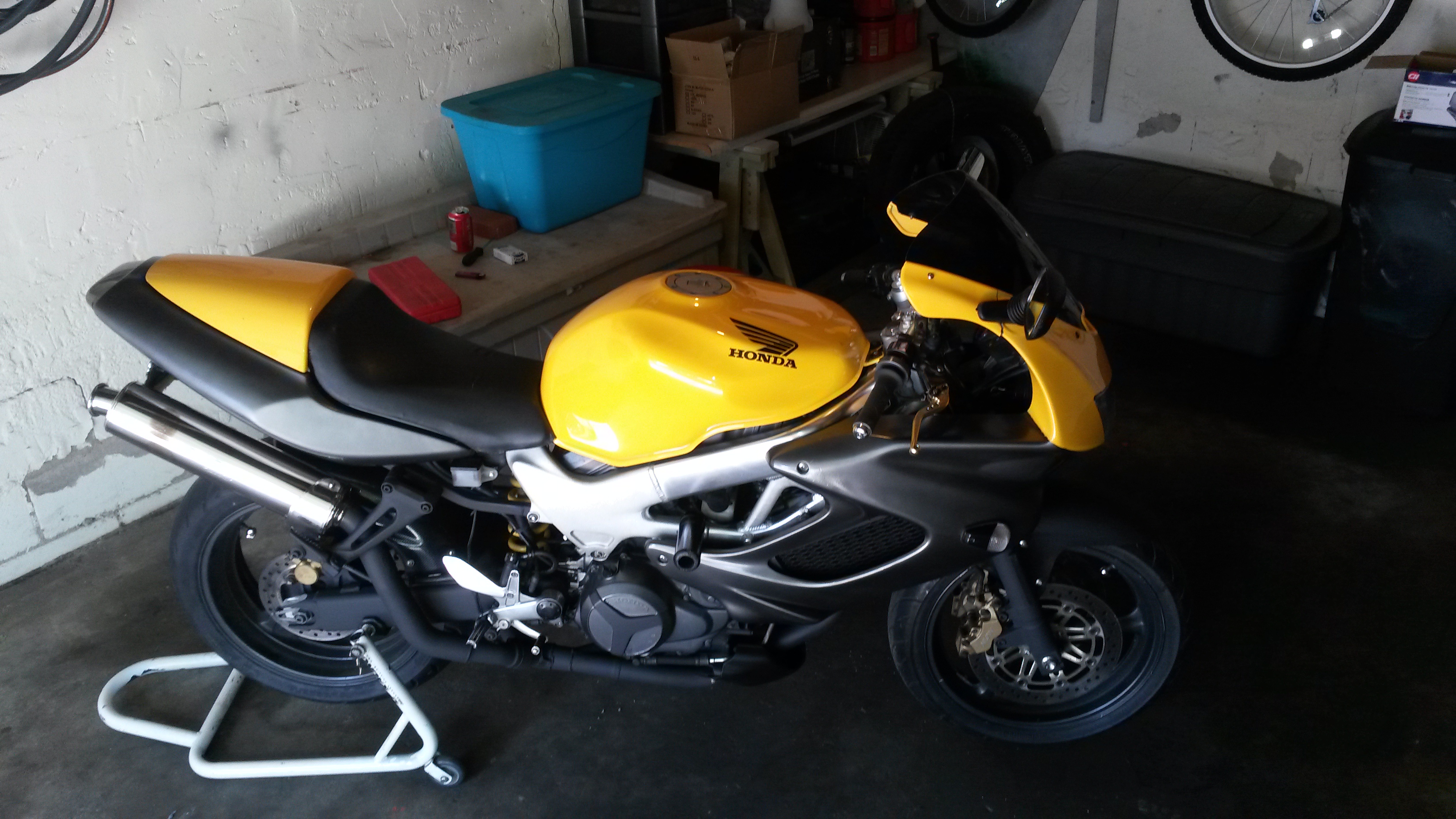

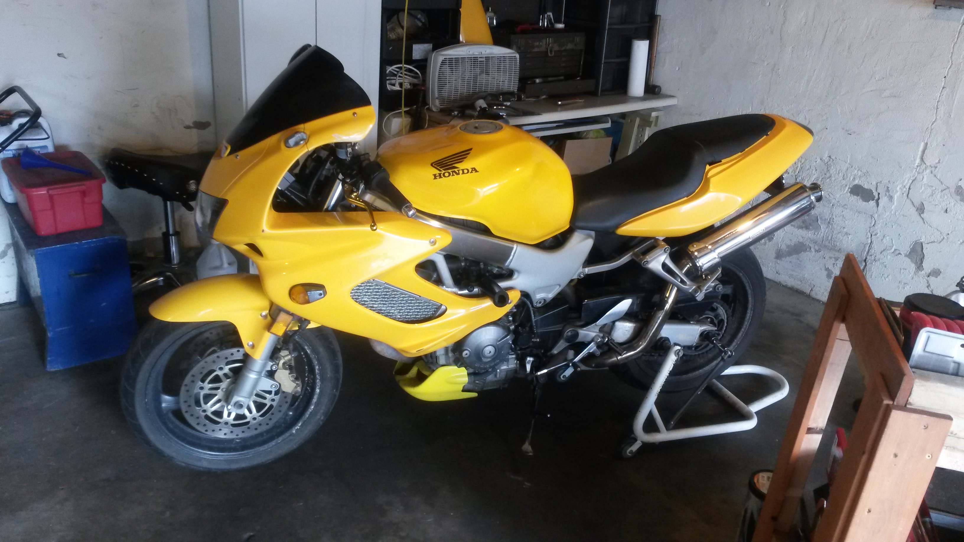

Hey Everybody, I'm Dave, I was over on another forum and met scottiemann.
He has an AWESOME VTR that I just can't get my mind away from.
My VTR came to me through a very strange path of events.

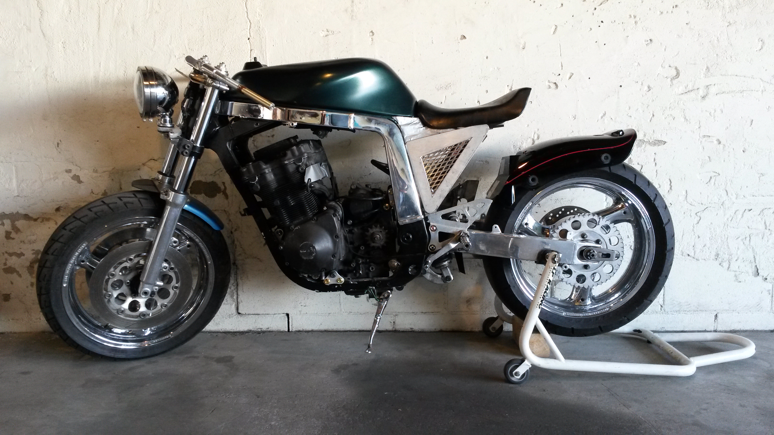

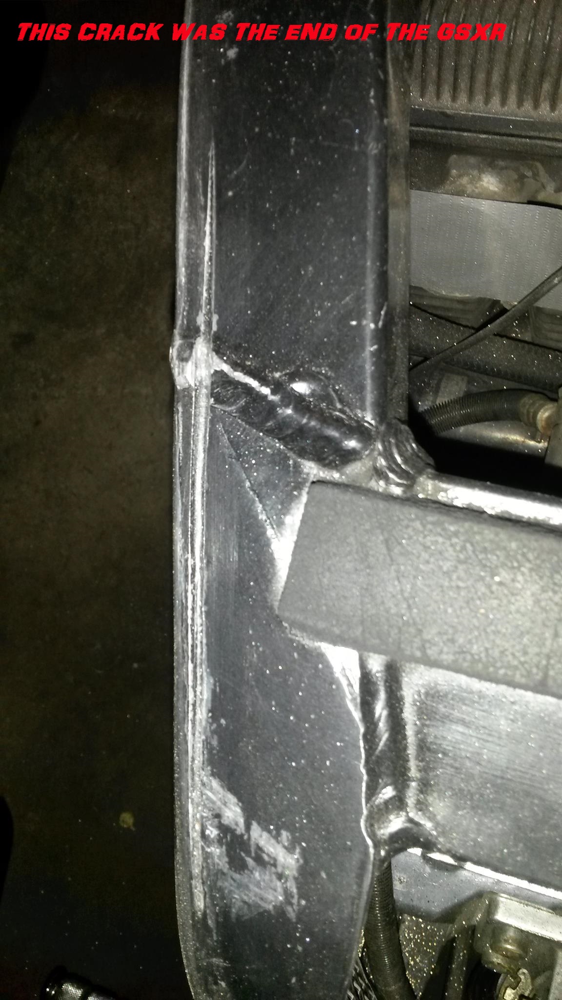

In my service days I had a GSXR, and just happened to find another, an 89 1100. A total basket case, so I bought it and went to town creating a one of a kind, "50's style, Hot Rod Bike". Now to me 50's Style means you build what you have, with what you have. It was going great until I discovered that no welder in... ANYWHERE, would fix the frame where the fuel tank had rubbed what looks like a crack through a factory weld. "Liability".
So, I decided to look around for the only other bike I would consider building, a V-Twin sport bike. Yes, my first thought was a Ducati, until I saw an article written by a guy that traded his 916 for a VTR.
I immediately thought RC51..! No luck finding one of those, BUT, I did find a yellow 1999 VTR in my own city. It was owned by a young guy that had dropped it (and his girlfriend) the previous year. I went and took a look. I ended up driving it home. The most dangerous thing I'd done in 12 years, by the time I got home, 5 miles, this poor bike had NO brakes (the rears had no pads, metal on metal, and the fronts didn't even work after the first mile).
A flat rear tire.
It was dying on me constantly because he attempted to delete the kick stand switch.
The signals didn't flash and the rear brake light switch was totally inoperative.
It had one mirror, on the right-hand side no less.
The rear sprocket was missing EVERY OTHER tooth (I saved that to show people), and the chain was fully stretched to it's MAX adjustment, and was dragging on the swing arm.
The front fairing is broken on both points at the top of the windshield, and the windshield was cracked.
I found the oil thinner than water, during the change to the best synthetic oil I could find.
He had installed MANY "LED" running lights though.
And the seat lock is, well... It's just gone.
I have fixed and repaired so much of this bike in the last month since I bought it, I don't know where I even started anymore.
But I love it, I mean, I REALLY DIG this bike man, the sound, and the TORQUE, it's just an incredible rush, hahaha.
So I'm freakin' hooked..!
What started as a $2000.oo ad became an $800.oo deal to drive home, and now an EPIC and cool build.

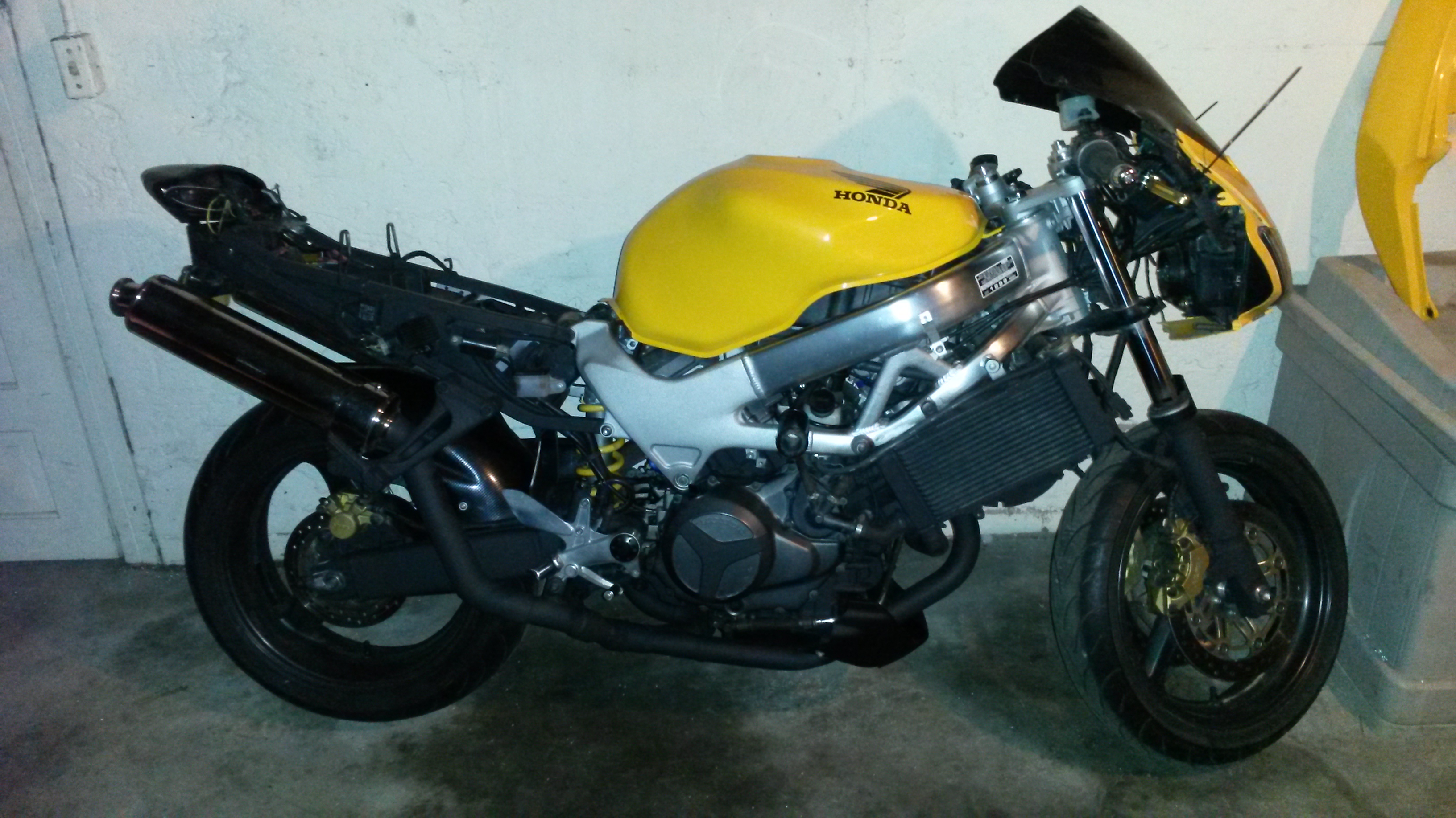

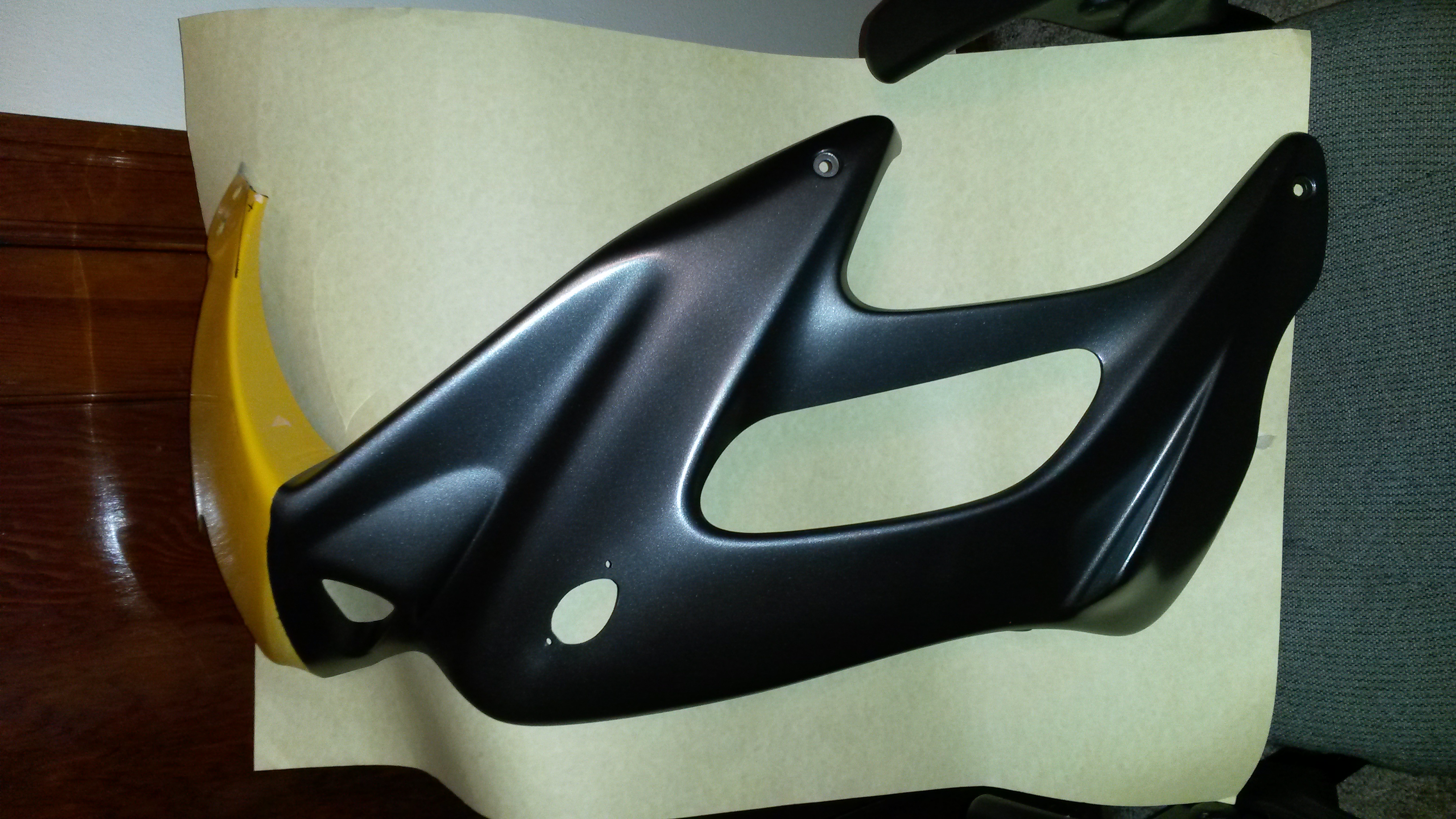

Here are a couple of more recent pictures I have.
And, no, the grey has not been clear coated yet, because she's having some "finer details" added this week by a guy who is known world wide for a few "Car-toons" he did back in the 70's...
Trust me, It's worth every minute of the wait time..!

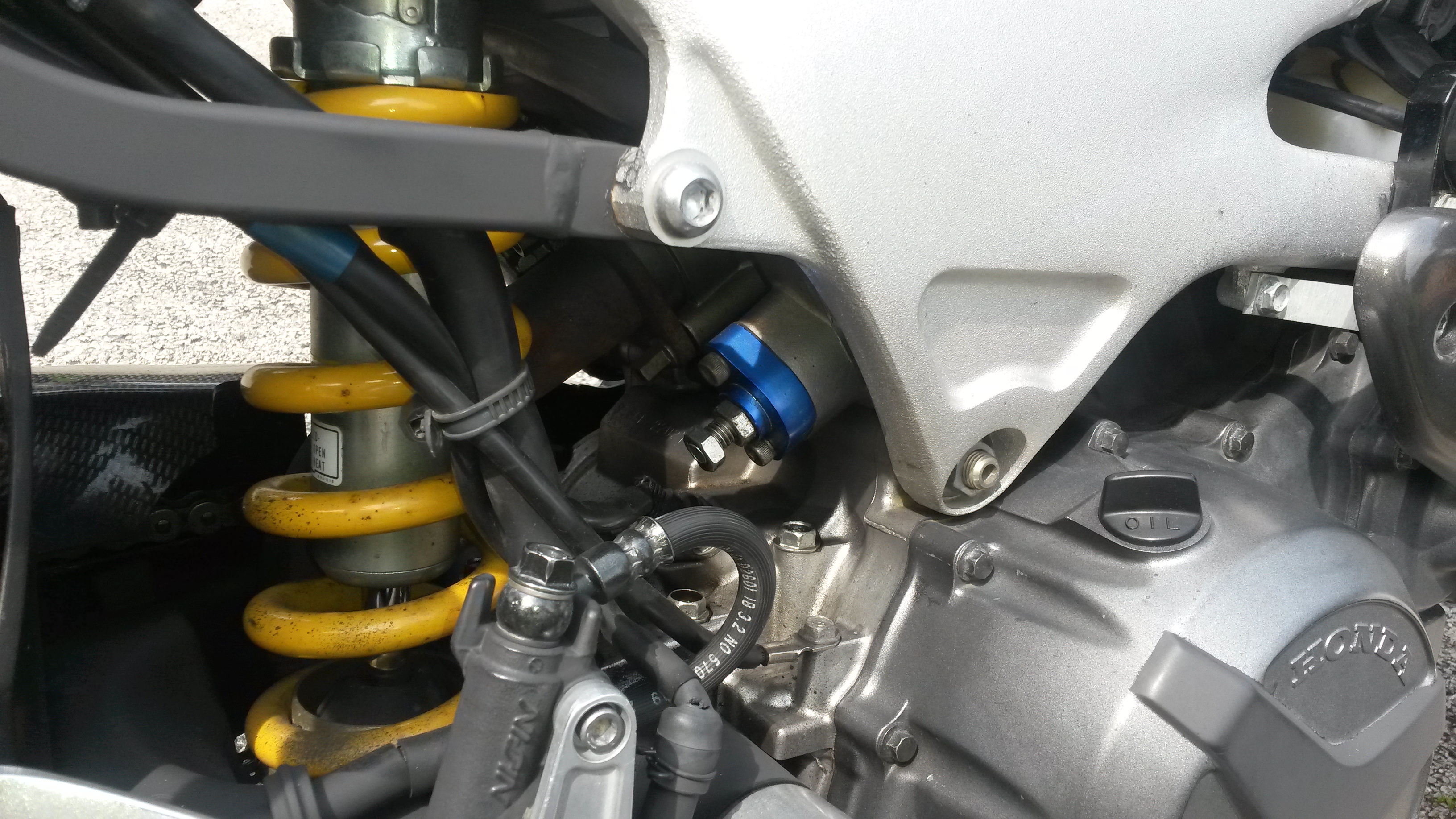

First thing, do a search for CCT and R/R those are the two most common failures on this bike and potentially catostrophic, so your going to want to replace them ASAP if it hasnt already been done...

Looks like manual CCTs have already been fitted *thumbsup*
If the R/R is like this - bin it pronto

Thanx scottiemann, Y'all are gonna' laugh, but the CCT, none of the V-twins I've worked on (Harley's, one in a Ducati frame) had them... Is it the one in my pic that's blue right..? My rear is leaking by the way...
And I haven't figured out what "R/R" is... I'll do a forum search for terms...
Yep... I'm officially a squid now aren't I..? Oh well, gotta start somewhere... LOL..!
