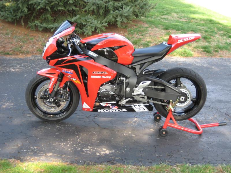

  #86
Ohio Hawk's Avatar
Joined: Feb 2005
Posts: 205
From: Cincinnati Ohio
Looks good... I'm partial to traditional Honda Racing Red and Black.

RCVTR's Avatar
Joined: Dec 2005
Posts: 1,689
Nice looking Fireblade there, Don.
If I wasn't so partial to twins, I would have gone that route.
RC51 killer, right out of the box. I like the way twins come off corners. Not that I'm a great expert getting on the gas.
