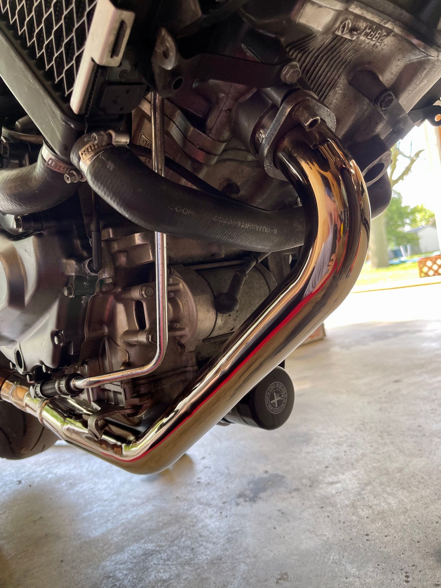

New year, new updates...got a Two Brothers Header from Captainchaos and did the finish work on it to get all the ugly baked on grime off, waiting for gaskets to install and think I’m going to put a different set of
slip-ons with it. A bit more era correct in a way...
I love my high-mounts, but the girlfriend is wanting to ride this year and I can’t bring myself to space pegs out the amount needed...
Pretty clean set of carbon Two Brothers low mount pipes I scored on EBay a while back...probably box up the High-Mounts in case I ever opt for them again and she lets me back on a solo setup haha
More to come when installed fella’s...
Exhaust looks great. Did you get the system put on yet?

Appreciate it fella's, it's definitely been a change of pace for things around here at home. Doing the best we can and making the most with what we've got though!
Lol, the process of working down the pipes really wasn't a huge undertaking. I went from 400g to 3000g, skipping/jumping a couple grits in between and wet sanding mixed in. The only uncomfortable part I'd say was sitting in the garage sweating and continuously working the pipe surfaces in some "less than ideal for public" motions we'll say, LMAO!!! I kinda feel like I have a personal relationship with the header now, hahahaha...
I went and bought a Harbor Freight 6in. Bench Buffer to do the shine-up though. It was a little tricky to work the pipe with all the angles, but came out really good I think! Certainly made the job of that easier as hand polishing sucks! I found that out super quick with doing correction on the bike's bodywork and bought a 3in. Orbital from Griot's for that too. Have them on as soon as I can!

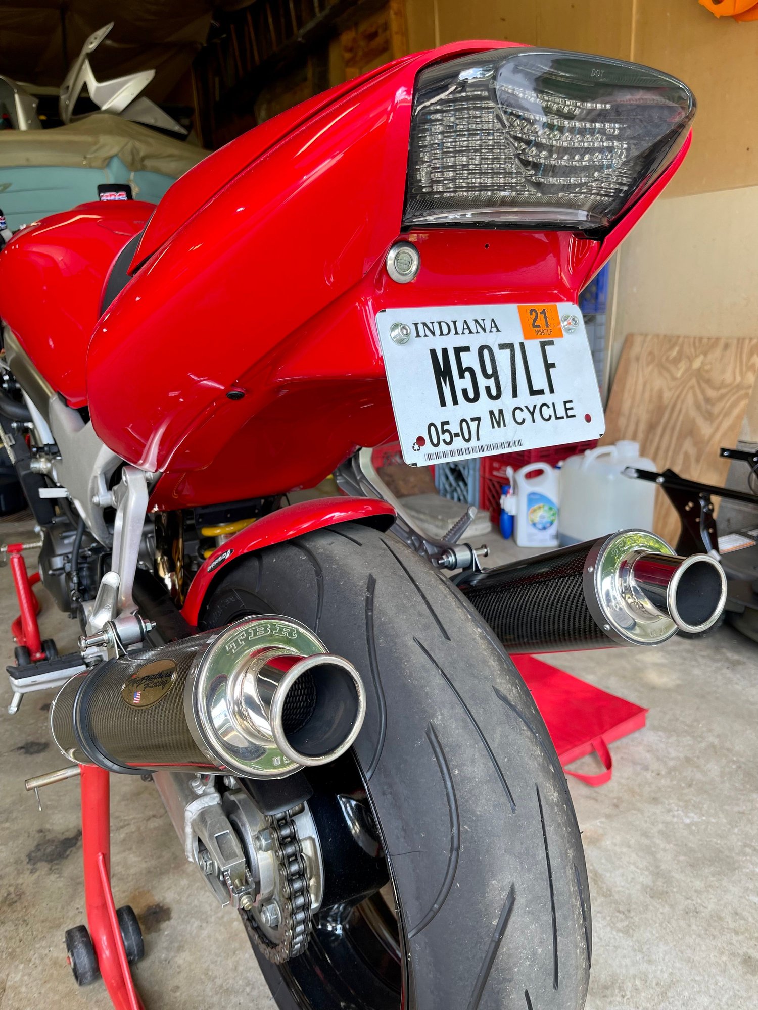

Happy Labor Day Weekend to everyone!! Hope it’s a good break and you all are enjoying the last big holiday weekend of the summer!
Finally a productive day here on my end of things 😂

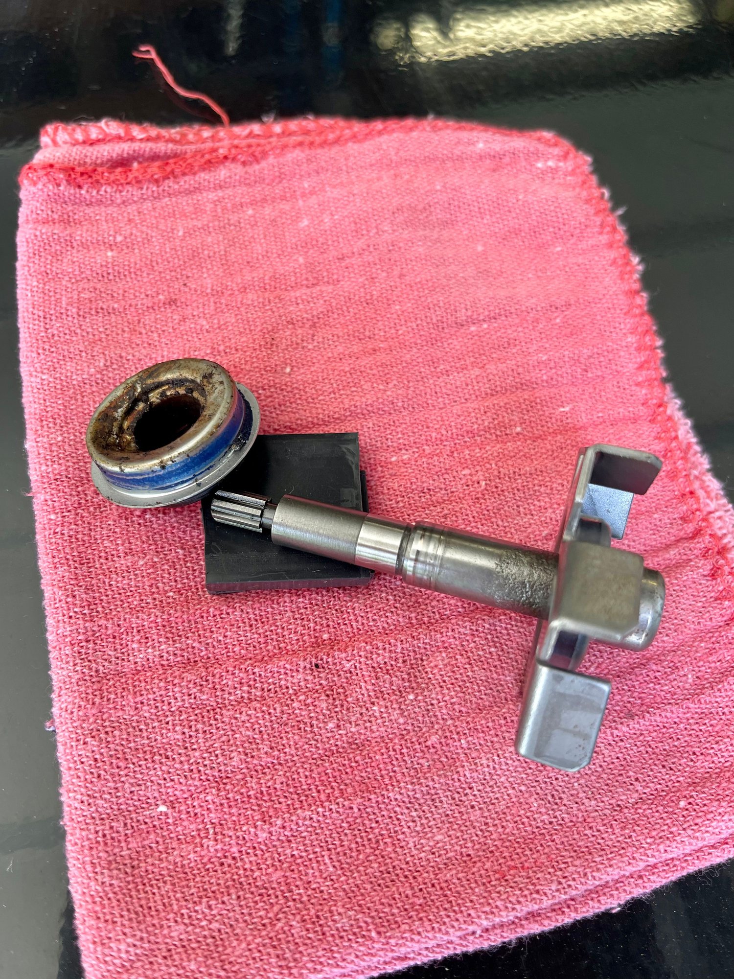

Got my water pump parts back a couple wknds ago and managed to get everything buttoned back together. Did an oil flush to ensure I wouldn’t have any gasket material sitting in the pan and got the cooling system refilled with Engine Ice.
The old impeller was pretty pitted as the shop explained…so I’m thankful for them making the call to change that!
But the big story of course is that I got my exhaust changed out FINALLY! 🤗 Wiped everything down, fired with glorious sound, and checked torque values after a heat cycle. And here she sits in her new, (more era correct) format. Header is going to golden up wonderfully I think as it already started at the heads. SO stoked there!!
I also snagged a Sargent Seat from Lajon here on the forum and got that installed with my cowl over it as well. Such a nice piece!! Thanks again for that Lajon!!
