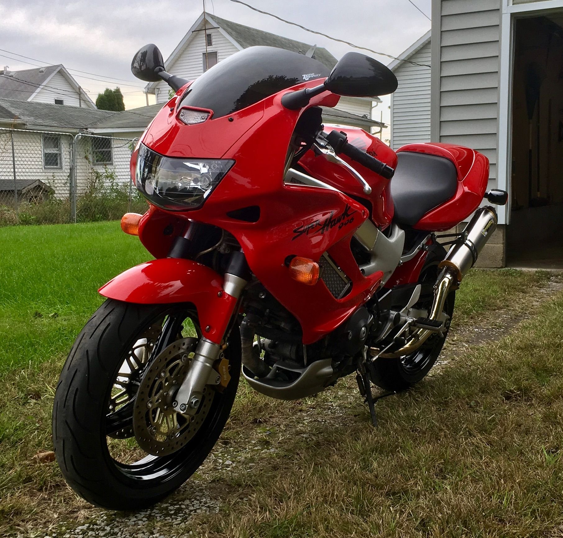

Greetings all! I’ve done a lot of searching and found a lot of info on this forum and finally decided to register. Figured my 1st post should be an introduction.
New from northern Indiana, picked up a ‘98 Superhawk about 1-1/2yrs ago after my ‘04 ZX6R was totaled in an accident on my way home from work in June of ‘17.
Bought it with some common add-ons and needing a bit of work but it’s been fun to change some parts, learn how she rides, and see the transformation take place!
Bought it with 7300 miles, Vance & Hines slip-ons, and a Zero Gravity Double-Bubble screen.
Paint wasn’t the greatest to start out but wasn’t terrible, just a good bath, some love, and a full service needed.
Got new tires and had the wheels powder coated a wet gloss black. Found a “new in box” set of Two Brothers high-mount
slip-ons on EBay and replaced the Vance & Hines pipes due to being rotted out. Added a rear seat cowl, Pyramid rear hugger, and got a standard height Dark Smoke Zero Gravity screen.
After a full bath, compound, polish, and wax she’s up to snuff and been enjoying it ever since! Had to replace the Gen 1 voltage regulator and add a battery but solid since then 9400 miles now and going up lol
Hoping to get a Pyramid lower fairing, some new signals, and I have a PowerBronze undertail waiting for install over this winter.

Welcome. She cleaned up real purdy.
Is that a stock rear shock? It looks like it 'cept it's way too shiny.

Thank you! Yeah it took a bit of elbow but I’m happy with how the paint came back to life!! Just want to maintain it the best I can now lol...my buddy had me clean his ‘88 Hawk GT before putting it away for the season lol...pretty neat to see a SuperHawk and a “Baby” Hawk together haha
As far as I know it’s a stocker lol...I’ve been kicking around the idea of having the full suspension rebuilt and set for my weight but haven’t sorted it all out just yet..

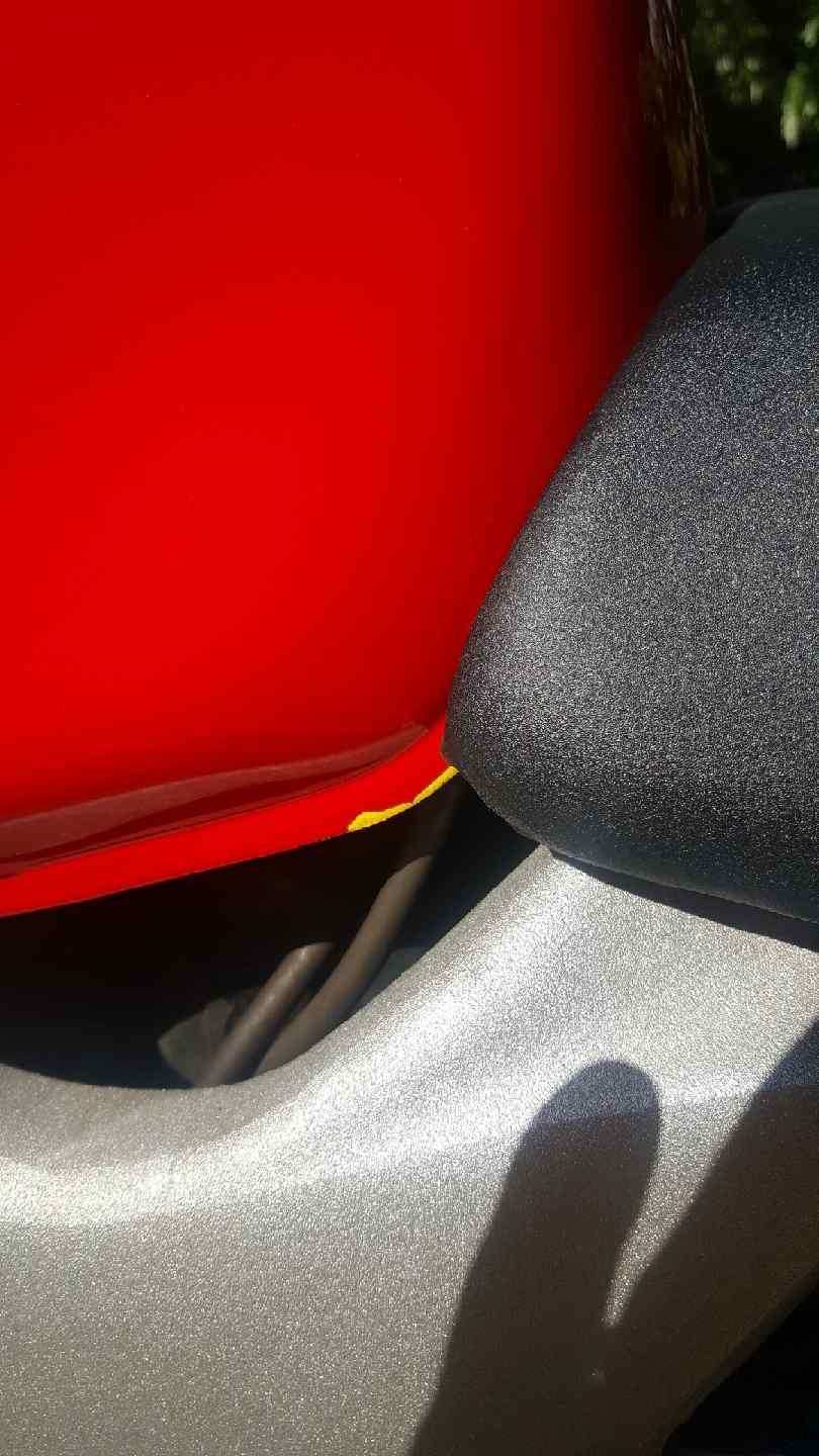

Funny as it is though, E. Marquez might be on to something as this was a blemish I had to touch up when I purchased the bike. Seems like legit proof haha

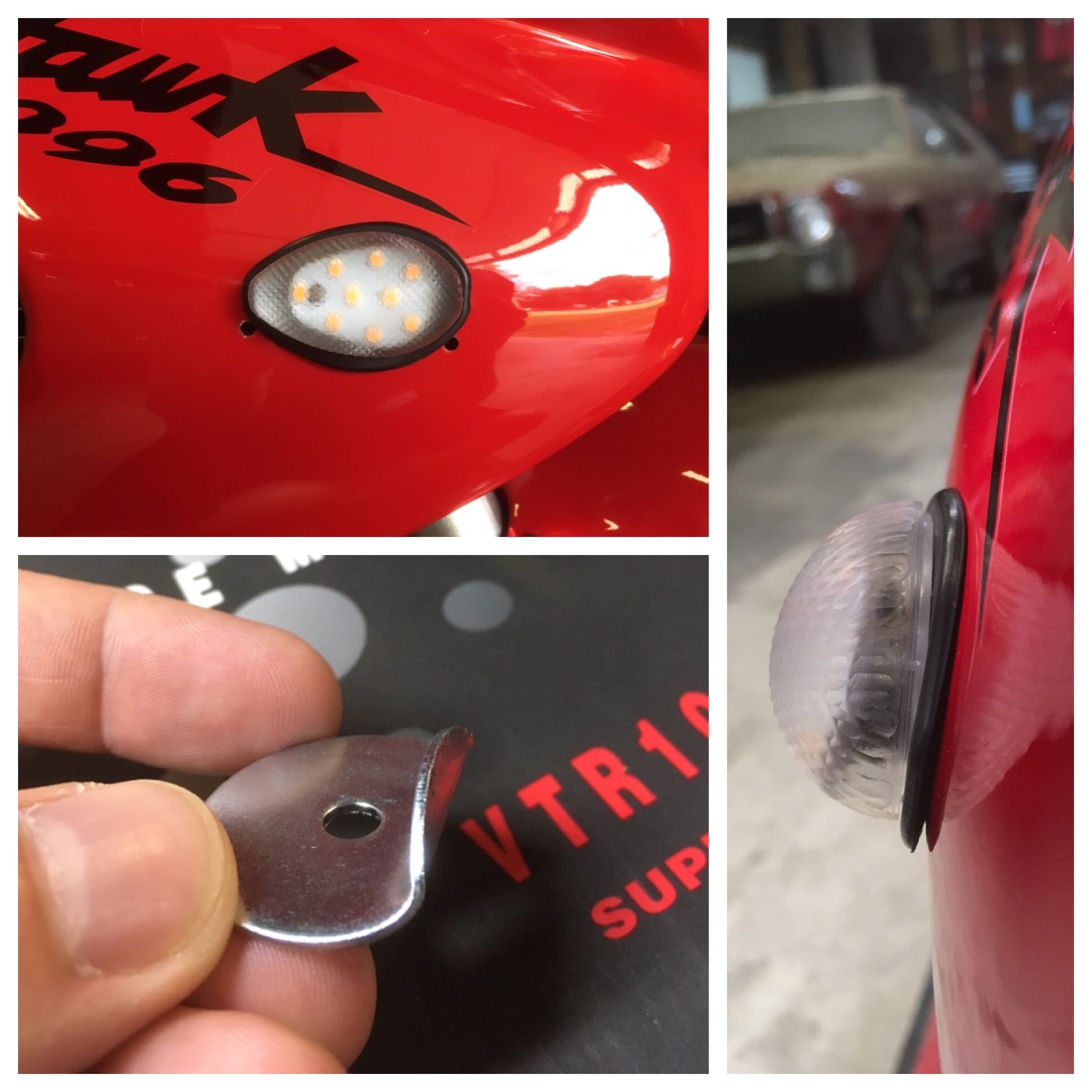

Originally had a set of smoked old-school Lockhart Phillips Flush Mount 1’s I was going to install but couldn’t find a sensible way to mount them without putting new holes in the fairings (no bueno!!!) Opted for Proton 500’s which are awesome and I should’ve done it in the 1st place lol...totally understood what the buzz is all about with them and the flashing patterns you get from placing the magnet on the signals are pretty cool too! Super bright and they fit well also!!! 😄
Nice update thanks
On the Protons ...which did you use? I don't see a listing for the VTR
Proton 500 LED Flushmount signals - Honda
Old Jul 2, 2019 | 07:37 AM
Goose86's Avatar
Joined: Oct 2018
Posts: 59
From: Huntington, IN
Goose86 is on a distinguished road
Nice update thanks
I ordered the ones for the RC51 after looking closely at RC fairing images and reading a few threads on here. They are darn near the EXACT same shape.
They fit better (more flush) without the stock rubber grommet, but they made the finished product look cheap I thought. The washers to mount them that were supplied weren’t large enough diameter I felt so I went to the local ACE and got a couple larger ones. “Fender Washers” I believe they were called there. Stuck them in the vise and bent them like the one above so they would clear the wires on the signal body. The signals come with Red, Yellow, and Black wires, each goes to their female mate on the bike. Black = Ground, Yellow = Power, and Red = Signal if I remember right. Don’t quote me there though haha...Also the Protons work perfectly with the LED tail light and the little LED relay that came with it...no seizure flashing!!!
I originally wanted a set of signals that would fill the holes a previous owner drilled in the fairings 😖😫....I was so mad when I 1st saw them
So I got to experiment with about 3 different sets of signals to cover them up lol...had the LP’s color matched when I got my undertail done as well...
Needless to say I got fed up with not getting the end result I wanted and said screw covering the holes and bought the Protons which I ultimately wanted 🤣🤦🏻*♂️🤷🏻*♂️ Guess I’ve got spares now hahaha

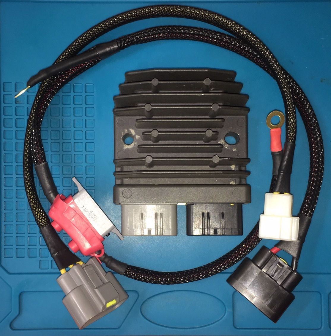

Btw E. Marquez...I have on my list of upcoming purchases to order one of your RR kits when I get the chance and extra available cash. Very nice work on those!! 👍🏻👍🏻

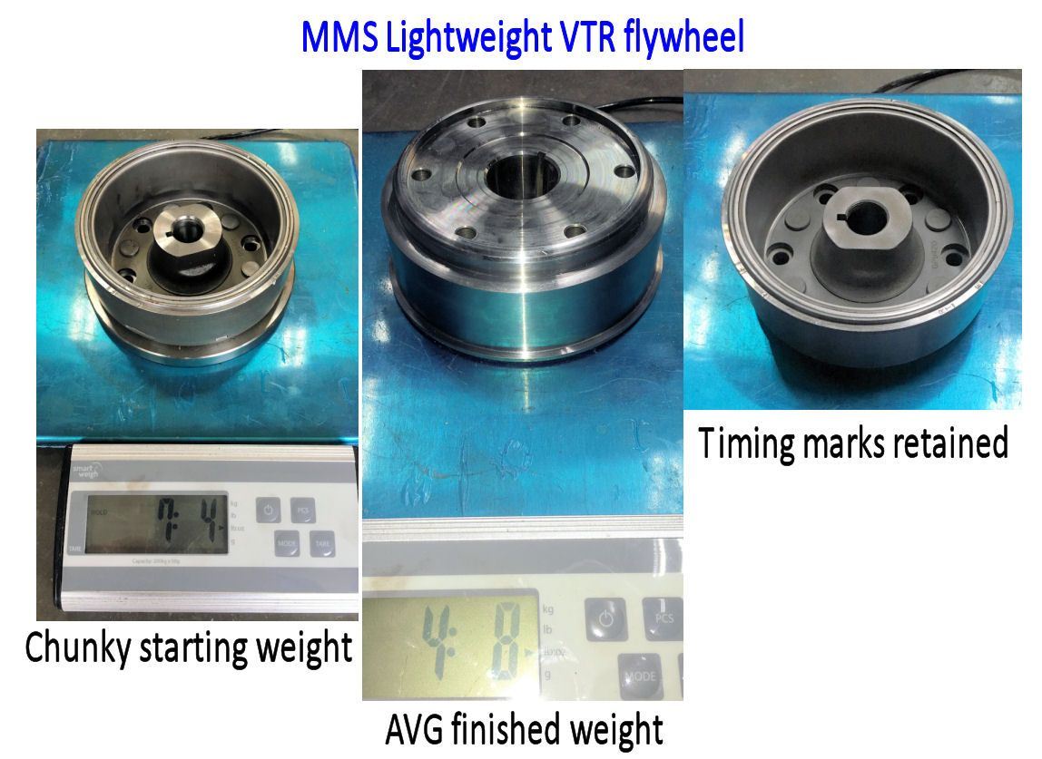

Thank you and Happy to help.
I'll have to order a set of those lights and try them out.
I only have three items for the VTR at this time, more in the works, but not ready yet.
Regulator Rectifier kit
COP Kit
Flywheel lightening service.
Shoot me an email at marquezmotorcycleservices@gmail.com when your ready
