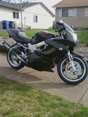

New to the forum and just wanted to say hi. I just picked up this beauty for $3K last Sunday, and I am in love. If anybody is riding in the Portland, Or. area let me know.

I see you have stock CCT's, as alot will point out I would suggest looking at replacing them as a preventative measure

Not really....... while some people have had problems others (like myself) have put thousands of miles on the stock units with no issues. I am close to 80k miles on my bike and have replaced the stock ones one time at 50k miles (yeah I should have done it a little sooner but what can I say) and you do need to replace the automatic units as a wear item.
The big thing is don't let the bike sit and idle on the side stand. If you have to do it or just like to let the bike run like that, throw in some manual units.
As you have bought it used, you might want to have someone check the bike over for you and you might want to change them for piece of mind but the whole thing is blown a bit out of proportion IMHO
how can you tell from the pic?
Old Mar 2, 2010 | 07:54 AM
the gray think poking out of the back of the engine is the CCT. It's not gray or shaped like that if it is aftermarket.

While I may agree that there is a bit of panic regarding the longevity of the CCT's I still replaced mine with manual units. It is a cheap bit of insurance that they will not fail. Like frame sliders if you never crash then you don't need them, but when you do and don't have them think of all the damage that can be prevented by having them.
Believe me there is a known issue with the car that I drive that you may develop crank walk, while this issue is something that can happen to any engine there seems to be a higher amount of my engine generation developing this. If there was a simple bolt on preventative measure that I could install myself I would install it without thinking twice.

You can tell when the stock ones go bad cuz the bike will sound like something is rattling. Its a muffled rattle that either goes away or gets louder when you rev it. Its the chain dragging across something in your motor. Best thing to do at that point is turn your bike off.

This is true but the only downside is telling a new SH owner to listen for noises is kind of hard as these bikes rattle and clank when they are running great.
Old Mar 2, 2010 | 11:12 AM
The problem with the CCTs is no one knows when they will fail. There is no gradual warning. You might get a 1/2 second sound before the valves meet the pistons, but that's about it.
We have stories of failures from as little as 1500 miles and as many as 55,000 miles.. Either way it didn't end well.
