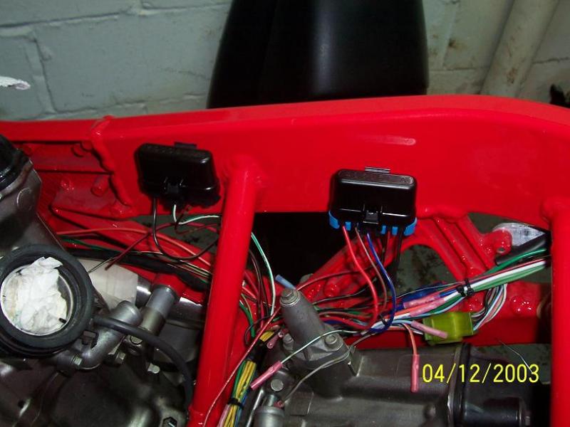

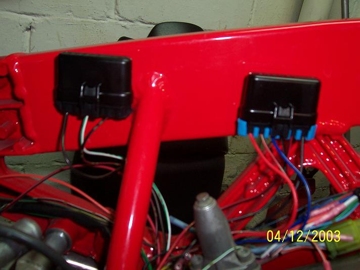

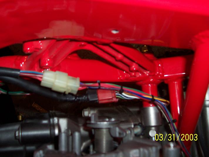

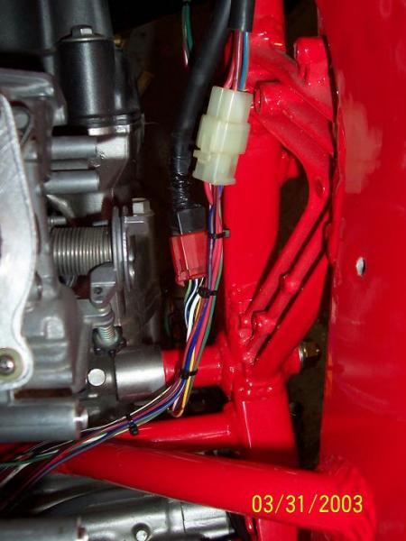

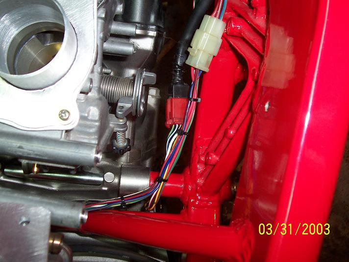

well ive gotten started on harness.
will put up some pics later.
Attached Thumbnails modding madness!-me-048.jpg   modding madness!-me-045.jpg   modding madness!-me-047.jpg   modding madness!-me-043.jpg

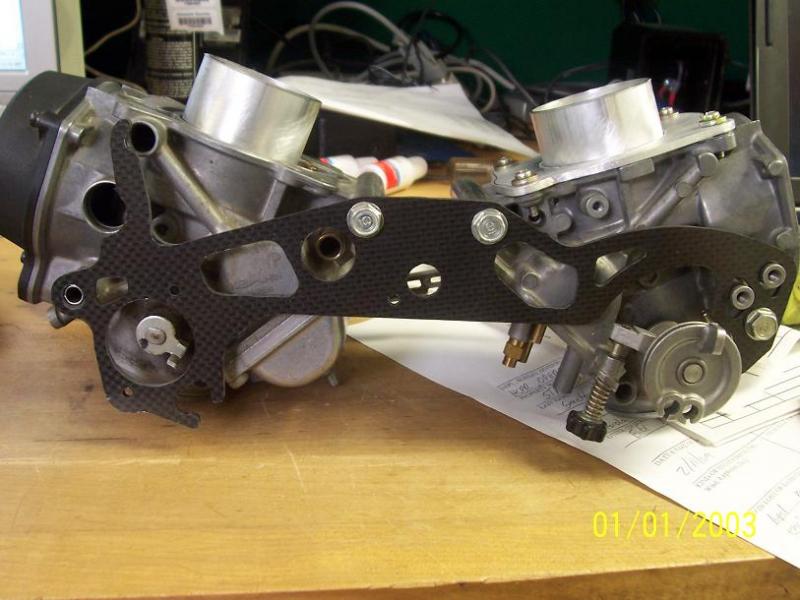

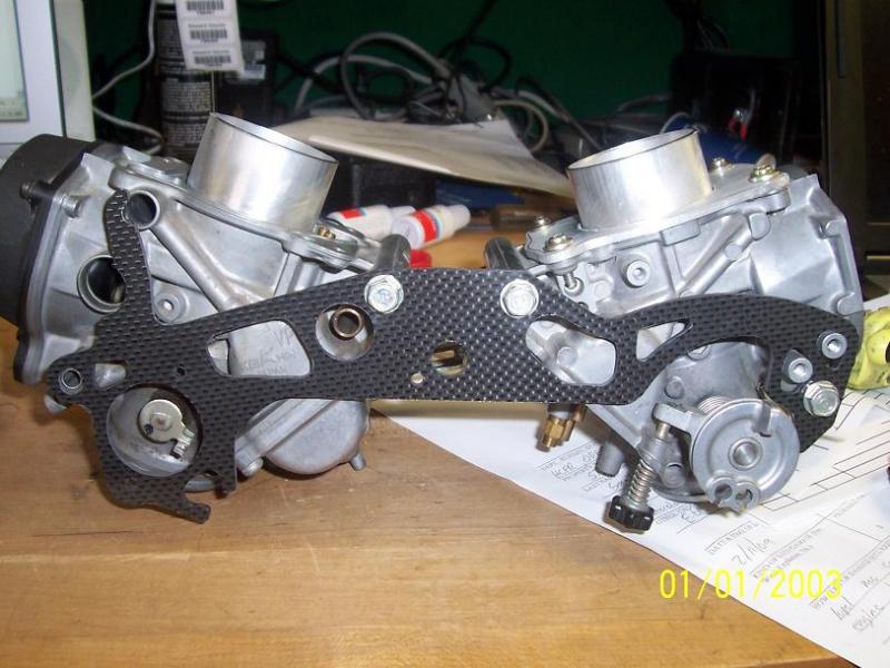

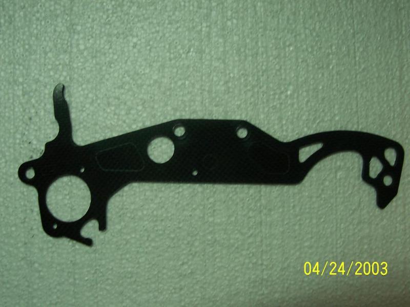

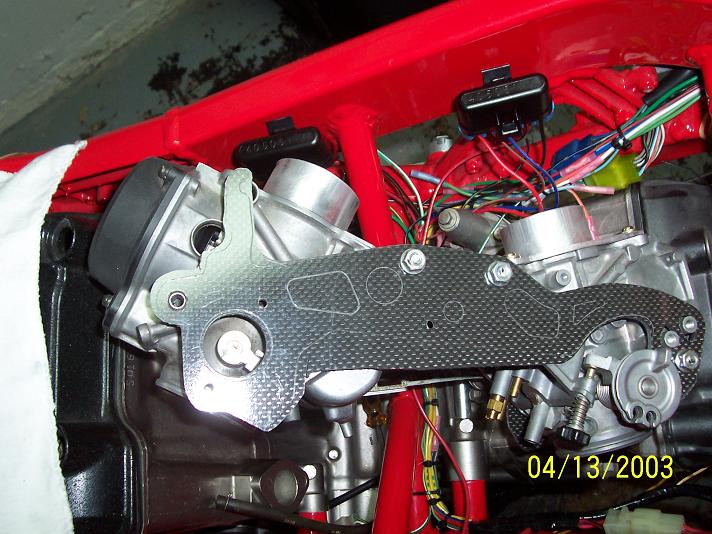

small carb mod update
Attached Thumbnails modding madness!-100_0797.jpg   modding madness!-100_0804.jpg

I dig the carbon carb mod. I think Ill do that to mine.
Man, that is sweet. What made you think of doing that? It think it turned out really nice, it's those little touches that make all of the difference on a build like this.

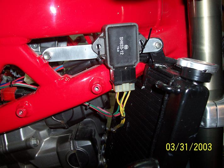

jamie, im surprised. "you know what would go great with this bike? a new shift lever" haha. if you posted this earlier and i didnt see it then im a dumbass and ignore me.

i do like where you put the r/r though. thats a good idea.
i use to race r/c electric cars.
and i remembered how stiff the carbon chassis were.
that was my inspiration for this.
i used carbide burs to cut lightening holes and drum sanders to shape.
it is a very rigid assembly.
yeah i thought hard about it.
ay 1st was gonna mount it near battery.
then i decided out in the breeze would be best.

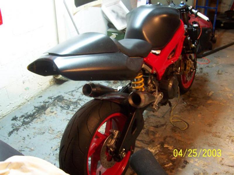

experimental maggots!

I like the position of the cans, Will the exhaust tubing have clearance?
they are right now hanging off rearsets.
was just seeing how they look on the bike.
this is the easiest option,using stock header.

From: my house

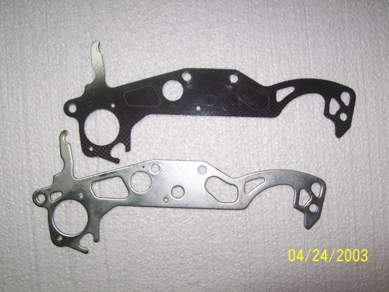

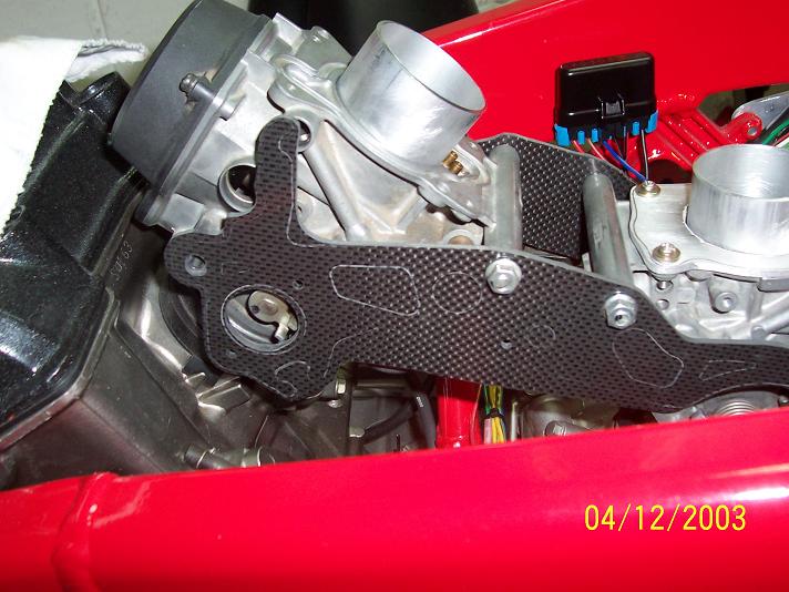

finished carbon carb. plates
Attached Thumbnails modding madness!-100_0810.jpg   modding madness!-100_0811.jpg
Old Feb 17, 2009 | 06:08 PM
  #168
Nice job. any idea on the weight saved?

From: my house
at least half if not more.
havent weighed them,want to replace stock bolts with ti also
oooooooo

not much progress but i do have lights and horn now.
just need to do coils and gauges to complete electrics.
i have already checked the starter circuit,it was nice to hear that engine crank.

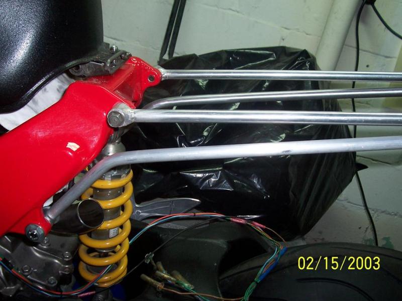

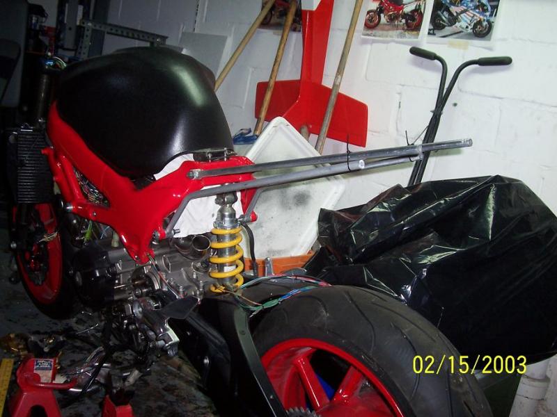

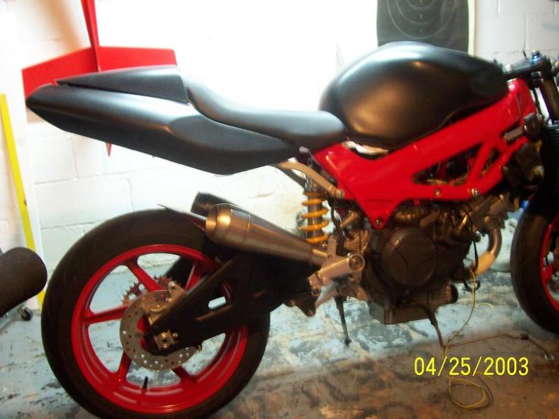

start of subframe.
going to use honda rs125 tail.
Attached Thumbnails modding madness!-subframe.jpg   modding madness!-subframe2.jpg

hey hey now subframe looks good. You gonna gusset the rails since they are so close?
yes i sure will have more to do once i get tail unit

I don't know if I missed it or not but where did you get the carbon fibre for the carbs?
Malice
I bought the material which is 1/8 thick at McMaster-Carr.
