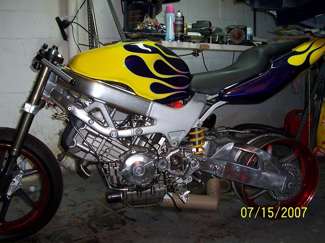

modding madness!
my ? in progress

Wow. That's just freaking cool looking.
Old Oct 31, 2007 | 04:32 PM
gboezio's Avatar
Joined: Dec 2006
Posts: 880
Wow, two thumbs up, love the underseat rad, the flames, the wheels, the long swing arm.
Nice work

actually thats an underseat exhaust pipe for rear cylinder.
going to try a cbr600rr rad. in front.
front cyl. exhaust will wrap up above stator assembly.
its going to be 2 into 2.

I noticed it looks like you cut, flipped and rewelded the bottom rail of your subframe... Reasons why??? I'm guessing to make room for the exhaust? Highly interested as my new project will use a modified 2007 GSXR rear tail (I love the look)... so I'll be modding subframe as well... any suggestions?

i modded the subframe that way because visually it opens up that area.
gives a lighter look.

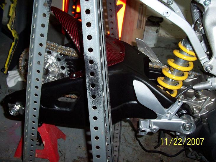

well took swingarm to powdercoaters.
as soon as ordered parts come in ,i can
start on initial assembly.
1st part being getting radiator mounted.
then bracing frame and powdercoating it.
need to do wheels also.
swingarm is going to be a textured black
with a red dyed kevlar carbon weave 600rr
hugger.
will post pics once started.

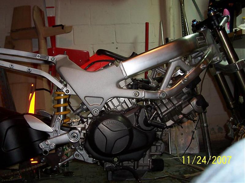

swingarm is rc51 sp2.
it mounts as per stock but you need to mod shock mount.
see pics and you will get the idea.
you also need to fab linkage plates.
im sorry pics are in other post"other swingarms"

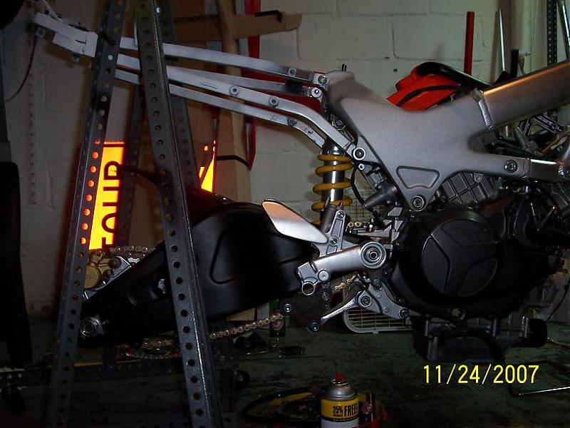

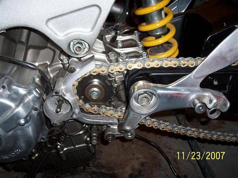

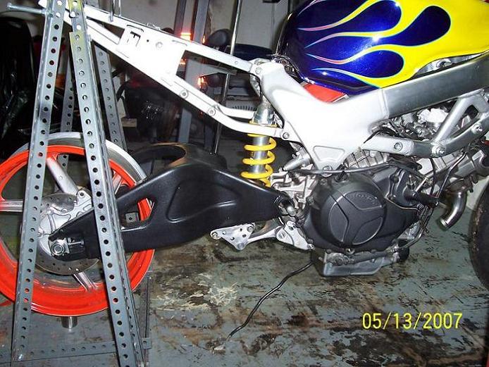

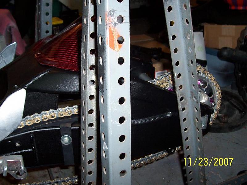

well got swingarm powdercoated,installed new bearings and spacers.
everything lined up perfect.
now i need a chain tool.
Attached Thumbnails modding madness!-powderchain.jpg   modding madness!-powdercoat.jpg   modding madness!-nicky-mod.jpg
Old Nov 24, 2007 | 06:57 PM
superhawk22's Avatar
Posts: 3,844
From: Gainesville FLA.
You can get a chain tool at CycleGear or any other parts place, if you do go to CG request the RK chain tool and NOT the MotionPro. They're the same price but the RK one is much stronger. Looks good BTW can't wait for you to ride it and tell me what effect the longer swing arm has on the handling.

thanks for the heads up on the chain tool.
i imagine it would put more weight on the front end.
should cure it running wide under power.
Old Nov 24, 2007 | 07:09 PM
Posts: 3,844
No problem, I was thinking with the shorter forks the swing arm might bring it back to where it was before.

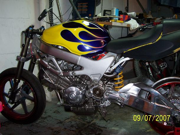

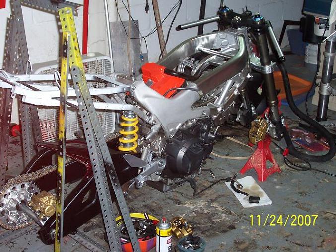

more pics.
Attached Thumbnails modding madness!-profile.jpg   modding madness!-overall.jpg   modding madness!-assembly.jpg

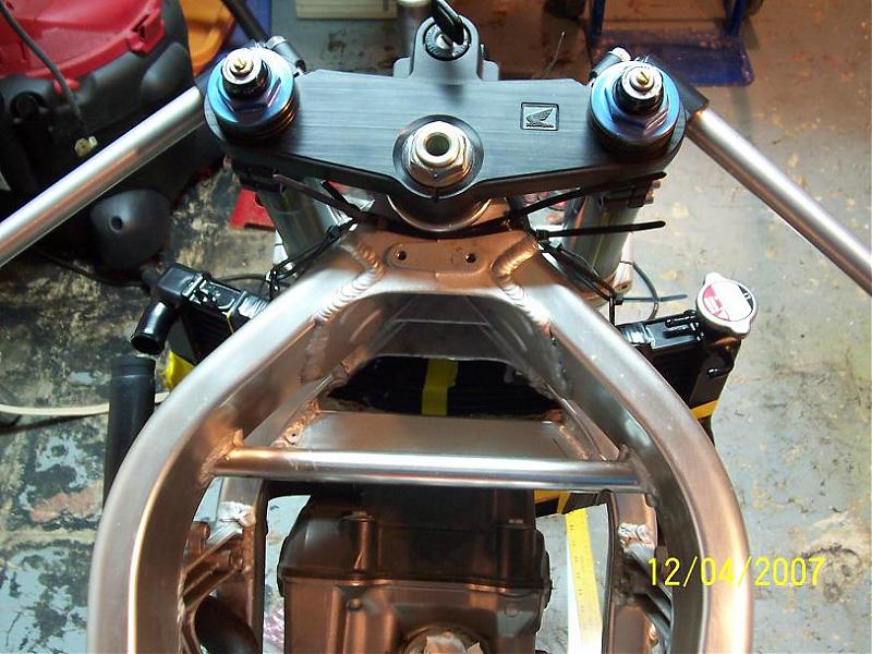

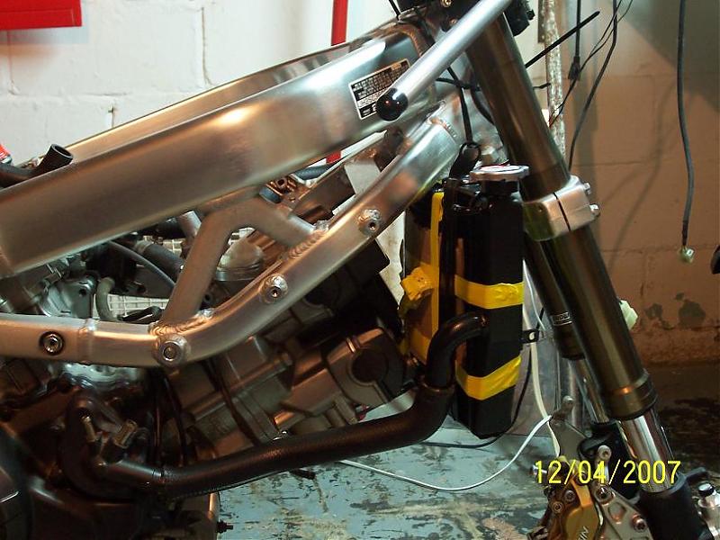

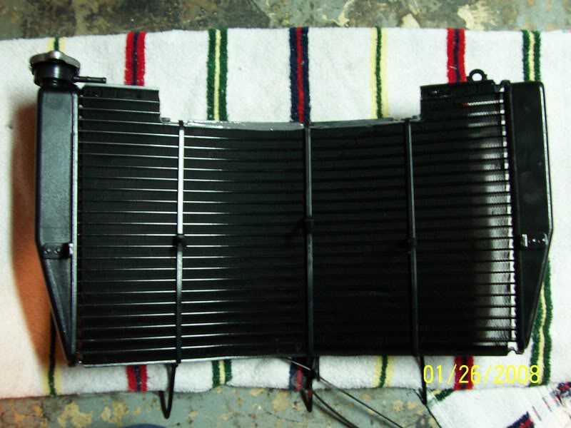

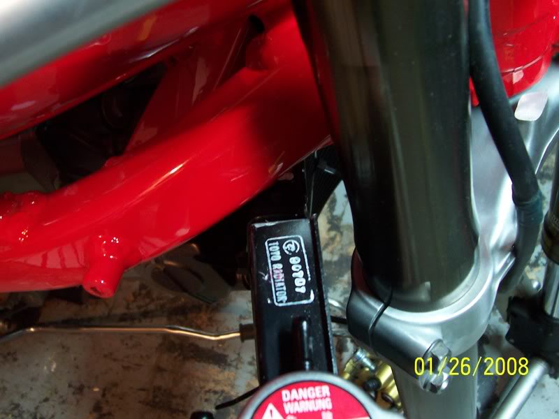

here is the start of rad. work.
on the radiator i need to notch out the center top.
and have a radiator shop close it back up.
the reason for this is to pull it up higher to
clear the front wheel.
also have to mod the mounts to clear fork tubes.
Attached Thumbnails modding madness!-rad-fitup.jpg   modding madness!-fit-2.jpg

Old Dec 6, 2007 | 09:53 AM
SlowHAWK's Avatar
Joined: Jun 2004
Posts: 818
From: Thornwood, NY
Whats your bar/turning radius clearence gonna be like with that thing? I know the RC front end cuts it down to begin with... looks like that rad will make it even worse... I guess if your track only, you'll be fine...
J.
Old Dec 6, 2007 | 11:24 AM
hawxter996's Avatar
ole dirty bastard
Posts: 976
From: my house
actually with the hose gone from under triples i have full turn radius.

thanks all!
once i get the rad.mounted i will have full turn radius.
the fork tubes will hit the frame. i need to work on
steering stops also.
im gonna add a couple diagonal braces to the frame
also.figure with stiffer forks and swingarm im gonna need them.

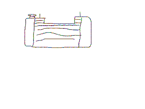

Originally Posted by SlowHAWK
You must post up pics of how you finish up the rads as you move along...
J.
this is a very rough sketch of what i am doing to rad.
basically notching out the center to raise it up higher
for front wheel clearance.

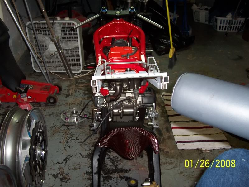

Old Jan 27, 2008 | 04:51 PM
hawxter996's Avatar
ole dirty bastard
Posts: 976
From: my house

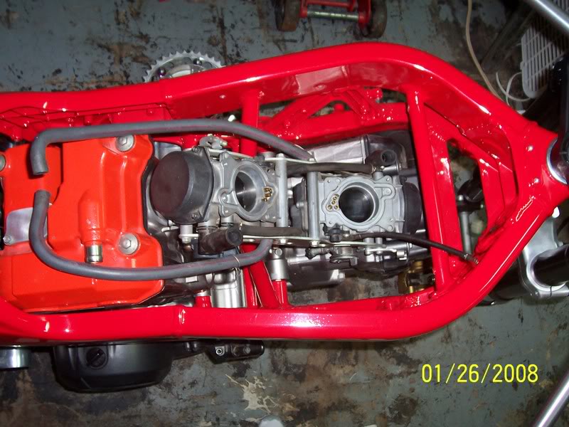

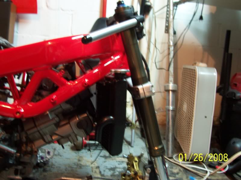

frame came back from powdercoater.
couldnt wait to test fit radiator.
just need to fab some brackets and finish sealing the rad.
waiting to coat the wheels and engine covers next.

How did you seal the radiator after cutting away the top section?
