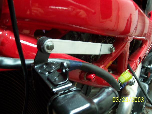

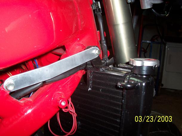

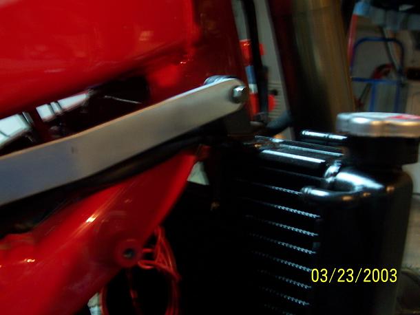

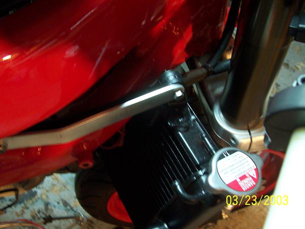

here are pics of latest rad mods.
almost finished this.
need to finish lower mount.
Attached Thumbnails modding madness!-2.jpg   modding madness!-3.jpg   modding madness!-4.jpg   modding madness!-5.jpg
