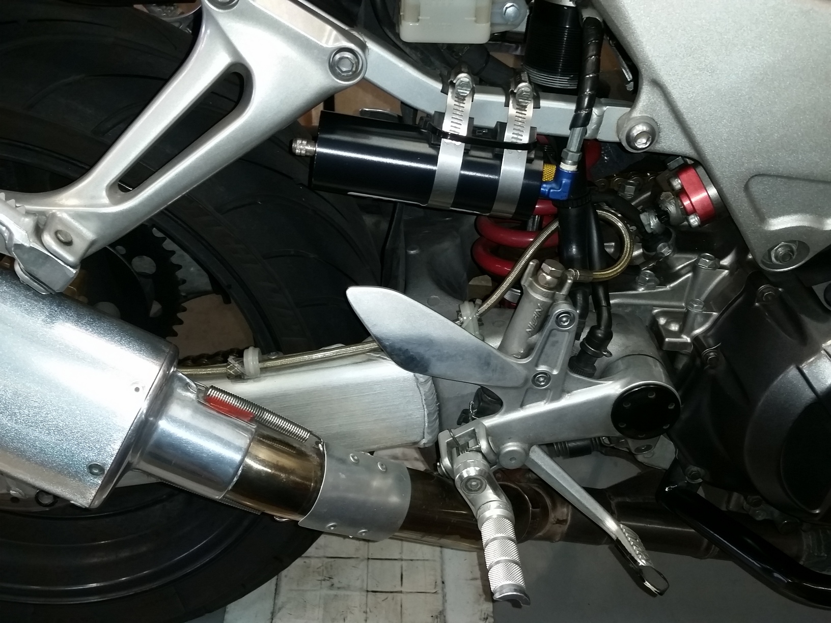

I am not religious about turning on the Scott Oiler because technically an O-ring chain only needs oil to keep from rusting, and I mix my own oil that IMO is as good or better than the pricey Scott oil (Synthetic chain saw bar oil and Marval Mystery Oil to thin and add color). And as I said, I ride in the rain a fair amount.

On my VTR I lowered the pegs 1-inch and moved them forward .75-inches. I also now have installed the DanMoto 3-D clip-ons (after using the Helibars for years, and then the Tommaselli 3-axis clip-ons), which I have set about 3.5-inches higher and 2.25-inches rearward. The 3-Ds are also 2-inches overall wider and I have them set with 10 degrees more sweep than OEM. Plus I modified my Sargent saddle with memory foam so it is 1-inch higher and I also angled up the front more, along with carving in my patented "Tush Pan" and "Ball Pocket". Believe me at almost 62, I know about pain! However, if I keep up with the Ibuprofen I can manage 10+ hours in the saddle and/or 500 mile days whichever is lesser. I also built a 1.25 gallon larger tank for my VTR bu with my prostate and bladder issues I never use it because the stock tanks range of 120 miles or so is more than enough before I need a pit stop, if not sooner.

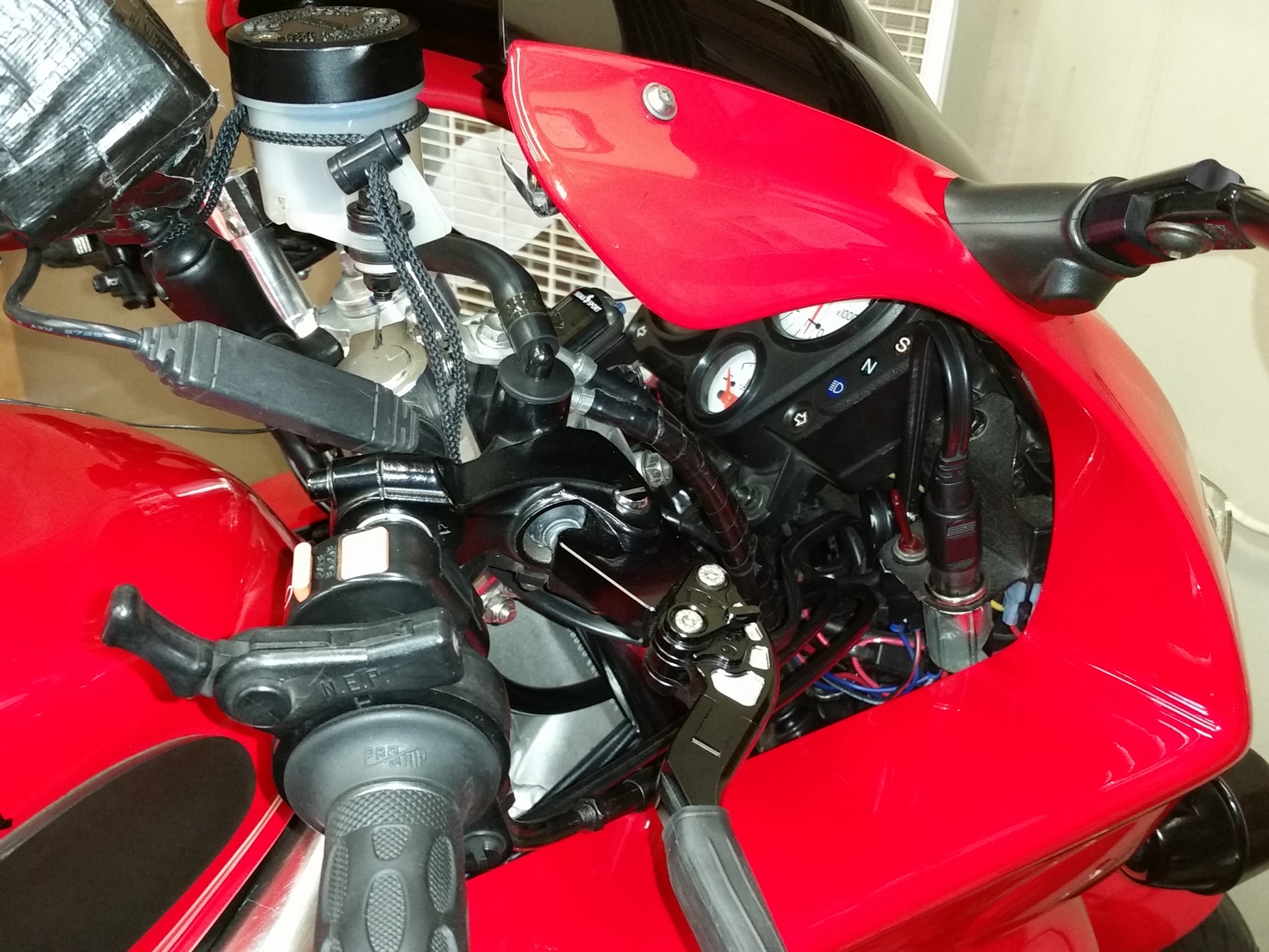

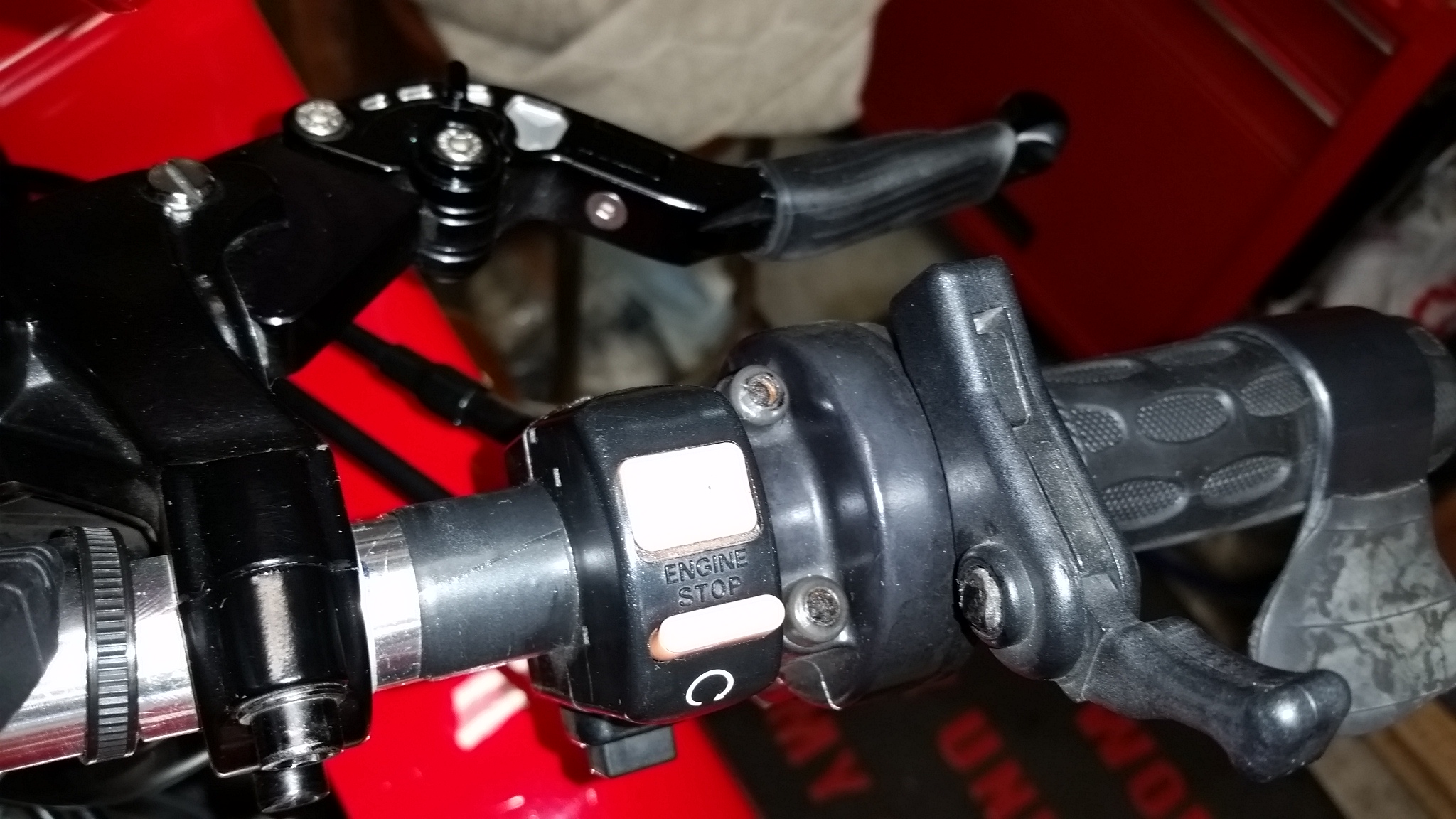

I drilled and tapped a hole (1/8" or maybe 3/16", can't remember as I did it a decade ago for the Tommasellis) and threaded in a hex drive set screw on both sides of the frame in the middle of where the triple-tree stops contact to slightly limit lock-to-lock travel. Yes, tight low speed and U-turns are wider but it ensures no bar-tank contact. I have everything adjusted so the bars just touch the fairing at full lock but not enough to move it or rub off the paint; and this was without trimming the fairing.
Here are some better pics of the ergonomic mods I've made.

I'm digging the duct tape IFR hood on the what looks like a GPS.
Clean bike, but much too complex for my brain.
What type/brand of bars in the photos?
Old Aug 5, 2016 | 10:27 AM
Posts: 2,219
Originally Posted by xeris
I'm digging the duct tape IFR hood on the what looks like a GPS. A PLASTIC HOOD WITH SOME DUCT TAPE AND IT IS A GARMIN NUVI 765T GPS (FANTASTIC AND UNIQUE UNIT)
Clean bike, but much too complex for my brain. YOU DON'T KNOW HOW REALLY COMPLEX IT IS WITH OVER 75 MODIFICATIONS, MANY OF WHICH ARE HIDDEN FROM READY VIEW AND/OR ARE INTERNAL.
SEE POST #6
