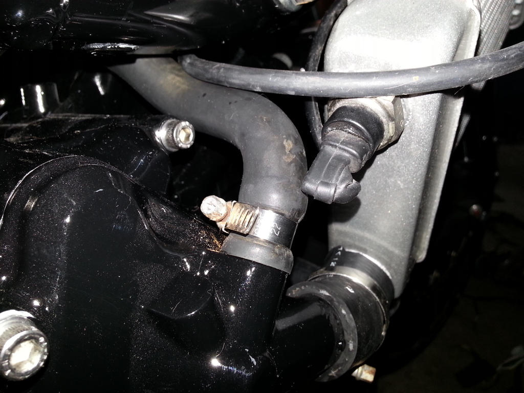

Originally Posted by CruxGNZ
I tried mounting my Ohlins resevoir, but the line is at the wrong angle. I'm assuming that since this shock is under pressure, I can't loosen that banjo fitting and swivel it 90 degrees, then tighten it. So, I temporarily zip tied the resevoir to the sub frame. The place that rebuilt and dyno'd this Ohlins shock is 45 minutes from me. I hope I can ride there, move that fitting, and then have them recharge the shock. I sure hope they can recharge the shock while on the bike. What a hassle.
FWIW, keep an eye on the hose as I had to replace mine recently, the kink developed a leak over time.

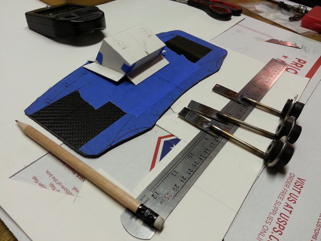

Dash #2
I will keep editing this post with pictures of the new dash. Same design as the last one, but a little better and all done in brushed stainless steel.
I decided to give the new dash a little thickness to it. So, I cut some metal 5/8" wide to weld along the edge. Should look nice when it is finished.
