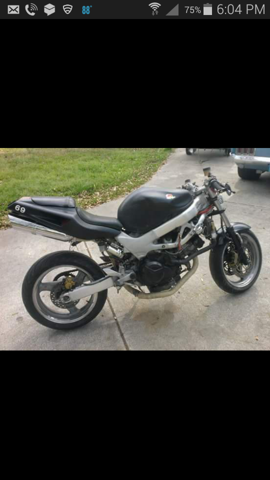

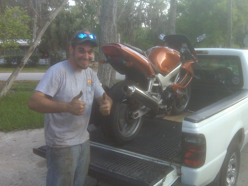

ive been away for a while and recently decided to tear into the bike and go street fighter.
this is from the first day i brought it home
rode it around like that for a while until i let my buddy ride it and laid it down which turned into this
two weeks ago i went to tighten the chain up and realized the right side tensioner bolt was seized in the arm. took the swingarm off and brought it into work so i could drill it out on the radial arm drill. while i was doing that, i thought "hell i been wanting to change some stuff, so why not all at once"
so heres where im at and the list of whats being done, mind you, this is being done as an extreme budget build and being resourseful and creative as i can

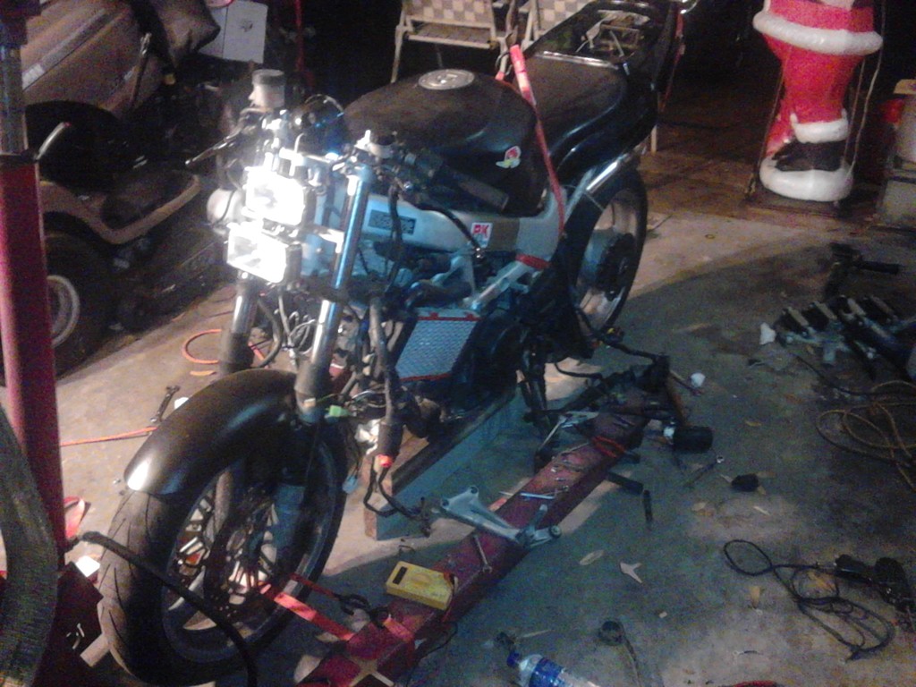

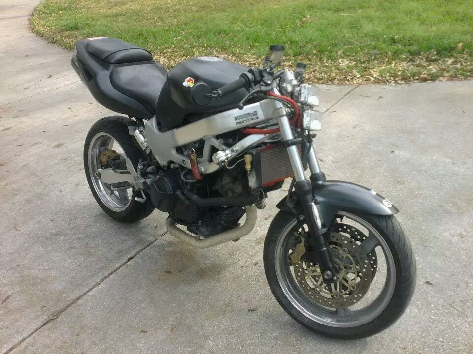

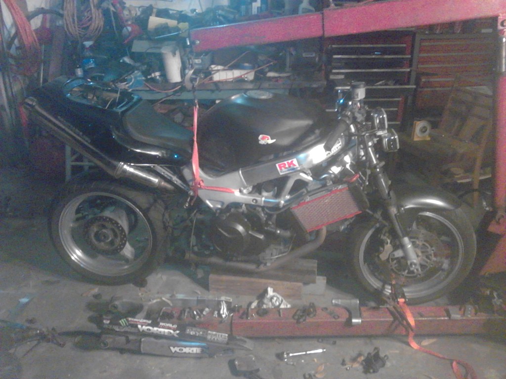

this is where it was a couple nights ago in mock up phase, still getting ideas on the direction i was going with it
i have the stock cans mocked up in those pictures, but they are too bulky to get to fit up there right so im going with the harley pipes.
im getting back out there and get to working on it. gotta get it done before bike week!!! i'll post more pictures as i take them

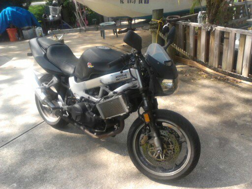

got some pics taken from the other night. on my lunch break, only have time to post up pictures, ill write a description later
sorry for the grainy pictures from the cellular device
after i was done with the exhaust, too late to use power tools, and frustrated enough to kick the damn thing over, i think i found my true calling... "duct tape decal master"

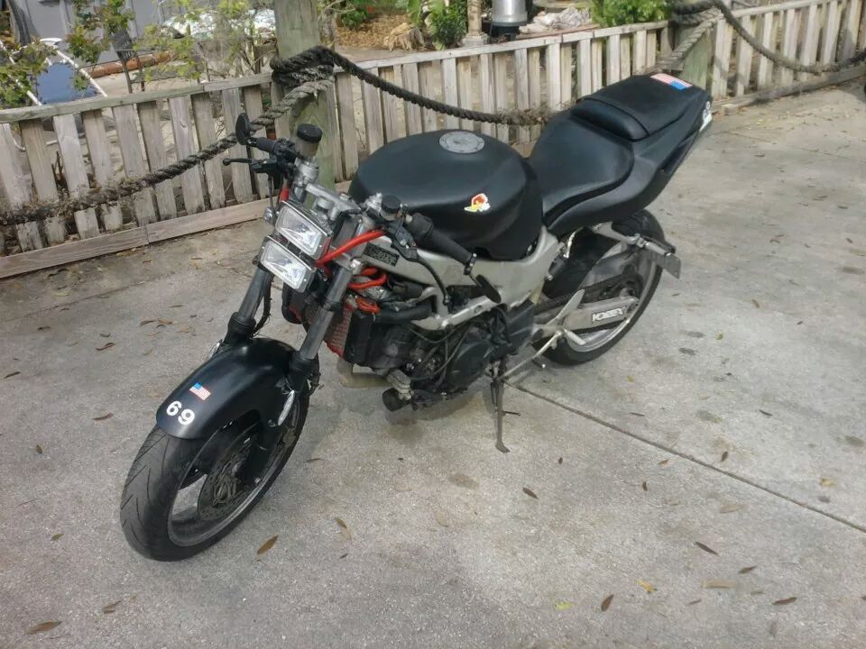

status update:
exhaust: pretty much done. just need to trim the cans to length and finish putting the wrap on it
Radiator: cut and filled the extra outlet, put a manual temp gauge in it, relocated the oil cooler, and ran the hoses to the radiator. Just need to permanently mout the rad.
Wiring: ... i hate wiring. Its a mess. I have no clue where im putting the battery. Still have headlight wiring to do since im going dual headlights and have to wire up two separate relays. Do turn signal wiring, and rear brake light switch.
Body: still need to permanently mount the sub-frame and fairing, make a passenger seat and pegs, and figure out what I'm doing for gauges and a mirror. Have to make an undertail for the fairing and battery box as well.
Suspension: got the adaptor made for the F4i shock at work yesterday and got the spring and fork seals in the mail today. just need to bring the shock in to work and install the spring. need to take the forks off and install the seals.
Deadline: 8 days till bikeweek...

got my shock all done at work during lunch break. '02 f4i shock milled two flats on the bottom end, made a stainless press bushing to take place the original bearing, made adaptor out of 304 stainless since all we had was 6061 and we didnt have any 7075 that was big enough. that put centerline of the holes 40mm apart with a press fit on the bearing, eibach 950lb spring, and racetech adaptor bushings.

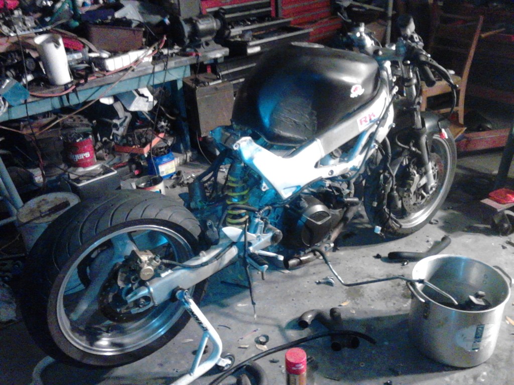

oh man where to pick up...
guess ill start with some more pictures of the exhaust when i was tacking it up
then to quieten the bark of the bare harley pipes i made baffles out of some oil filters. i ended up making a dual chamber and made the first to act as an expansion chamber equal to the same volume that was being displaced by the engine to get rid of the harsh pulse and try to gain back SOME power lost by not using a crossover
when putting the forks back together, just remember; if you find yourself reaching for a 3lb sledge hammer, stop. you've had too much to drink and you're doing it wrong... (flames will come, i know but whatever, i learned my costly lesson) $50 and a bent complete fork assembly from ebay later...
then i started to tackle the wiring and was tickled sh*tless when i found a spot for the battery to live. also found a hiding place for all the wires that were in the headlight stay to reside right in front of the airbox inside the frame
i dont have any good pictures of the radiator, but i hacked the inlet tube that would be hanging off the side and welded it up and put a analog temp gauge in the fan switch slot. the screws were seized in the rear brake reservoir, so i couldnt get to the fluid. i had an old clutch master from a ranger laying around so i stole the reservoir off it and did some trimming to the bracket. it fit perfectly behind the shock reservoir that i mounted on my subframe extension. i mounted my coil the same place, but on the other side
while i had the tank off, i did some much needed bodywork and sprayed some truck bedliner down where people put the grip tape
got to piddling and was thinking of something like this for the gauges i had seen another member do something along these lines, cant remember who it was

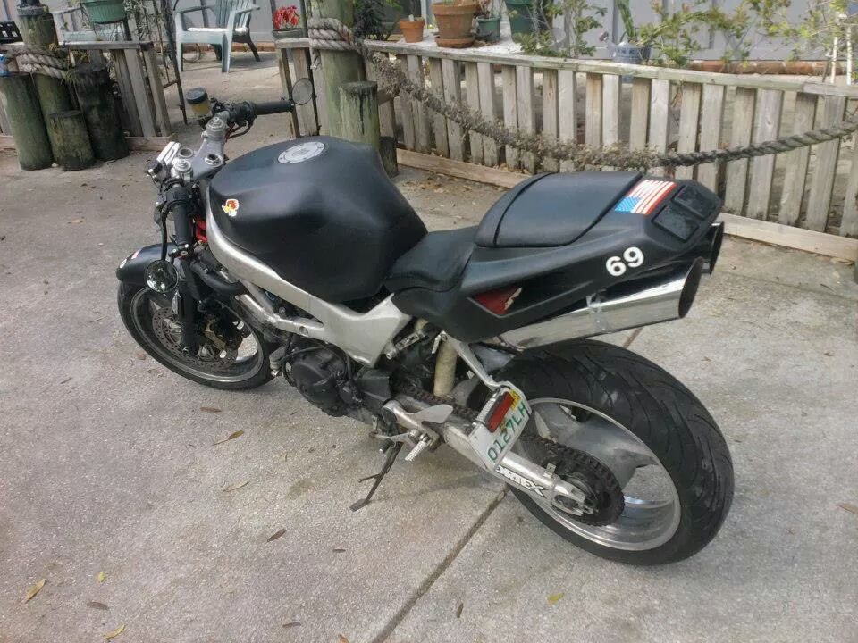

all in all, this is how she sets right now

Since requested, a breif recap of the previous version:Name:  bike%20home%202_zpso66zzfvs.jpg
Size:  173.4 KBName:  IMG_20130215_000736_zpsgabnu24j.jpg
Size:  135.2 KBName:  IMG_9422677228996_zpsfpclcp9f.jpeg
Size:  140.9 KBName:  IMG_9427908207174_zpsvhgkderk.jpeg
Size:  130.2 KBName:  Screenshot_2015-09-09-18-04-41_zps908kt1bz.png
Old Oct 2, 2015 | 02:57 AM
shake-n-bake's Avatar
Umm...I'm awesome. Duh...
Joined: Mar 2011
Posts: 87
From: daytona beach, fl
shake-n-bake is on a distinguished road
That's how it was at the end of the last building cycle, if I were take pics of it now, it's still buried in the garage, but that it changing this weekend since I have all these nice shiny parts taking up space in my bedroom lol
