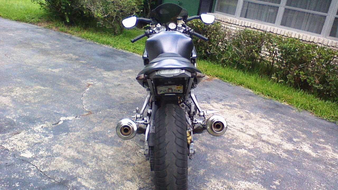

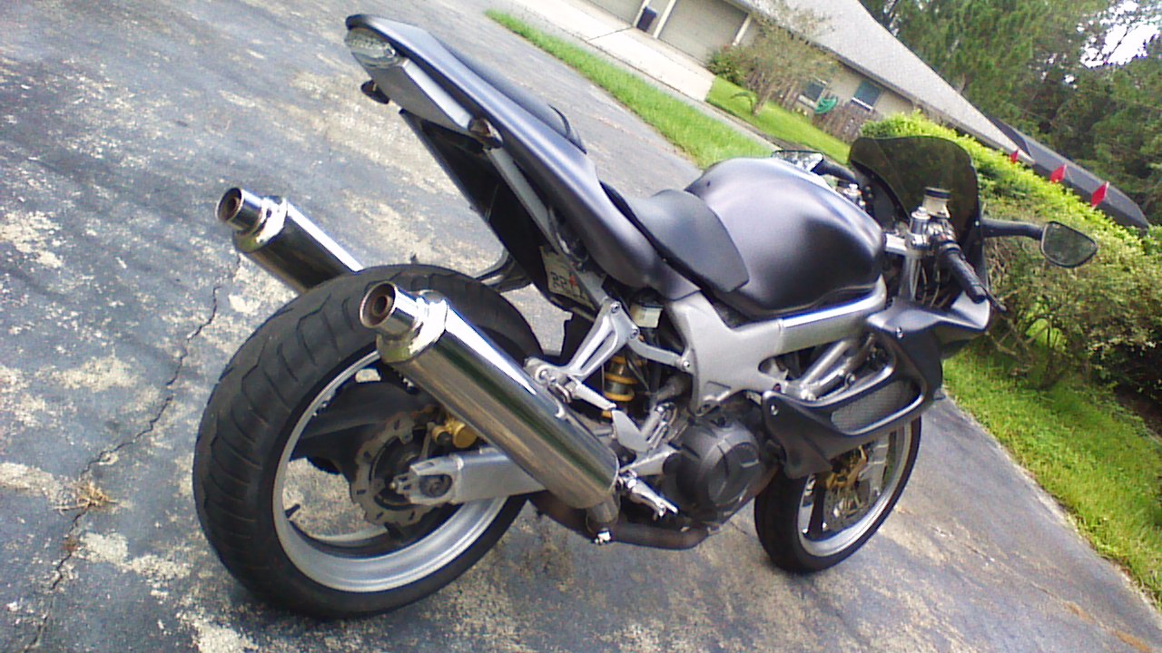

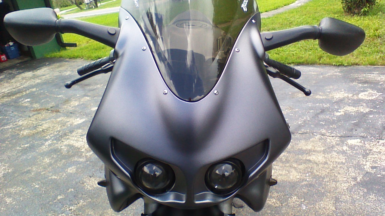

After days of negotiating and waiting, I've finally adopted this 2K VTR1000 Superhawk. From the looks of it the previous owner has done some extensive visual mods that I plan to build from or use as a base. I kinda like the different look, hence, the reason why I actually made the deal. I'm not one to follow the norm. I'm considering other performance mods so you can bet that I'll be leaning (No Pun Intended) on this great forum for guidance. Here some pics for your enjoyment...!

Looks like a nice and well maintained Hawk. Welcome to one of the best motorcycle groups in the world! Meet you at Old Town on Thursday nights, or on the way to Daytona....
Old Sep 6, 2015 | 07:49 PM
Posts: 5,223
Cool Hawk. Some clean lookin' body mods.
Old Sep 6, 2015 | 07:56 PM
Welcome on board, very wild look, I like the Buell firebolt front :-)
The tail, looks like Buell as well, but something is different

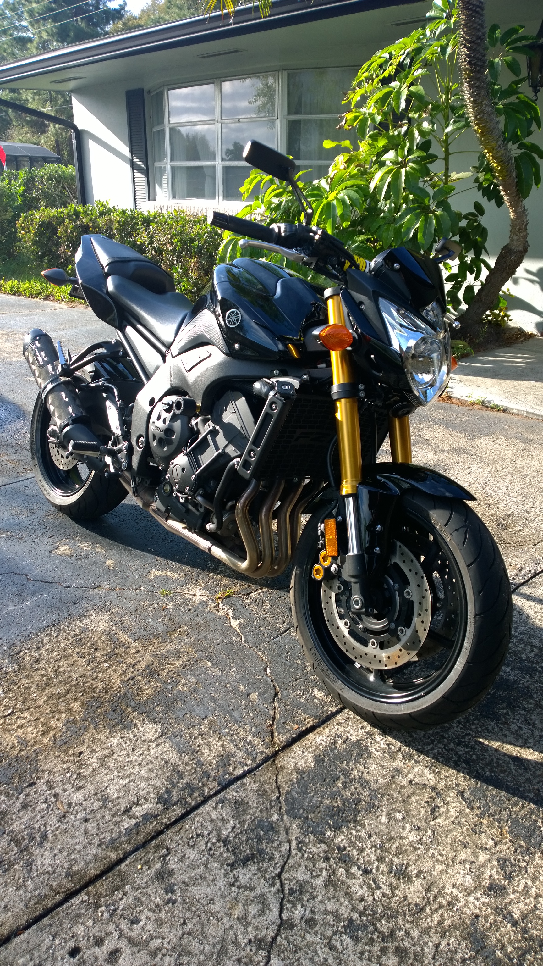

As far as how it rides, compared to my 11' FZ8, it's much narrower and longer than the newer Yamaha. Almost feels like riding a Ducati and I can't lie that the V-Twin sound is sweet. To put it bluntly, I am in love...

Compared to my 2011 Yamaha FZ8, it feels like a Ducati because of how narrow it is. Not sure I like the ride height in the rear, and seeing that the front was lowered, my first call to duty is figuring how to raise her up a tad. Any suggestions Hangfly...?
