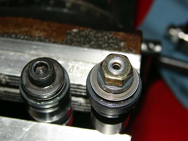

Josh got his $25 discount and I have the satisfaction of saying that I was right. No changes whatsoever between 98, 99, 03, and whatever year the blue came out (04?), right down to the same shimstack. So, comedo, whatever forks you were working on were either modified or not from a VTR at all. See pics:

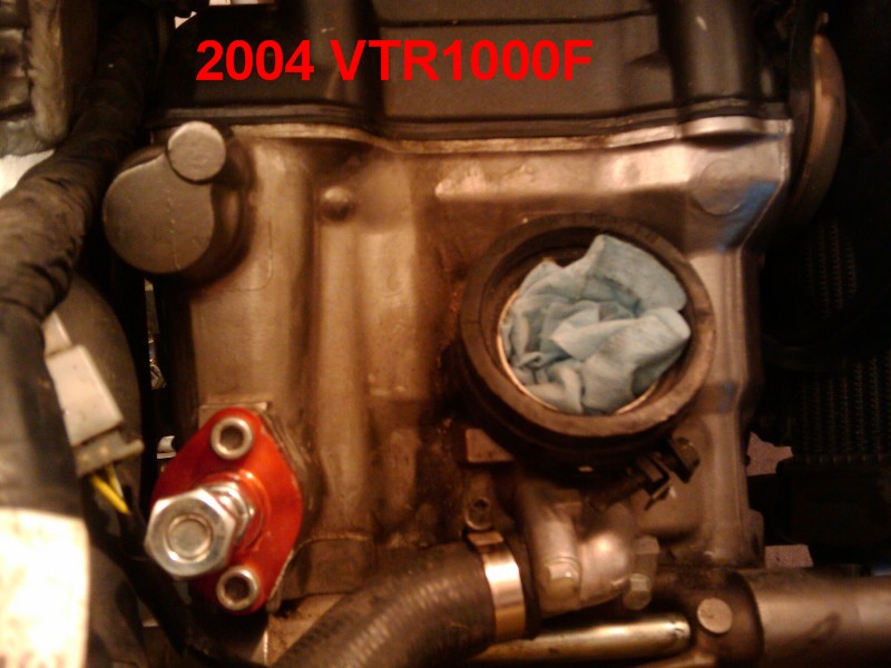

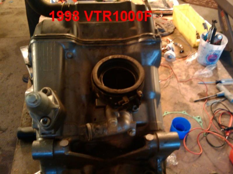

I just noticed this today as my buddy was doing a motor swap ('04 motor)on his '98 VTR. The 2004 has additional casting on the upper left of the pic. Both pics are from the intake side of the front cylinder head. I imagine it's for a sensor on the XL1000. Not sure which year they started doing this... anybody?

It's highly debated over the purpose of this casting. I'm surprised you haven't heard of it yet. It's believed to be either an additional piston bearing, a camshaft cooler, or a flux capacitor. The technology is "way out there" though and nobody is yet to figure this one out.
Old Apr 18, 2009 | 06:32 PM
  #46
My guess from the location is a camshaft sensor, held in place by a small bolt (which would go where the small landing is at 1 o'clock). I looked and my '05 has the casting extension.
This could be a sign that Honda had considered EFI before production died. The Camshaft Position Sensor (CPS) on cars is used for timing Sequential Fuel Injection (SFI=injectors pulse in time with opening of intake valves). It's also used for spark timing.
Of course addition of a Flux Capacitor would have yielded much better performance.
Old Apr 18, 2009 | 10:21 PM
  #47
I must of been out of the loop. It definitely looks like CPS provisions for the Varadero.
Old Apr 19, 2009 | 01:09 AM
  #48
The Vara does have a CPS in that very spot... So I'm guessing it just a shared cast for the parts...
