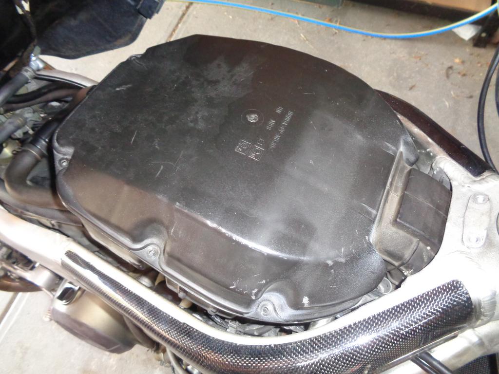

open up the air box to remove the air filter,

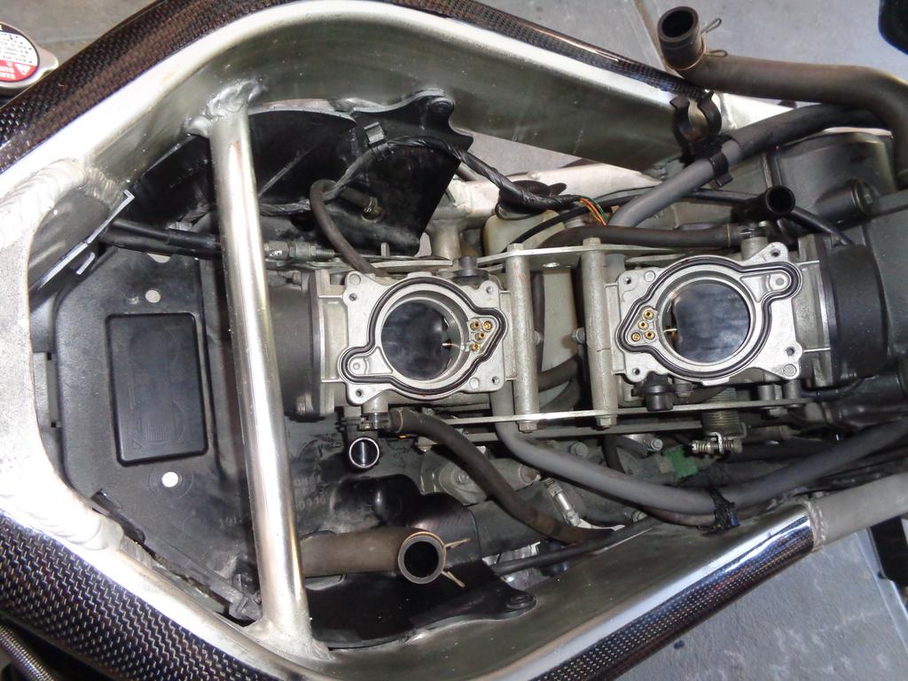

this is when I discovered that the carb filters were badly deteriorated and would probably take a few weeks to get new ones,
so, thought I would for now, make some out of lawn mower pre-filter and a squirt of K&N filter oil to get me by until I can get some new filters,

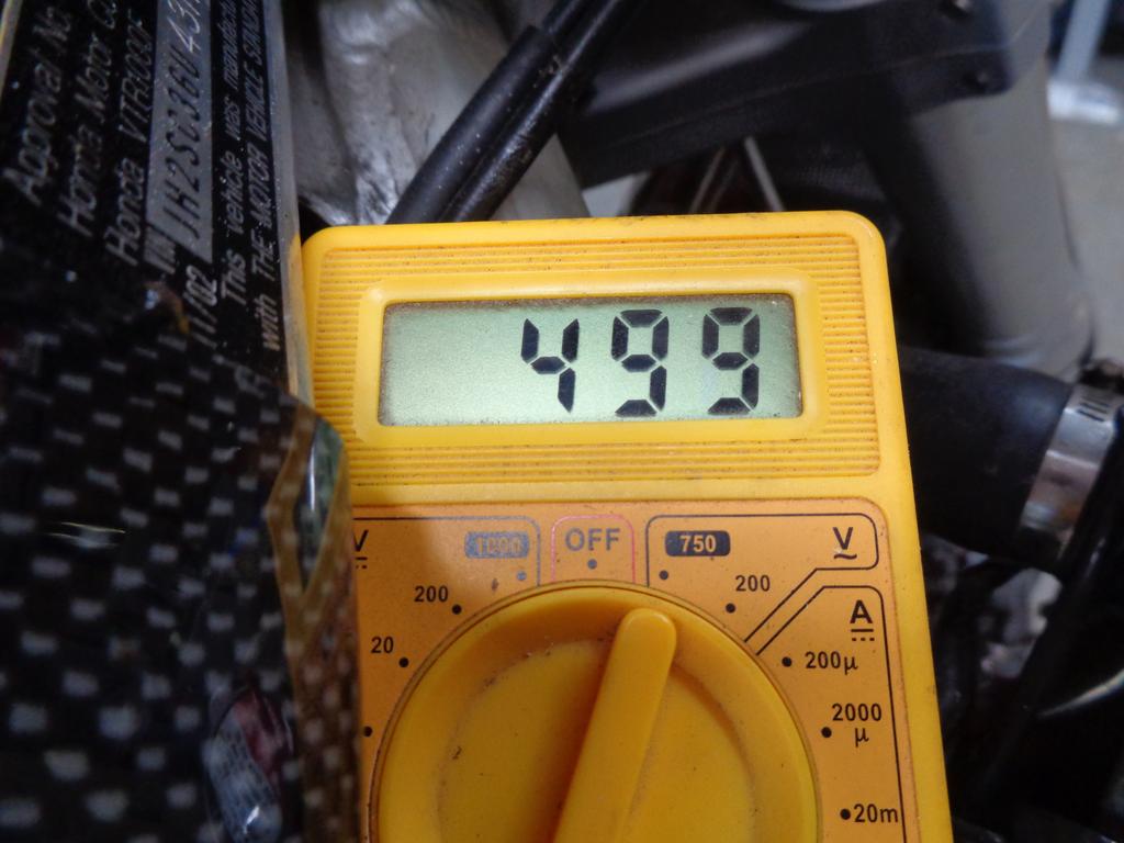

got out the multimeter and connected to the top and middle pins,
had a reading of 830,
adjusted the TPS anticlockwise until I got as close to 500 as I could,

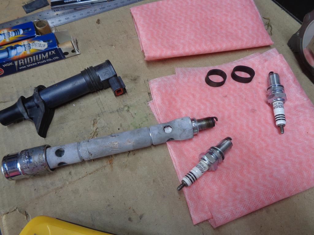

Pulled the spark plugs while I was at it, didn't have new ones on hand, but did have an old set that I cleaned with some carb cleaner and put those in until I get some new ones that will go in with the new filters,
rear plug seems dirtier that the front plug, but the cleaned up plugs should be better than the dirty plugs I'm thinking !?
rear plug with cleaned up old plug,
front plug with cleaned up old plug,
