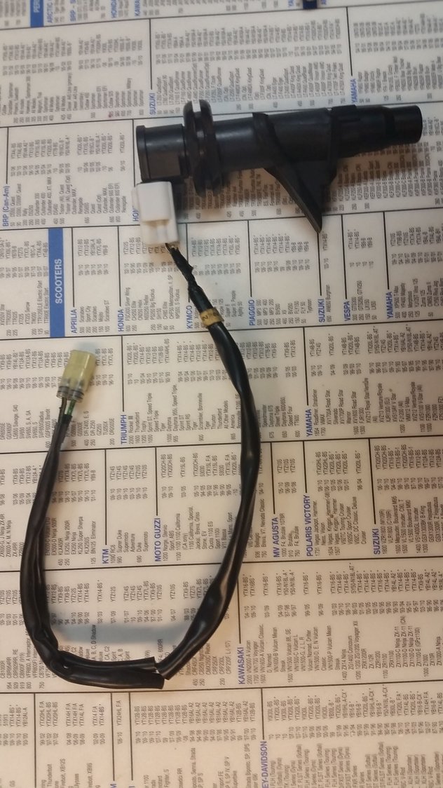

Better yet go to CBR600 stick coils; do a search...

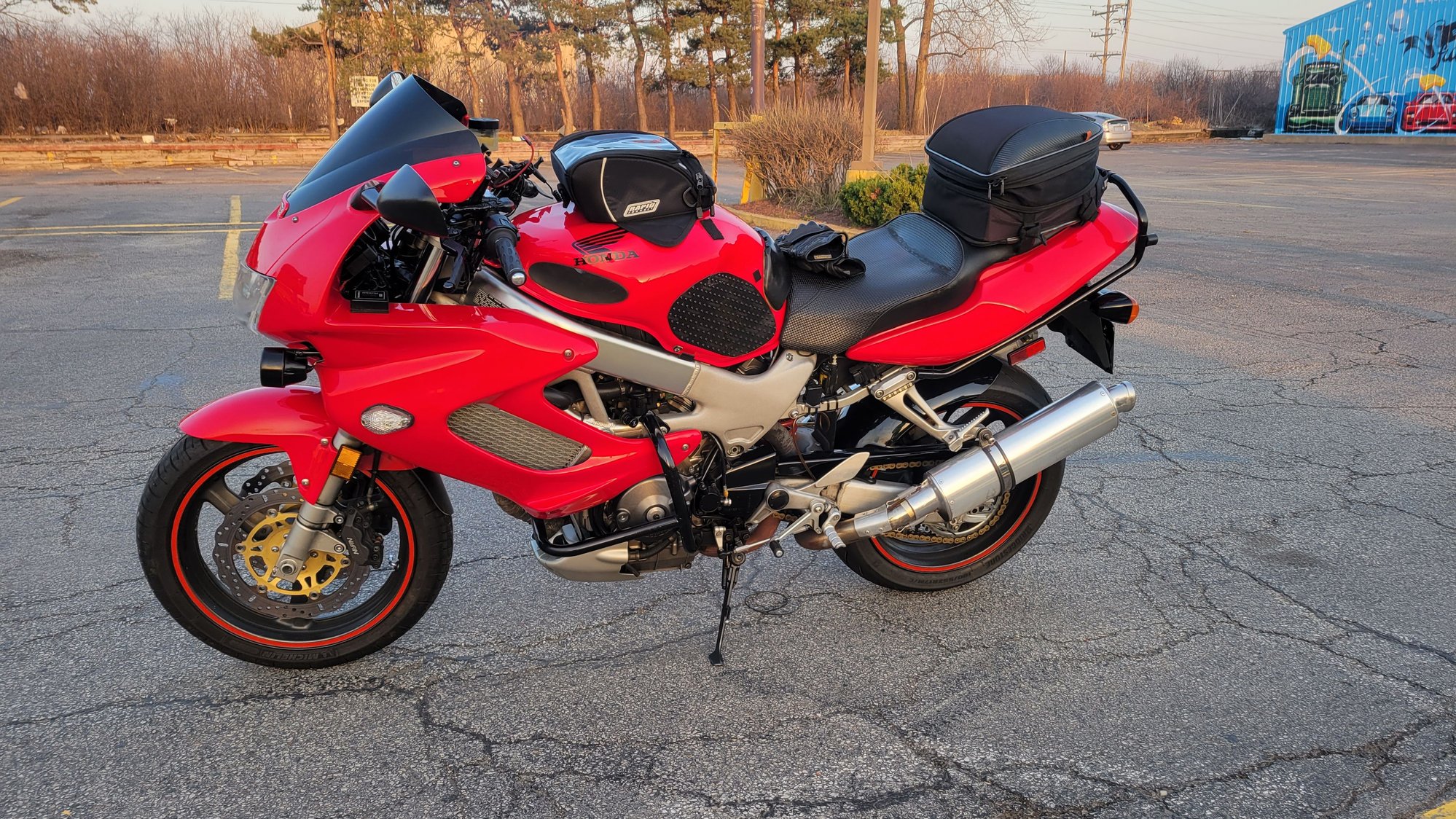

Still have 5.2 gallon tank as stopped using it because my prostate wouldn't let me empty the stock tank before my bladder.
At the now long gone Highland House in Highland Park, IL (yes that HP where the July 4th mass shooting took place). On a good Sunday 400 riders would congregate.
Going to buddies to enlarge spare tank to 5.2 gallons.

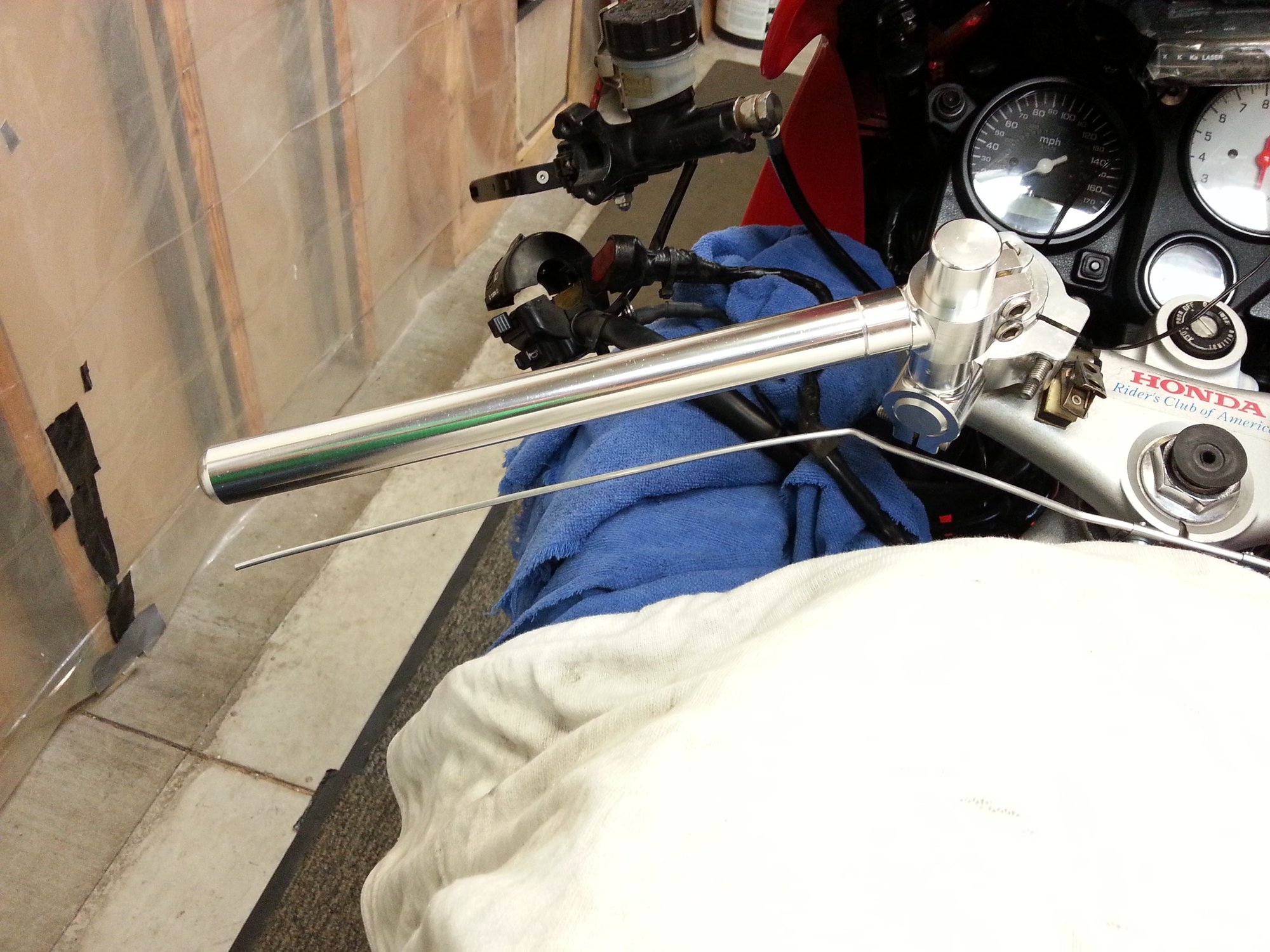

3rd set of clip-ons after Helibars and VFR bars, Tommasellis,
Now unobtainum 3D 4-way adjustable clip-ons

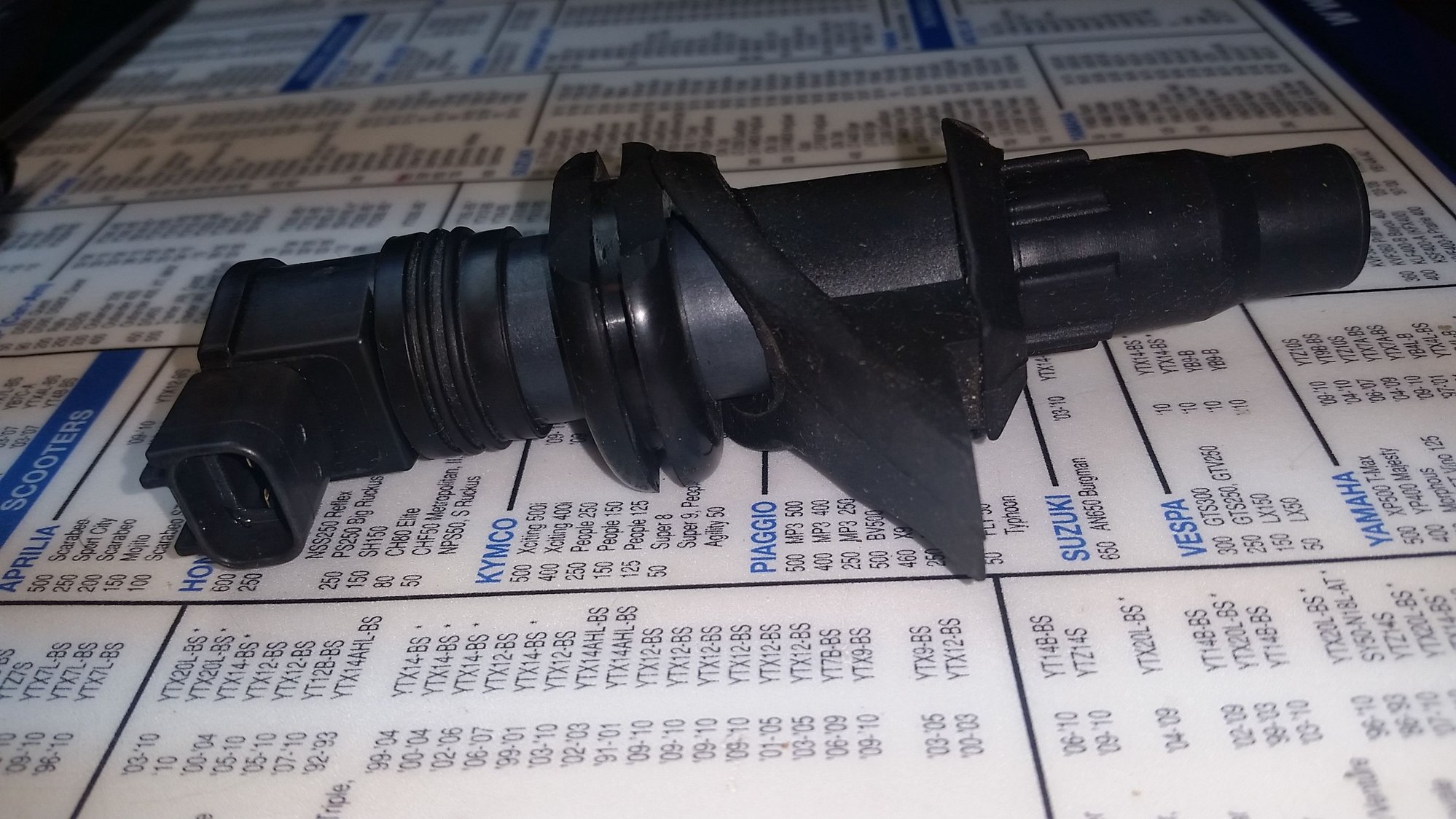

4 used for $25, splice the CBR600 wires to the VTR wires, and get rid of 5 pounds of junk weight
Stick coil hole weatherproofing

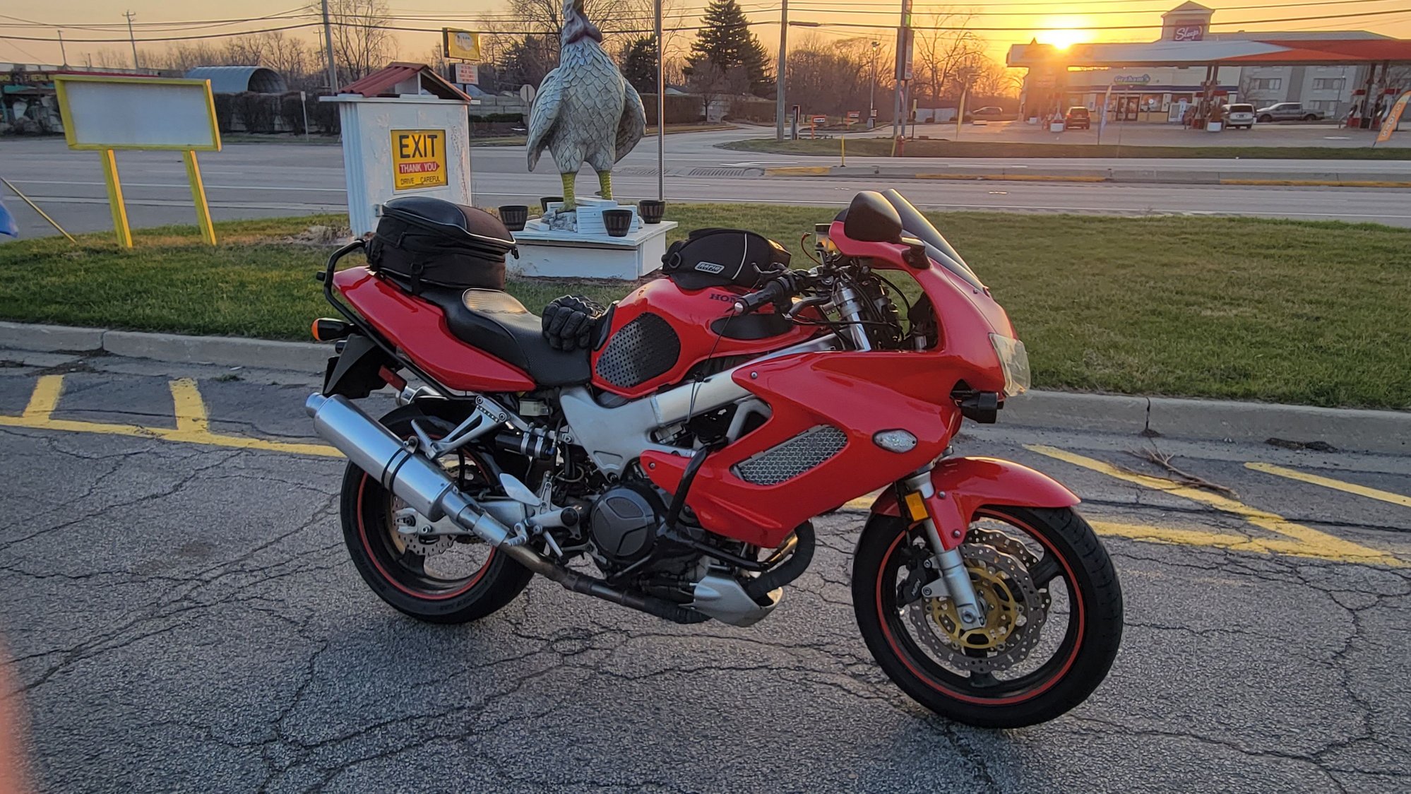

Sunset at Full Moon Restaurant in Lake Bluff, IL. The "new Highland House"
