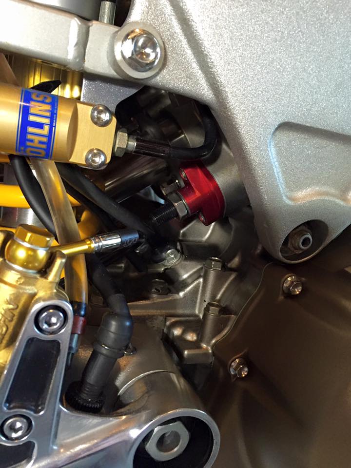

Hi Guy's just wondering has anyone got a WP Rear shock fitted if so could they put up some pictures of it fitted to the bike or better still some fitting instructions, struggling where to fit the 2 remote canisters, Thanks Very Much in Advance

Mount it up the same as the similarly-equipped Ohlins: remote reservoir on left (ie. shifter) side (between the subframe rails) and remote preload adjuster on right.

Reservoir will fit on the left lower sub frame rail, the remote adjuster on the lower right sub frame rail

My Ohlins remote preload adjuster mounting and pressurized bottle mount
