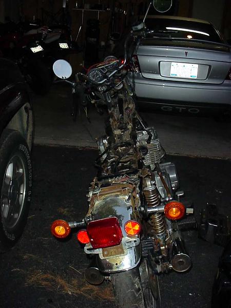

This is Alice. I picked her up for $235 last week so that I'll have something to do this winter that's motorcycle related. Winter here sucks! So anyway, Alice is a'hurtin! She's a '79 XS750SF TRIPLE with about 28k miles. I don't think she's run in quite a few years. Last known registration was about 10 years ago. Others have tried and failed. I will not. I am going to do my best at going for the cafe racer look. Here's a rundown as she is now:
- She used to sport a Vetter but that's gone...thank God! The rats nest of wiring remains as does the need for a new headlight. That's going to be one of the last things I get.
- The high-back seat is ripped, taped, and simply disgusting to look at. $60 shipped got an almost new stock one from ebay but will probably trim the foam and recover anyway.
- The tank, surprisingly, has not a spot of rust, inside or out. Will be painted black. Something is rattling around loose inside though. I get the key Thursday (PO and I both had only about 3 hours sleep when the transaction went down) so I'll find out if it's a petcock screen or a rat skeleton. Maybe a Hot Wheels car?
- Missing left side cover.
- Most chrome is not good. Will replace or paint/powdercoat as necessary.
- The kickstand tang is broken. Just got one off ebay and will recondition it.
- The forks will probably just get tossed. I'm going to try to graft on the VTR forks after the 1000RR swap. Hopefully the carbon fiber front fender will transfer as well.
- AND, if all works out well the entire front brake system will transfer over too, including the Galfer wave rotors!
- Carbs are now cleaned. Found a bugs nest (mud dobber?) in one of the jets and its associated port. That was fun cleaning out....not. 1/3 can of carb cleaner later.... Anyway, one of the float bowls is cracked and repaired with JB Weld by a PO. Niiiice!
- Carb boots soaked in parts cleaner and inspected - some outer cracking but good inner seal.
- Emgo pods ordered. Airbox will be checked for it's flame retardent properties. I don't expect it will fare well. I'm researching the breather filter.
- Wiring harness has some broken connectors. Will find one on ebay for cheap and replace as necessary.
- Turn signals will go away. Cafe racers don't have signals!
- Overall lots of rust. Will take many parts to work and use media blaster to get clean. All will get powdercoated or repainted black.
- Wheels will be painted black. Conti tires changed out for Avon eventually.
- Exhaust is trashed. Just a minor scrape visible on the right megaphone but the entire system underneath is all rust. Will probably fall off after it starts again and I'll be forced to get a Mac. Isn't there anything better? I did some research.
- Brakes/clutch work (amazingly) but I'll go through them and clean/replace seals as required.
- All fluids will be drained and replaced - already on hand.
That's it for now, folks! I'll post more as I find it, and I'm SURE there will be more.

She RUNS!!! Not very well, but she definitely runs. After getting a new/old ignitor unit (black box) off ebay and verifying good spark she fired up after less than a second of cranking! I even threw the seat on and took her up and down the street. Shifts well in all gears. Front brakes are downright scary weak! Running lean above 6k and idle is hanging. Now it's time to rebuild/adjust the carbs and get new carb boots. The old boots are a little cracked and I think the addition of individual pod filters has leaned her out too much. Tach was also not responding well and is not serviceable. Found a NOS one for $60!
Old Oct 8, 2007 | 07:13 PM
Reborn, first time she's been started in who-knows-how-many years:
http://media.putfile.com/XS-750---It-Lives-Again

She runs even better now that I took some crap out of one of the #3 carb jets. Now that I know what I'm working with and the motor and drivetrain are good I'll be stripping her down pretty much completely and starting from scratch. Lots of black engine paint and glossy black for frame and pieces parts. Probably going to send the side covers and tank out for a nice coat of arrest-me-yellow. Never had a yellow bike before and I think the yellow and black will go well together. Black's a PITA anyway. Planning on doing major mods to the seat pan to get a cafe seat look but with only foam and upholstery...maybe some yellow piping. I have an extra seat pan in case I f*&k it up...which I probably will. The wheels will be black. Front end from the VTR as mentioned earlier. Shocks from another bike, preferably with preload and rebound adjustments. 1 up rear tire size. 120/70 front. Maybe find a 5 spoke front to match the rear more closely. Wiring harness will be redone. Signals will go away. Cafe racer front fairing with round headlight. Probably going to look into getting an LED taillight integrated into the rear of the seat. Custom gage brackets with stock tach and probably an aftermarket speedo. Maybe update the controls with something more modern but I think I'm stuck with the foot controls. I'm thinking about a toaster tank from a donor bike as well.
So those are my ideas. We'll see how it all pans out this winter.
