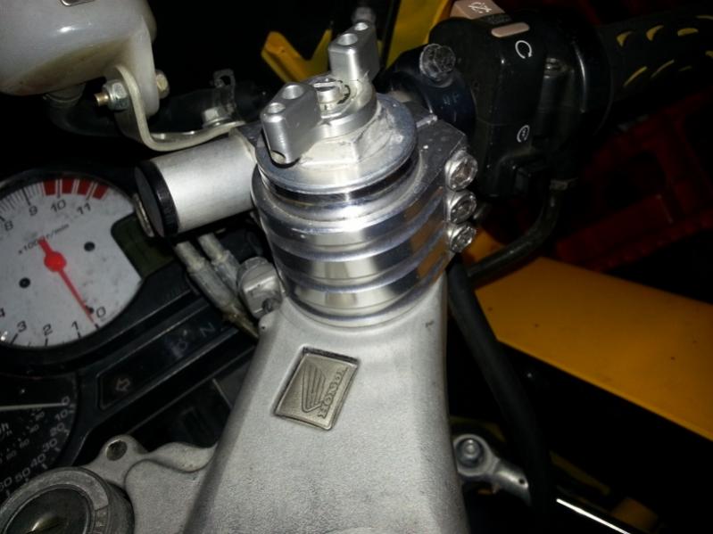

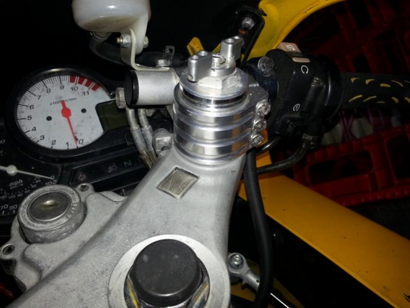

What am I dealing with?
I'm new to the forum...should've joined a couple of weeks ago when I made my purchase but I haven't had a chance. I apologize if I missed this in a search. I'm about to replace the frame of a 2002 Superhawk I bought (it has a salvage title due to be stolen). I have done work on several bikes I've owned so I know each time is a new adventure and new problems . My main concern are the forks. I've researched but haven't found any info about this fork adjustment mod. If you can tell from the pics and know feel free to chime in. The guy I purchased it from was a little out of it and didn't have much information. Thanks for the help.
Attached Thumbnails What am I dealing with?-20150111_123226-800x600-.jpg   What am I dealing with?-20150111_123214-800x600-.jpg
Old Jan 11, 2015 | 11:57 AM
hawxter996's Avatar
ole dirty bastard
Posts: 976
From: my house
looks like preload adjusters.
not much too talk about really.
what are your concerns?
Old Jan 11, 2015 | 12:13 PM
Posts: 5,223
Those add-ons just allow easy tool free adjustment of the spring preload. If you know how to properly set sag, once set there really is no need to be adjusting.

Thanks for the replies. I thought it was for a quicker way to adjust the springs. I just didn't want to start disassembly and be surprised. I've found that out the hard way with other bikes I've owned with random mods. While I'm asking is the Shindy steering damper really needed/useful along with the Coerce fork brace for everyday riding? I'm deciding what parts to keep and what parts to possibly remove and sell.

It IS a quicker way to adjust the springs. That's what preload is. It is the constant pressure (load) on the springs. Looks like aftermarket clip on handle bars too but that is not of much concern.

It looks like your forks are slid up in the triples. That's a bad thing on the VTR (most bikes in fact) so you will want to lower those back down where they belong.
