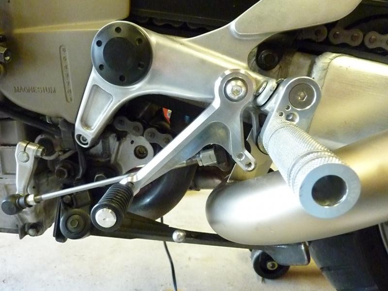

In addition to Mr. Marquez suggestions,
If you desire more leg room, these are nice.

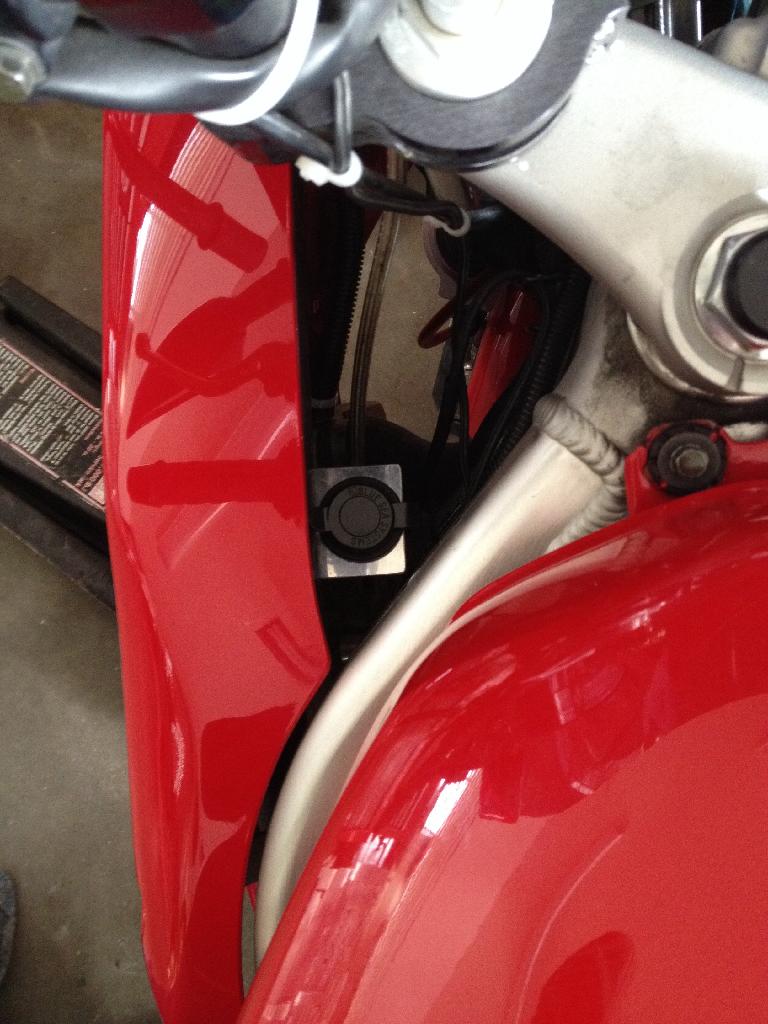

A 12VDC outlet is nice also. I use this for my Ram mount GPS

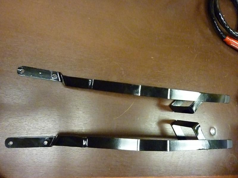

The rear cowling is also pretty fragile. If fitting saddlebags, a suggestion is to purchase or fab up some protection from additional side pressure.
Such as these...

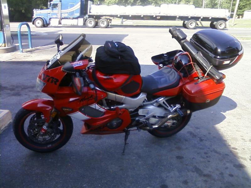

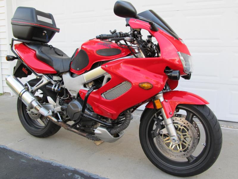

Ideally, it would look and work like this.
Vista cruise, touring screen, corbin seat, givi wingrack (all cases fit all 3 spots). 52 liter maxia topcase. These are e21 21 liter sidecases but I have e45, 45 liter side cases that each hold 2 full face helmets.
Ram gps mount. You will want sound in the helmet so bluetooth or chatterbox.
Eastern beaver high output headlight setup with 100 watt bulb.
Attachment 16739
Attachment 16740
And without a doubt one of the best upgrades I have done is install the mirror extensions that were made by one of our members. IMHO a must.
That looks like like it's off of a vfr does it just bolt right up?
Btw used to have a red 99 vfr allot more comfortable than the hawk plus I miss the fi, gear driven cams and v4

I was talking about those foot peg mounts...
I love the hawk its a great bike but nothing can win me over my first street bike
Thanks for the inspiration- I've been trying to figure out where to install a 12v outlet, and that looks good!

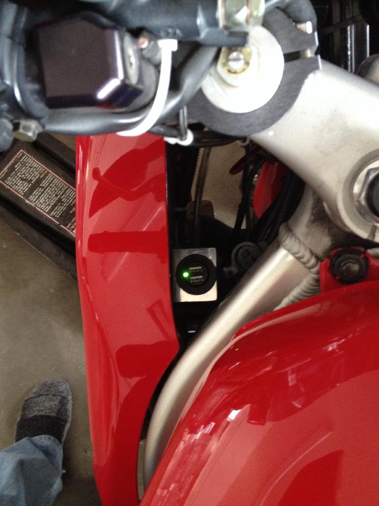

If you are looking for a way to charge USB devices (all my charging / power needs are USB, I see no need to wire up a 12v cig lighter or powerlet socket, only to use a USB power adapter in that socket.
Those needing a 12v socket... well, disregard.)

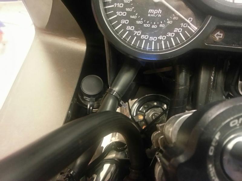

Here is another option
Blue Sea Systems Dual USB Charger Socket Blue Sea Systems Dual USB Charger Socket
Mounted in a simple aluminum bracket riveted to the left hand air duct

The footpegs are Cycle Pirates 360's. Readily available.
https://www.google.com/webhp?sourcei...s+360+footpegs

USB=Better Idea. After thinking about it I only mounted the 12V power outlet on my bike, because that was what I was using in my truck. It's worked fine, but USB is cleaner. I'm changing that sucka out. Thanks

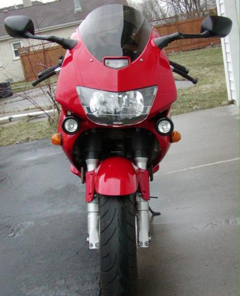

I'd love to see a picture of your driving lights Skokie!
Old Mar 3, 2014 | 12:40 PM
Posts: 2,223
Here you go...

Thanks.Been thinking about led lights similar to that for those late night sortee's
Old Mar 4, 2014 | 08:27 AM
Posts: 2,223
Adequate LED driving lights were a pipe dream in 1999...
