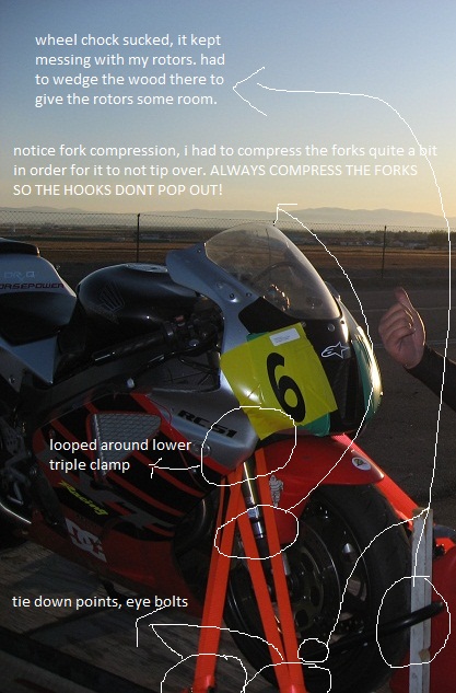

im attaching a pic, not a very good one, but hopefully you get the idea...it was from when i went to ca superbike school on saturday. used a harbor freight folding 4x8' trailer. performed like a champ. never really ever had a nervous moment while hauling it to streets of willow.
i know this is a pic of an rc51, but if anything, its a crap ton easier with the superhawk, the fairing is a bit shorter giving more access to the triple clamp. i hope my efforts help...
edit: i used 2 tie down points with 2 straps as a safety measure. using 2 points with 1 strap is perfectly good too, i usually do it that way when i have 2 bikes on the trailer as to not overload all the points. if you're REALLY paranoid, wrap the hooks with a bunch of duct tape so they dont slip out of the eye. even better, go to home depot and get some heavy duty carbiners in the chain section to use in conjunction or in lieu of the normal hooks. this way, you're for SURE locked in.

uchi, be sure to put something in FRONT of the front wheel too, so you can ratchet pressure forward, not just side to side.
this is a pic of the lower triple clamp (i know, its off an rc model, but its the same thing in real life)
