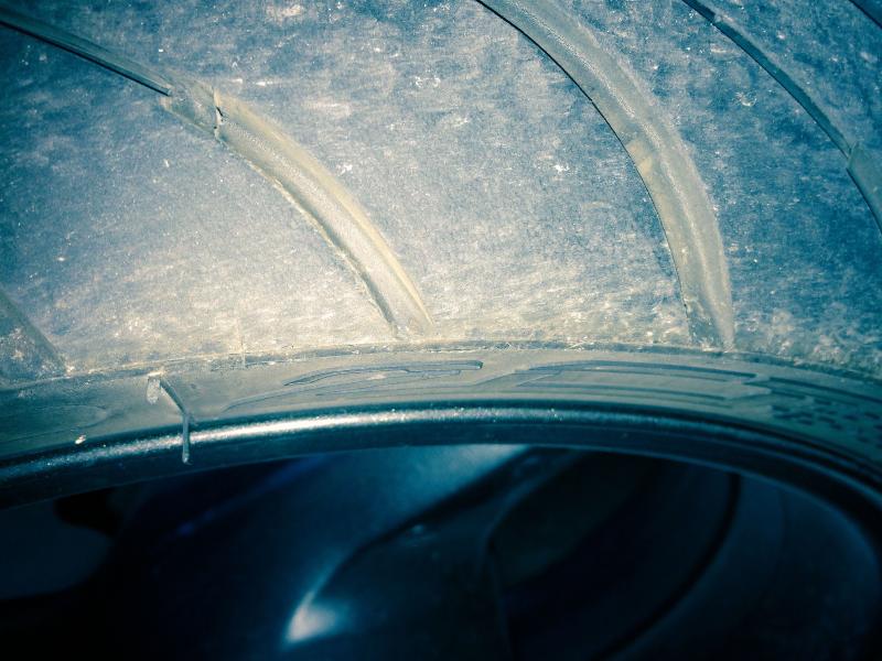

Originally Posted by kenmoore
Yeah,
The money I save on tires for the Storm help me to keep it going and be able to afford to tinker with it.
PR3 is a bit more $ than a bargain basement catch at cycle gear or a NOS tire at your local dealer. BUT.. they wear long and have traction for miles.
Scrubbed all the way to the edge no issue. That tire has 4236 miles as of today.. with a lot to go.. Last one went 9k plus and was only replaced because the front was gone as well..So I did a set.
Admittedly..Im a tire snob and change them often because I get them at cost and have a rim clamp tire machine and balancer at my disposal.. so tire changes are not costly.

What can I say.. Im not an expert.. so I only know what I know.
I've ridden on a dozen or so tires brands/models for this bike.
I like the PR3s the best. I have found no tire traction limitation based on how I ride (spirited... and yes I ride my tires to the edge...)
They are hands down the best wet weather tire i have used. I don't try and ride in rain, but it happens and several times I've ridden in rain with so much water coming down I could not see 10 feet in front of me,,, and streets were flooded.. the PR stuck to the road and tracked perfectly, no hydroplaning.
Same for hitting those water puddles in low spots in the road at speed.. just cuts right though.
Long lasting center section which is good as where I ride I have lots of unending slab to cover.
So it corners as good or better then I am.. is good when i get stuck in wet weather. Seems to not loose significant traction in cold weather and last a long time.
What traits of a "too stiff" side wall should I look for? I'll think about that next few rides and see if I can feel symptoms of a "too stiff" side wall.
