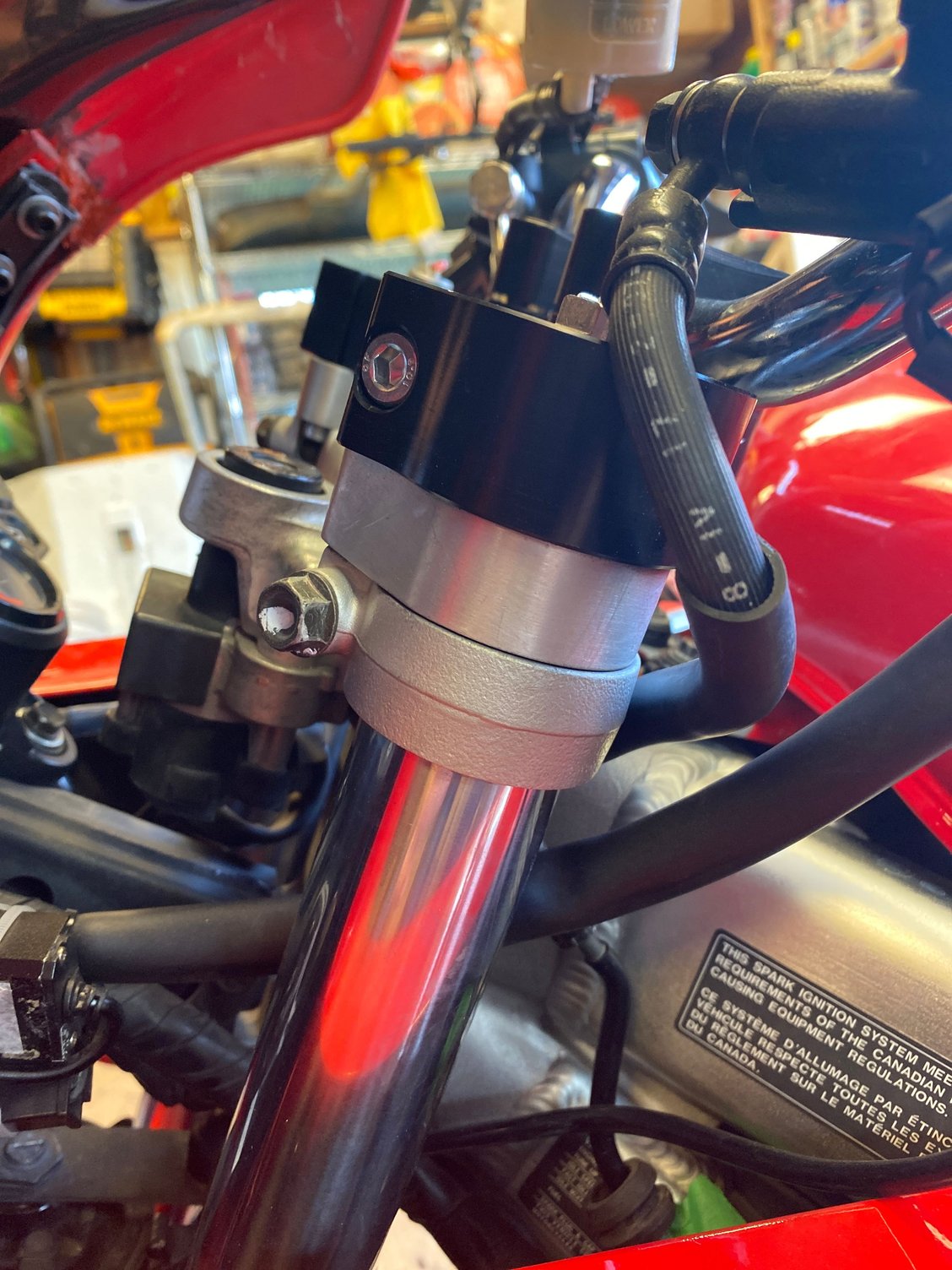

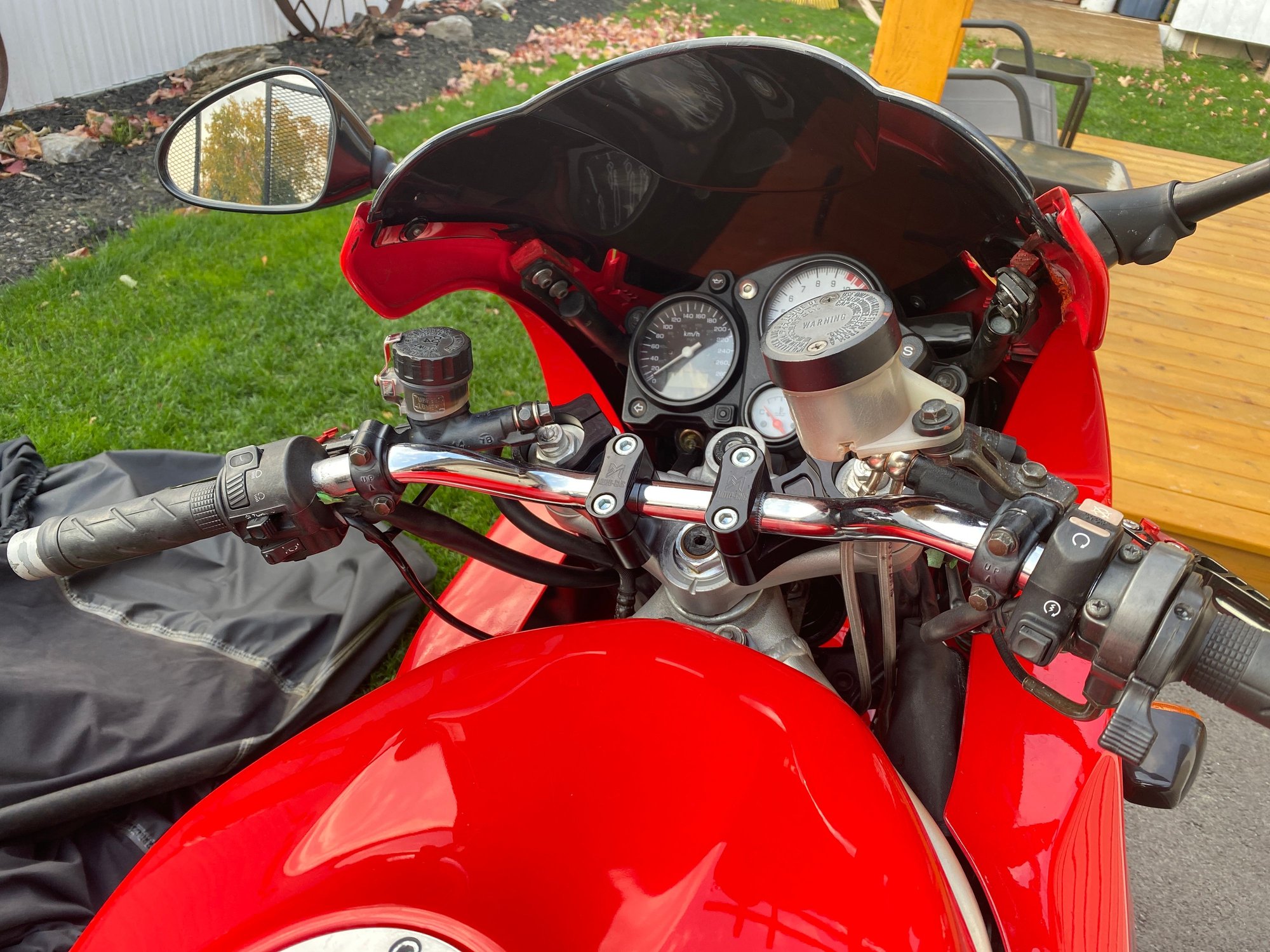

After contemplating raising my bars, I finally went for it. As a newly qualified senior citizen I hoped that raising my VTR’s bars would make for a more comfortable ride on my longer rides.
All my wishes have come true! My bike feels like a different ride altogether, a definite improvement!! The more upright body position (almost Standard) is very comfortable although it has taken a few rides to adjust my brain, especially at low speed I will keep the stock parts but I doubt I will ever be reverting to them. I sourced the risers from England and the bars from eBay. I shimmed the fairing up approximately 1/2 an inch at the mirror mounts and re routed my control lines. I had to splice an extension to the horn wires (just a few inches). The previously installed stainless brake lines worked well and the stock clutch line just makes it. The bonus is I did not have to trim the fairing ears as there is no interference at full lock. Bottom line, it was totally worth it!!
Moto-CNC risers on top of existing 3/4” risers...way up from stock
Way up 😎

Looks good and pretty sweet that you didn't have to shave the fairing for it all to fit. 👍👌
A little off topic question for you as I noticed you're wind screen is pretty dark.
Is this a dark smokes screen or did you paint the inside black?
Ive been contemplating my factory wind screen black as there's nothing wrong with it and rather prefer it as I can spend more mo way on other parts. 😂😜😉
Now that I see how a dark screen is with the gauges it furthers my want to paint it.
Thanks and enjoy the miles on the steed. 🙏🏽👍

The windscreen is an eBay item which is similar to the double bubble style...it does reduce wind buffeting a bit and I lIke the dark look
