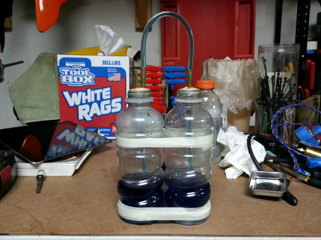

Going off of what 7 said, I hope I didn't give you the idea that a carb sync will fix your problem 100%. I'm sorry if I did. It very well could be several problems together causing the lack of power. That's why I said to do a tune up and get familiar with the bike. But since you took the carbs off, sync them and see where the bike is at.
As for the carb sync, Google is your friend man! Just doing a quick search yielded this...click here
Half way down the page is the Two Bottle method.
This is what I ended up making

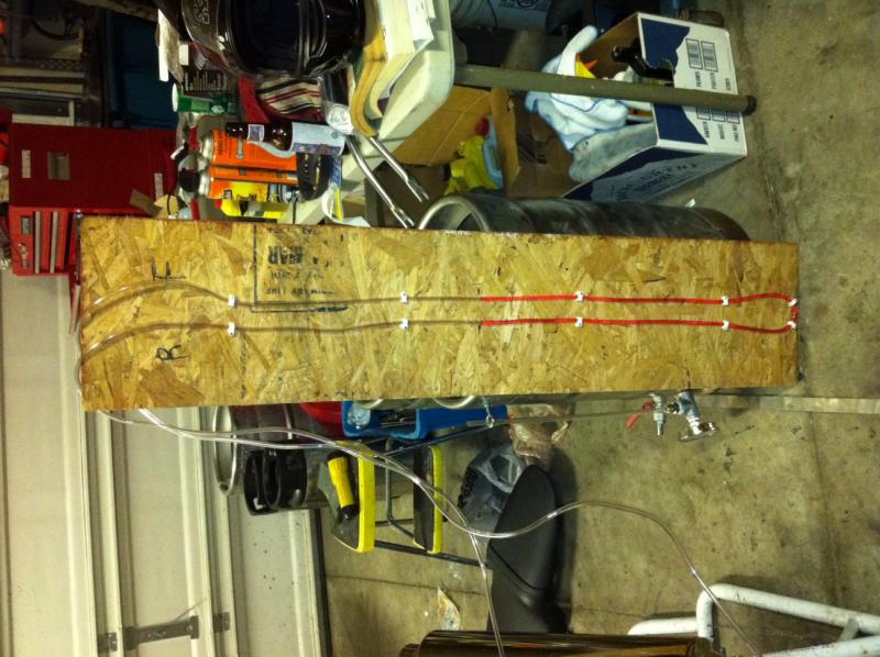

Heres a picture of what I knocked out today. Just some clear plastic tubing, mounted on a piece of plywood, with some sta-bil as the leveling liquid. It doesnt look too pretty but it got the job done.
So I took a straight through 1/8th inch vacuum fitting and got it to thread into the vacuum port on the front so I could get the job done. I started her up and as suggested, it was way out of whack. The Rear pressure was way high, got her buttoned down and leveled out and she should be all set. Its late here, so I wasnt able to get out and ride it to see if theres any noticeable difference, but I have the day off tomorrow so I'll have plenty of time. It did seem to run a bit smoother, but I wont know for sure until I get the air box back on and everything back in order. While its up on the stand I also installed new brake pads, just something else to better the feel of the bike
Ill keep you guys posted after I ride it tomorrow..

I took it for the test ride just now, and theres a noticeable difference in how the bike runs. Not necessarily a crazy performance boost, but it runs a whole helluva lot smoother, It used to kind of stutter when I would blip the throttle, not so much anymore. I did rip it up a back road here real good, and on the shift from 1st to 2nd around 8500, I felt the front wheel touch down again. So there was a little power gained there. And it pops less on Decel I engine brake. Im glad I got it done and thanks all for the recommendation. Going to get plugs today and swap those out.
