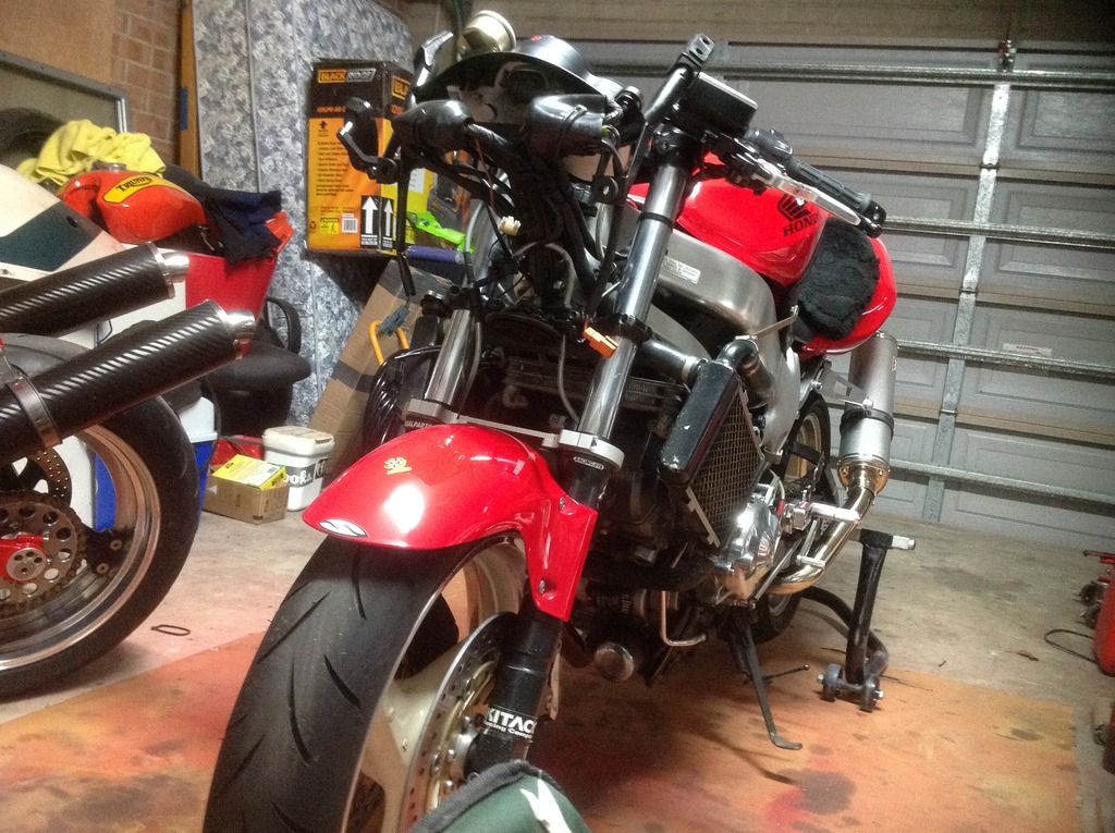

Old Dec 31, 2016 | 09:32 PM
Decided to change the coolant and repaint the radiators while I was tinkering !
Going back together,
Fitted some bigger screws to the airbox to seal it properly, cleaned the air filter and sync'ed the carbs. They were a long way out and confirmed why I felt she was feeling flat .
Started her up and the good news is she is as quiet as a church mouse ( For a VTR anyway)
Only rattle I can now hear is the clutch.
Glad I did it as I now have peace of mind that the chains are right.
Also fixed my cracked rear hugger with a soldering iron and some left over abs plastic.

Have ordered a new one but was sick of chain lubbe going everywhere without the hugger fitted.
Now to refit the right muffler and fairing, going to refit the original mirrors as I am sick of only having one bar end mirror on the right side that is all but useless.
I might even chance a ride tomorrow , but I will have to be careful as it is still "Silly Season " with double demerit points and fines.
The Police are everywhere at the moment, got breath tested and drug tested yesterday. Funny thing is that the Policeman who tested me looked like he was Stoned !
Will post pics when she is all together.

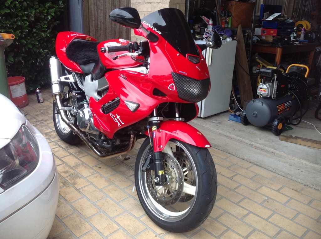

Old Jan 1, 2017 | 01:34 PM
All finished and ready to roll !
The temptation is too great, hopefully get a ride in this arvo!( Aussie slang for afternoon)
