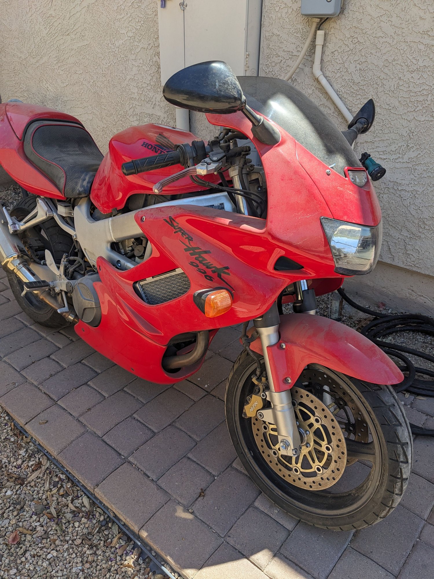

Picked up this 98 w/ 26k miles. It has tags from 2013 so it been a minute since it's seen the road. Just started to clean her up and tear her down. She turns over but the entire fuel system needs a rebuild, carb slides don't move, tank has rust and hoses are as super stiff. Trying to get the carbs off at the moment but they are currently stuck on those dang intake boots.Anything in particular I should be on the lookout while I'm rebuilding her?
