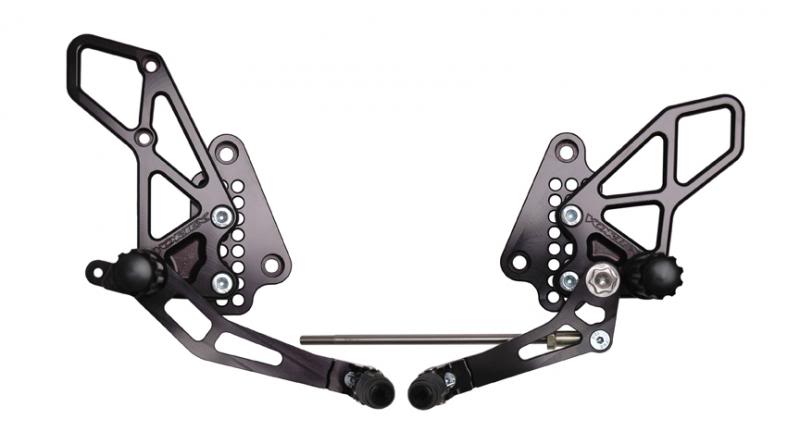

forgive my ignorance guys on this guys but......what you are wanting is just a machined bracket that will allow you to take the setup from another bike (linkage and all) and mount it to our hawk thus with a the different setup moving your foot position?
Or something complete like this which is for a Busa?

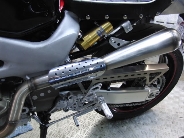

Did mine for under $150. Chinese rearsets off ebay. Alloy bracket tig welded to orig mounting.

Now thats an approach I hadn't considered. Seems like the easiest way, that plate that was welded on seems pretty thin though.

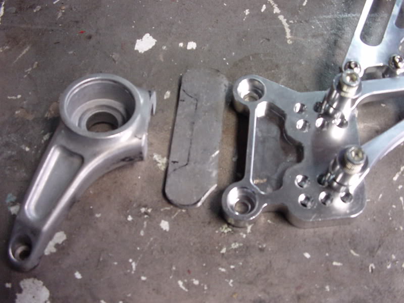

Well, if you go down on a trackday, and break off the mounting for the peg, not the peg itself, that makes it a PITA to fix, since the likelyness of that very specific part for the VTR being in stock somewhere is very low, and even if it's avaliable, it requires you to separate the bike in two halves... I have done that, and in that case I had to borrow a car, go to the nearby town and have the original piece bent back and welded, then go back and assemble the bike to be ready for the next day at the track...
With my adapters done, I can most likely find a set of CBR rearsets in 5 minutes, if I'm not too picky on price, and swap them in less time than that, since it's two bolts per rearset...
And with me making them a lot sturdier than they really needs to be, the chance of them breaking before the rearsets or pegs are about nil...

My take on this was the simple approach... I didn't have a CNC machine, just an old mill, old lathe and a old but frigging big tower drill... So I made a plate replacing the part of the pegmount that is bolted to the swingarm pivot bolt with two single holes... Those match the hole pattern of the CBR 1000RR... So I can now unbolt 4 bolts, and stick either a set of stock CBR pegs on there... Or whatever aftermarket parts that fit a CBR... And that list is a lot longer, and a lot cheaper than the parts for a VTR...
When this thread started, I think the idea was to make the same mounting to the swing, but add a star of boltholes to make it a fully adjustable rearset with the addition of a stock rearset from a suitable donor bike... That should in theory be cheaper than a VTR specific rearset... As long as the series is big enough... And the added bonus is that you skip the three pieces bolted together that I have... An adapter to the baseplate for the rearset, to the peg plate...
But my honest advice... Go for the adapter... Pick a bike with a long list of aftermarket options, and make it to that boltpattern, angle and size, be it CBR, or GSXR... Then when you guys get your sets, you can choose a chinese, non-chinese, or OEM rearset to bolt to that... Adjustable or not, each choose... It's still a marked improvement to have the option of just bolting on an adjustable set with ease, not having to find a set from one of three specific manufacturers that still make them for the VTR...

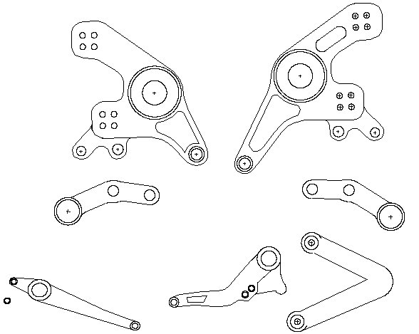

Just for kicks, below is the from-scratch design I came up with previously.

Nice! I'd buy them. But why not just make the piece that attaches to the swingarm. Then either drill for a certain bikes rearsets, our just leave them blank and people can tap them themselves.

Yepp... DIY is definitely an option... Drill press and hand tools is more than enough to make a set of basic adapter plates, to get full use of CBR or GSXR rear sets, after market or OEM...
My work aren't that far from full on DIY, being a piece of left over scrap stock, that I just drilled, countersunk, tapped thread in, and then cleaned up a little... I don't do fancy, I do basic, working stuff... I might have tools, but I could do things just the same without them...
