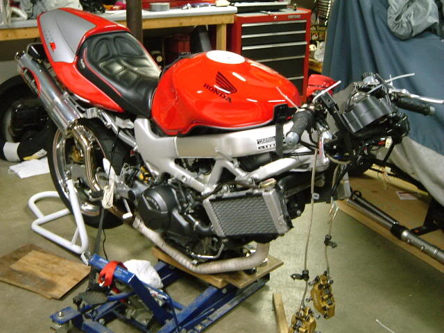

I just use 2x2 and small sheets of plywood and a rear stand as you can see below when i installed new tapered head bearing this past summer. Bike set on the stand for three days. I just use the rachet tie downs and soft ties to stabalize the bike.

Just a footnote, Thumper, the manual says to never let the calipers float free like you have them. I would think the brake lines are stong enough but everyone says to tie them off to something like the triple or clipons or the ceiling - just don't let the weight hang on the lines. Nice looking bike BTW

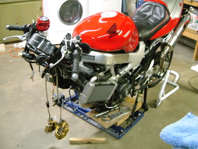

rear stand and ratchet straps to the ceiling are the ultimate combination
Old Jan 4, 2007 | 03:49 AM
denmah's Avatar
Posts: 254
denmah
Old Jan 4, 2007 | 03:50 AM
denmah's Avatar
Posts: 254
denmah
