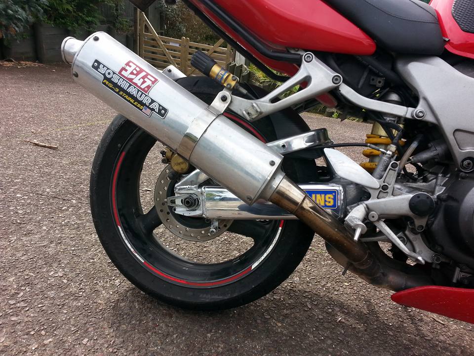

Well valves out and drilled to 1.3mm. And down to a c33 build.
Lets see how that goes.
Old Sep 19, 2015 | 03:51 AM
New Swing Arm?
Old Sep 19, 2015 | 04:06 AM
NZSpokes's Avatar
Joined: Apr 2014
Posts: 932
From: Auckland, new Zealand
Originally Posted by kenmoore
New Swing Arm?
Old Sep 23, 2015 | 02:40 AM
NZSpokes's Avatar
Joined: Apr 2014
Posts: 932
Oh now thats really good.

I take it from this comment that you have moved a step closer to suspension nirvana? If so, good for you.
Old Sep 24, 2015 | 12:43 AM
NZSpokes's Avatar
Joined: Apr 2014
Posts: 932
Yes its really good. Much more what I hoped for. now to get the back Ohlins revalved to suit.
