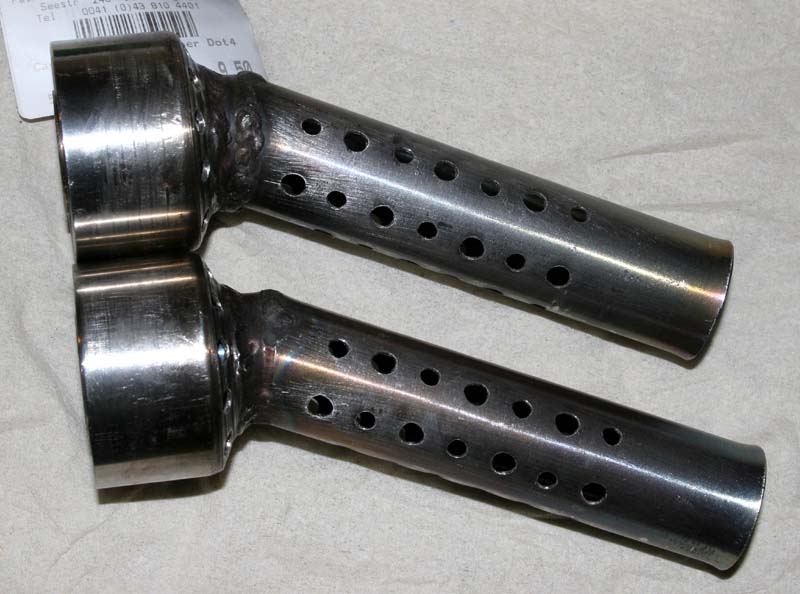

I was thinking more along the lines of something like this as it's the right shape to fit your muffler with it's downturned outlet. What you have are probably more for a pair of straight drag pipes.
I missed these and looks like they would be better with the angled inserts but
I'll probably have to notch and bend harley ones down to fit and take it from there. Thanks
