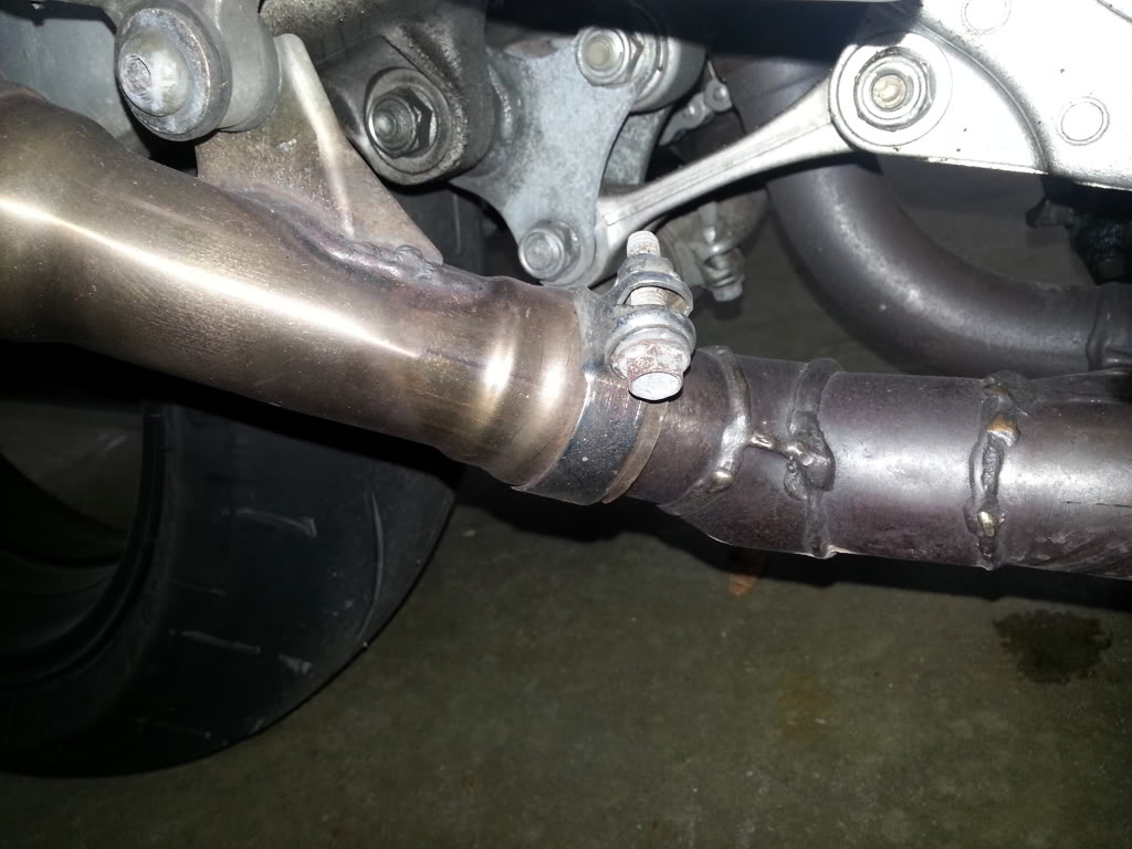

If you were to pull the exhaust off and look inside at the junction shown in the picture, the right side exhaust is restricted by ~40%-50%. In the last three stock headers that I have had, all three were made the same way.

Old Oct 15, 2013 | 02:54 PM
Like insulinboy said it's a 2-1-2 system. It does not bleed into the mufflers at the same temp at all rpm's. At low rpm's (low backpressure) most of the exhaust from both cylinders is fed into the left can (the junction under the back of the pan does this) and then once rpm's builds up the pressure evens out and both cans will get to relatively similar temps. The real way to see if either of the cylinders are running cool is to put your hand near the exhaust right where it exits they cylinders (the header). Both should be too hot to touch. My guess is the bike was idling for a bit before you tested the temps, or you you were cruising at low rpm's before you tested.
As a side note, this is why people often have a hard time making a custom 2-1 exhaust for this bike. Whatever fluid dynamic design Honda did on the pipes and aribox is hard to replicate and improve upon unless you really know what you're doing.
Edit: I'm not so sure that the front pipe is longer than the rear... I think if you were to uncoil the rear one it would be longer than you'd guess... but that's just me, I haven't actually measured it out. It certainly has better exposure for cooling.
thats what i have seen too.
