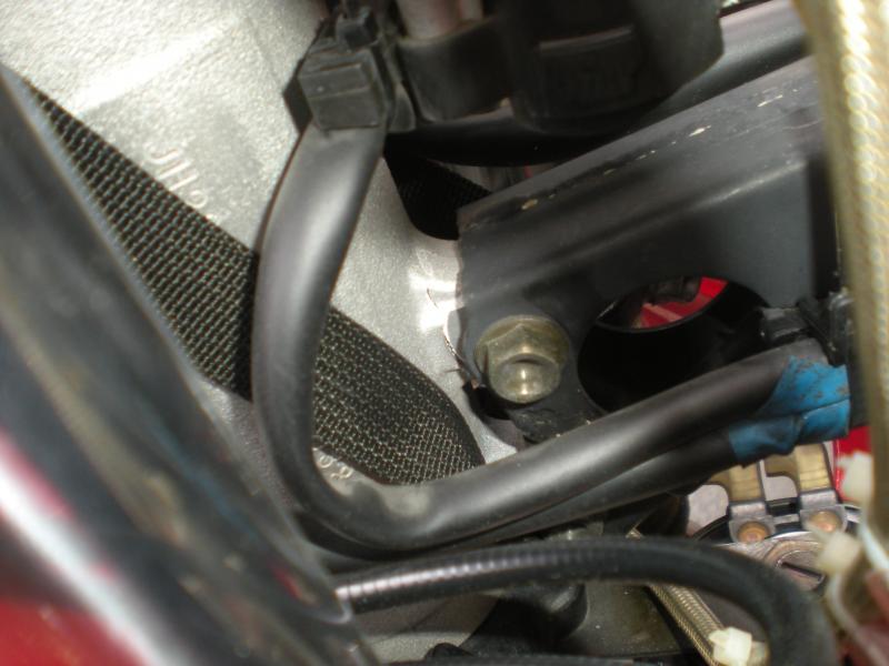

Upon further inspection I saw this..........don't look good. Can it be salvaged? Upper mount lug cracked.

It can probably... But I wouldn't... Welding on the frame is a bad thing...

I disagree. The front stay only holds the cluster and the front fairing. It's not running gear nor is it load bearing. Welding this kind of AL takes some skill so I would take it to a professional for repair. The problem is the bike prob has to be mostly dissasembled to do it right. The repair will probably be 360 degrees around the lug so everything that makes the frame more manageable during that process will prob be helpful. Engine, front end, harness, etc all gotta come out.

Well... Since the VTR's frame already have a fairly weak headstock and welding in it changes the material regardless of the skill, I still think it's a bad idea...
But if you do decide to... Bare frame is probably easiest... Droping the engine out isn't that hard...

I would think that if insurance is involved that they would total this bike for that kind of repair alone not including the other damage that you reported.
Bummer.....
There are options.
You can take the money and buy another. Make sure you take the acc. off that you want to move to next bike.
You can buy the bike back with a now "branded" salvage title, fix it or make it a necked bike. Or you can even buy a different frame from ebay without the salvage title.
Best of luck and keep us posted. We'll be happy to help out.

In Australia, no question, total write off. Frames are not safely repairable if cracked or marked. It's a question of ongoing legal liability I guess. The resale value of the bike will be seriously hurt too.

Your insurance co. (or the insurance of guy who knocked the bike over) will likely total the bike based on the cracked frame lug.
Bike Bandit shows frames (they list 2, I have no idea what the differences are) at $1700 to near $1900. By the time you add that to the other damaged bits and the labor to do the repairs you'll prolly be over their Total threshold.
As to welding, I would not hesitate to weld MY OWN frame. Aluminum welding is not really a big deal IF you have the proper equipment and skills. There is no way an insurance co. will allow your frame to be welded on their dime.

If it were me I would check with a machine shop to see if they can do it and for how much. I happen to know one and have had a subframe tab welded back to the frame there.
