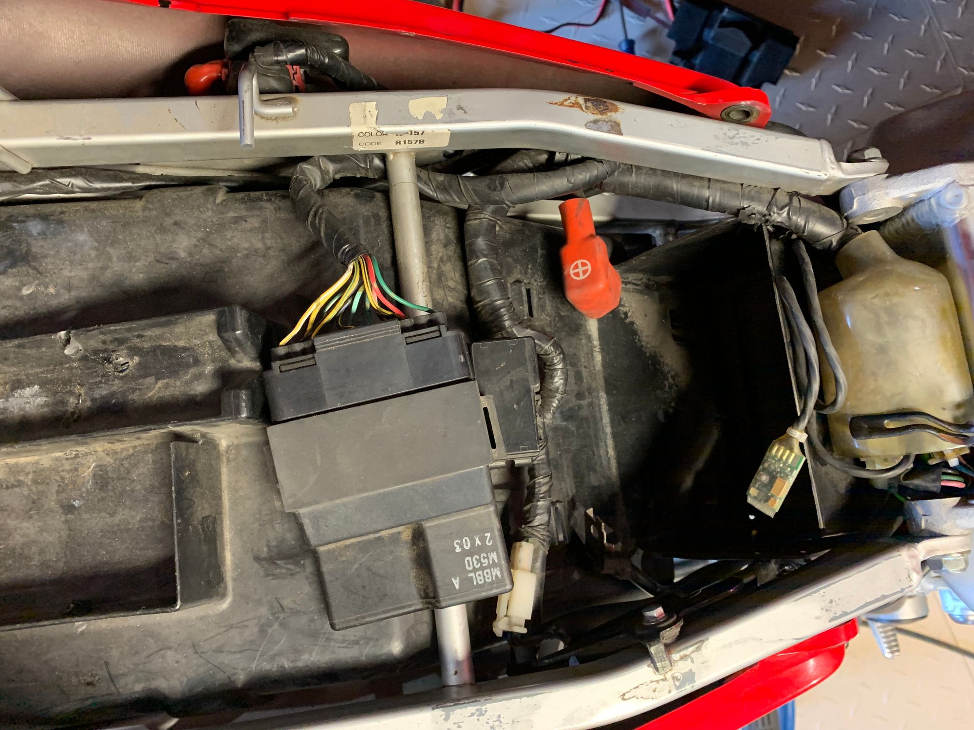

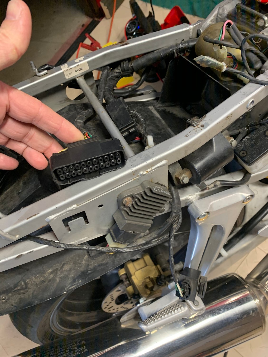

It's a 2003 Yep I keep seeing the pics of the double stack but the wiring harness, which doesn't look hacked, is about 12" too short. There's a chance this has the rear subframe of a 1998 but there's not enough wire length to reach the right side. I'll grab a pic of what I've got going

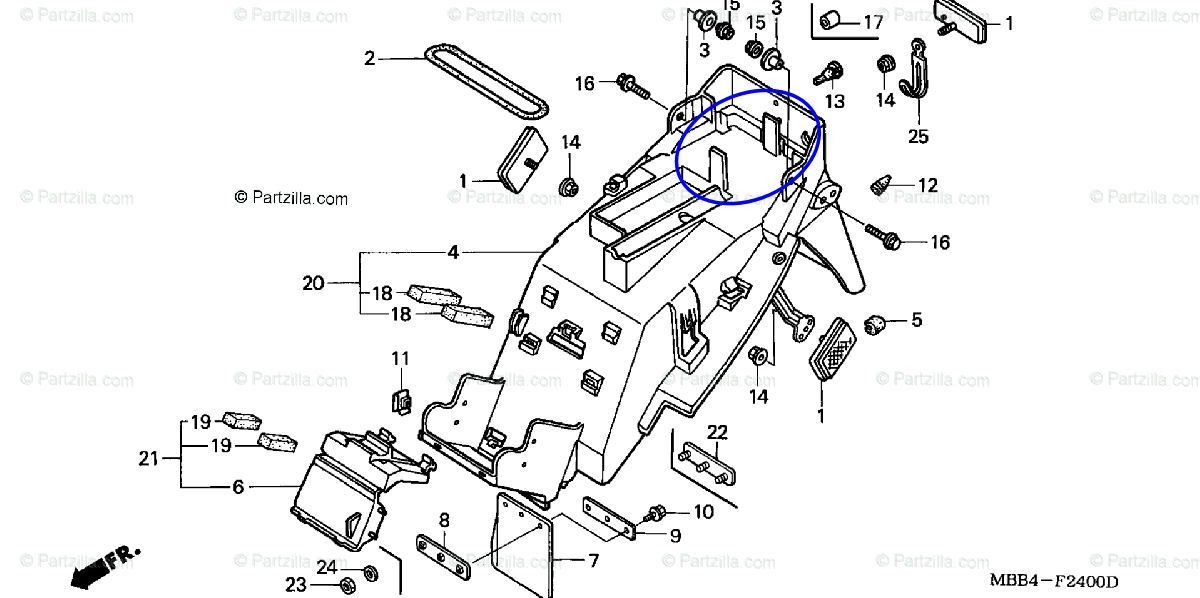

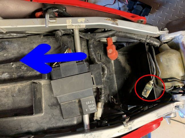

The ICU should go on the rear fender..See blue arrow AND circle
The rubber holder for the ICU has two slots that fit over and onto the plastic posts in the blue circle.
The thing I circled in red is a speedo corrector if you were not aware

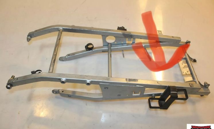

I found a 01-05 subframe on eBay (Most advertise 98-05)... the pic shows where the ECM goes on the right side outboard of the subframe... The combo of the 2003 wiring harness with a 1998 rear subframe just doesn't let you put the ECM in either place.... I got a response from the prior owner, he said he did replace the rear subframe .... So I've got that going for me. Just wondering if its worth buying the right subframe to get the wires to go to the right place
