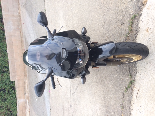

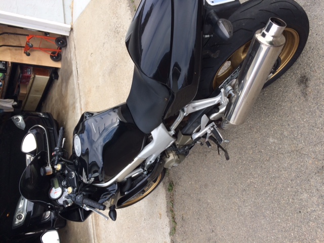

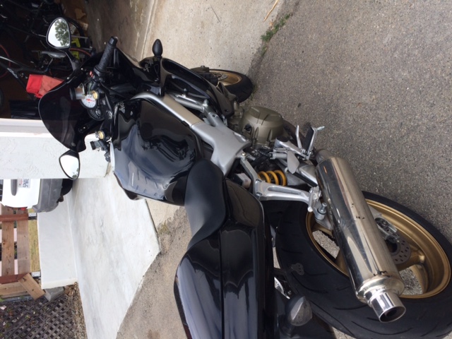

So here are some pics of my bike, and after that a couple of questions I can't really find answers to:
