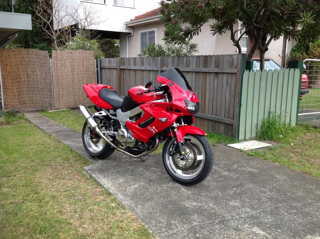

Here is a picture of my 2004, Black was the only color they came in that year. Picture is kind of crappy, bike stored in the corner of the garage waiting for the spring thaw.

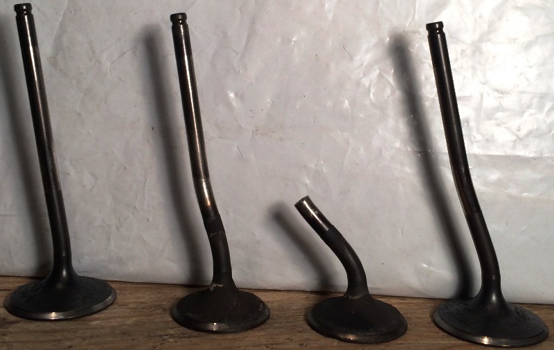

Hey Jim, I am pretty much doing the same with a month or two head start on a '98. Hopefully your valves don't look like mine did. There is someone selling r/r's on ebay right now ( FH020AA Voltage Regulator). The dealer is nps out of Salt lake City, he has them as buy now for $69.99(with over 30 available) but he also keeps listing individual ones with a starting auction price of $0.99, I got one for $36 and saw another one sell for $17. Here is a link to the one I got....you can get them cheaper than I did. Cheers!
Arctic Cat FH020AA Voltage Regulator for 2012 2014 Wildcat 1000 ATV | eBay
