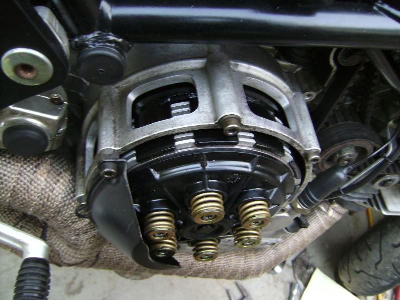

Hmm cant you just tell i HATE clutch noise by looking at my Ducati. Wait, what clutch noise?
Old Jan 6, 2009 | 12:32 PM
  #103
Hmm, I don't think you can easily do a dry clutch conversion on a SH... The duc looks nice like that though! working parts all there to see, just don't get your clothing caught in it!

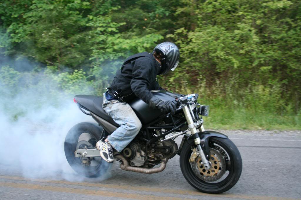

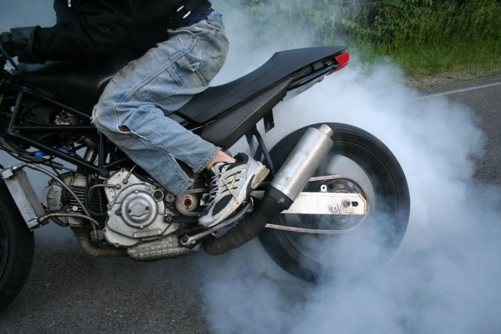

TOO LATE
