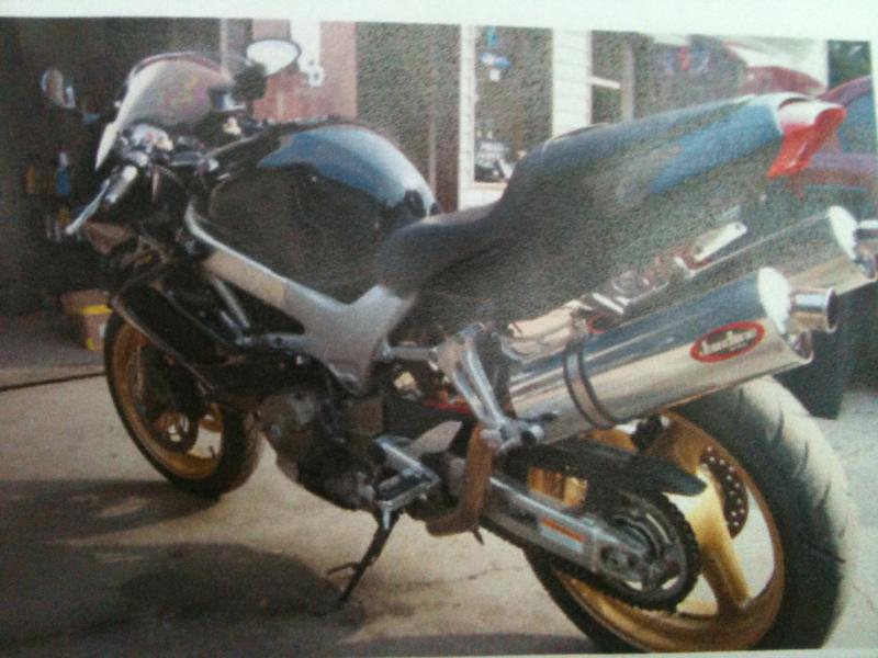

A fuzzy picture, but a picture of her none the less.
