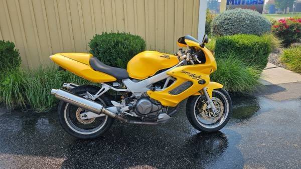

thanks! so is 3400 expensive or cheap, assuming the bike is in good working order? here is the photos on the add

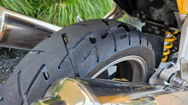

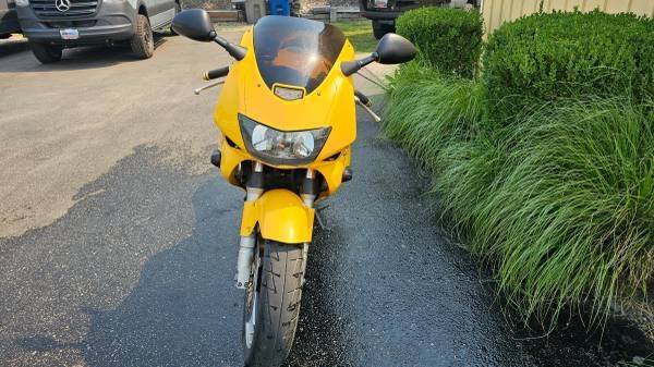

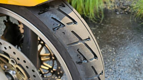

My observations from non hi resolution photos:
It has been generally well cared for and kept out of the elements.
Tail has been modified.
Grips and windscreen replaced.
Stock exhaust.
Tires look good .
The panels and tank looks to have the original paint with no obvious damage .
I can't tell from photos if CCT has been changed to manual, but you can do that later.

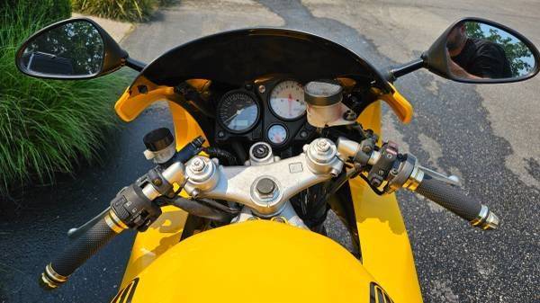

Price is hard to judge from a few pics as there are many factors. How many others are for sale close to you and what's their ask? There's definitely lower priced ones around me but condition varies. Is this your first motorcycle? I always tell "new" people to look at the chains condition. If the owner takes meticulous care of that, good chance he cares for the rest of the bike. It its bone dry and loose, he may not be the type to do routine maintenance. Looks to me the clutch fluid reservoir shows pretty brown fluid. Routine changing of that is kind of important. If not done, it can gum up the master cylinder and more importantly, the slave cylinder. It's a common issue on these older bike and can show signs of a slipping clutch or poor lever feel.
This is just a sample of some of the things I consider when looking at a used bike. I could go on and on.
As mentioned, those cct's can just go boom any time. IMO, that will need addressed straight away. How mechanically inclined are you?

Something is slightly amiss. The bike has first gen clocks and handlebars. An '03 should be different.

Yeah, don't think that is an '03. 2000 at best. Pretty sure Yellow wasn't an '03 color, that and with the first gen guages as xeris pointed out, I think this is a '99 or '00. Look at the steering head for the year.

thank you all, I will make sure to check the things you guys have advised and to do the same with the questions. but, regarding the cockpit, does it look normal for a '99 or '00 ? or is it pieced together? also, what tail modification has been done, as hang fly mentioned? side note, it is OBO, so I'm sure I can talk him down

Looks like a standard 2000. I had a yellow one in that vintage, looks proper for it.
More than likely the huge plastic rear fender was hack sawed off. I did the same to mine shortly after getting it.

Yes, cockpit is normal for a '98-'00. I'm pretty sure yellow was only a '99 & '00 color. The front turns are aftermarket. Can't see any rear turns, definitely not stock rear turns. Tail looks normal other than a trimmed rear fender like Wolverine said. I think I see a stock auto CCT on the rear cylinder, but hard to tell in the low res pics. The year will be on the steering head. Look for cracked or broken mounting tabs/around mounting holes in the plastics.
