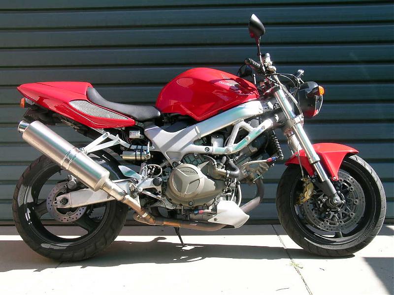

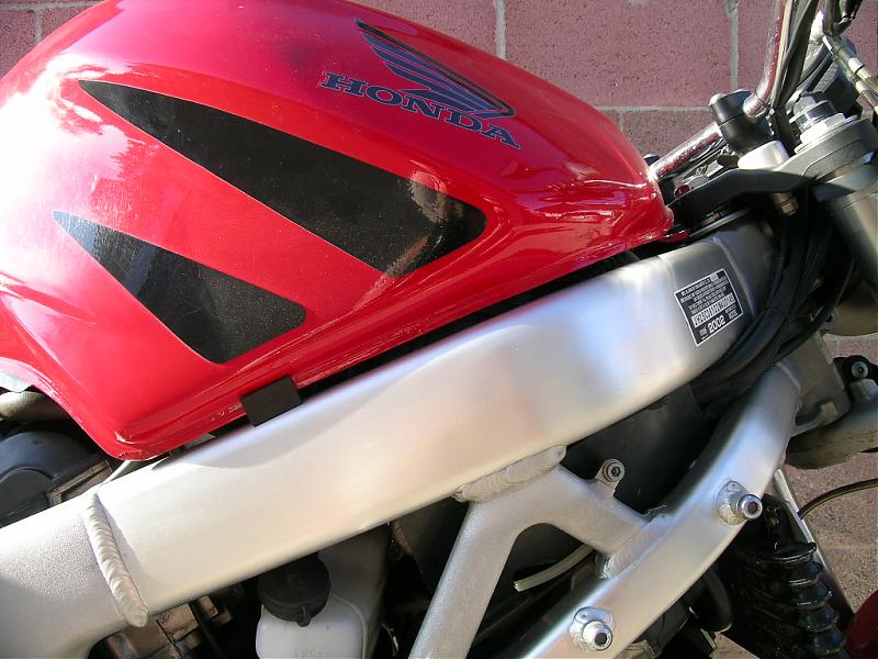

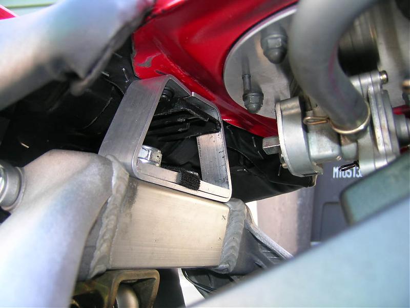

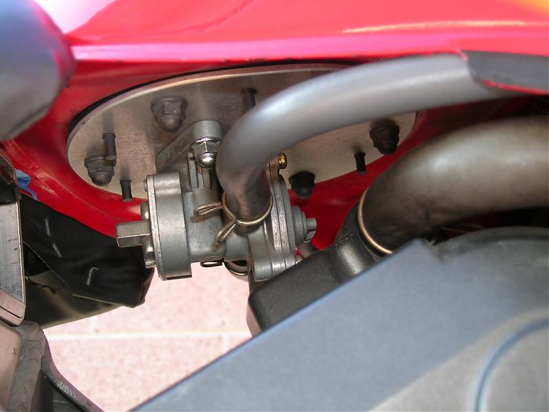

Having done the VFR tank mod ( 98-01 model year VFR ) I have to strongly agree with Superbling.
It holds 5.5 gallons and installs with relatively minor mods, i.e. no welding required.
You'll have to make an adaptor plate for the fuel valve and modify the airbox lid to clear the fuel sender besides slightly indenting the front of the tunnel to clear the airbox lid in the front on either side.
It also follows the contour of the frame quite well and feels the same as far as leg spread
( sorry ) is concerned.
Also the reach to the bars is about the same and I raised the seat height about an inch to give my knees a break.
I've included one detail shot of the fuel valve and rear mount and what the bike looks like with the tank installed.
Kai Ju

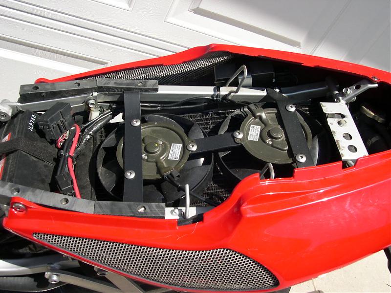

"Minor mods" are a matter of relativity. Not having the appropriate tools for such an endeavor would perhaps place my course of action into the realm of "major". Cutting and buzzing a tank would not fall outside the parameters of "minor" for me.
That said, the pics posted by Kai Ju look pretty good. I recall the pics posted by 'bling didn't look as good, but I think they were preliminary and not of the finished product. I didn't like the looks of the tank contour vs. the frame.
Could Kai Ju post more (closer) pics of the side of the bike, where the frame meets the tank? And of the seat/tank interface?
Thanks,
Mike

Yeah, I wanna see some more pics if you have any. Maybe from the front to see if it bulges out the side at all. Looks pretty good in the pic though. How long did it take you?

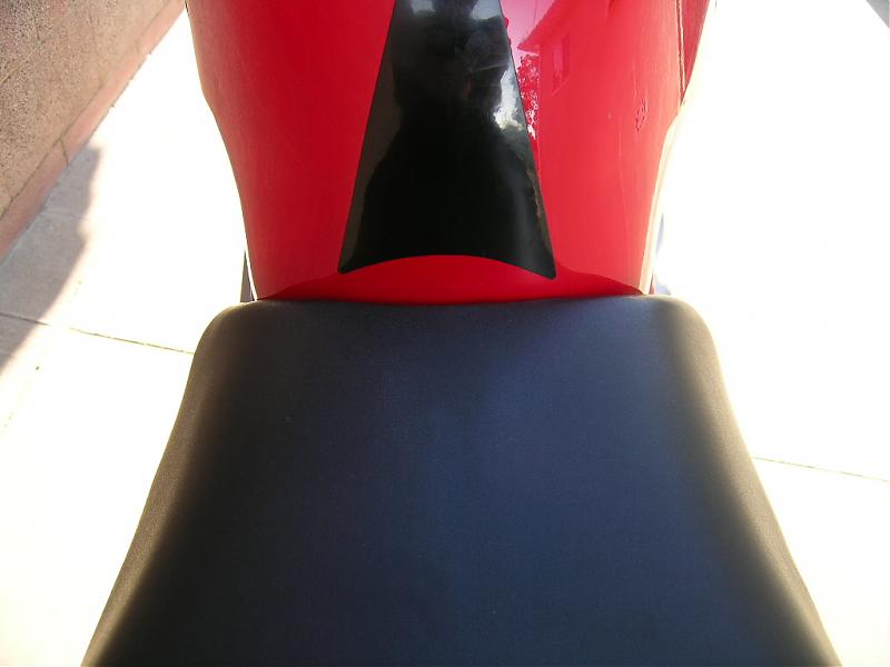

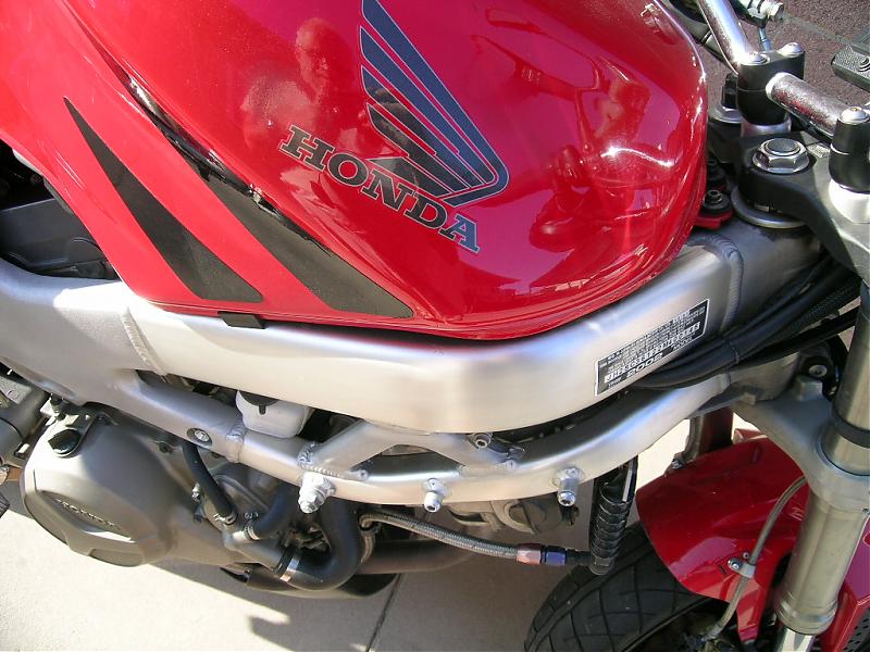

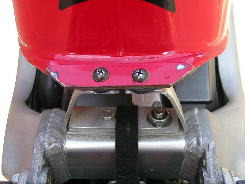

Sorry about the delay but here are some pics, as requested.
As you can see the tank shape follows the frame rather nicely with no overhang.
It is slightly longer which forced me to shorten the seat about half an inch.
I also had to raise it which gave me more legroom and allowed the installation of a second fan, so all in all a winning combo, more range, and more comfort to do so.
Kai Ju
Attached Thumbnails larger gas tank-tank-frame-gap.jpg   larger gas tank-tank-frame-contour.jpg   larger gas tank-seat-junction.jpg   larger gas tank-fuel-valve.jpg   larger gas tank-rear-mount.jpg

Hey Tom
The VFR tank mod will give you the extra range and, the way I did mine, also take care of the seat issue. As a bonus it will also give you more leg room.
I had to raise the seat about an inch to get the proper seat tank junction as well as shorten it about 3/8 to 1/2
You can see the riser blocks in the pic, they are attached with riv-nuts.
The tailsection now attaches to the riser blocks instead of the subframe.
Look at some my earlier posts in this thread for more pics of the tank to frame junction.
I love the extra legroom which also helps with the extra distance I can go.
Kai Ju
