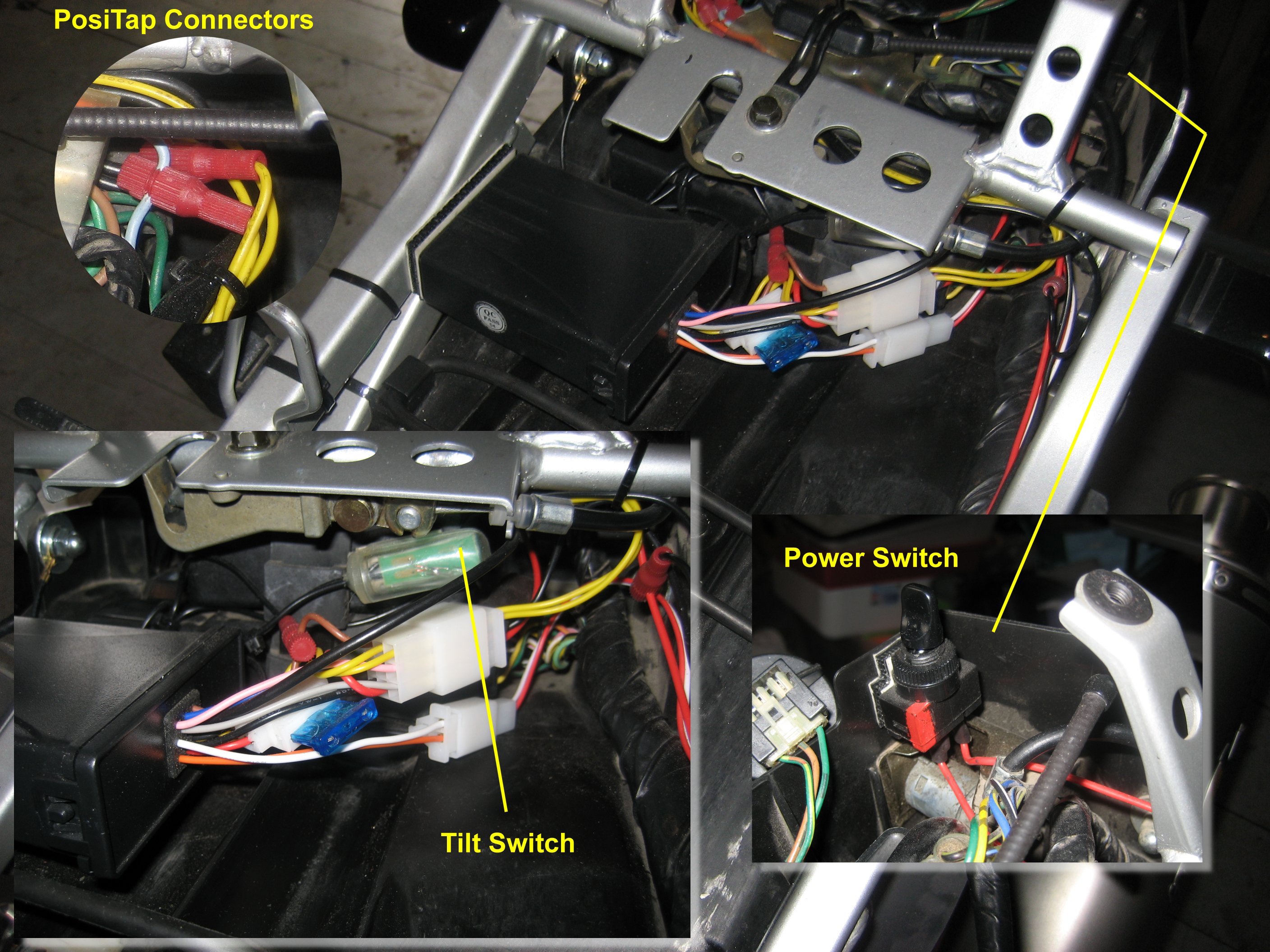

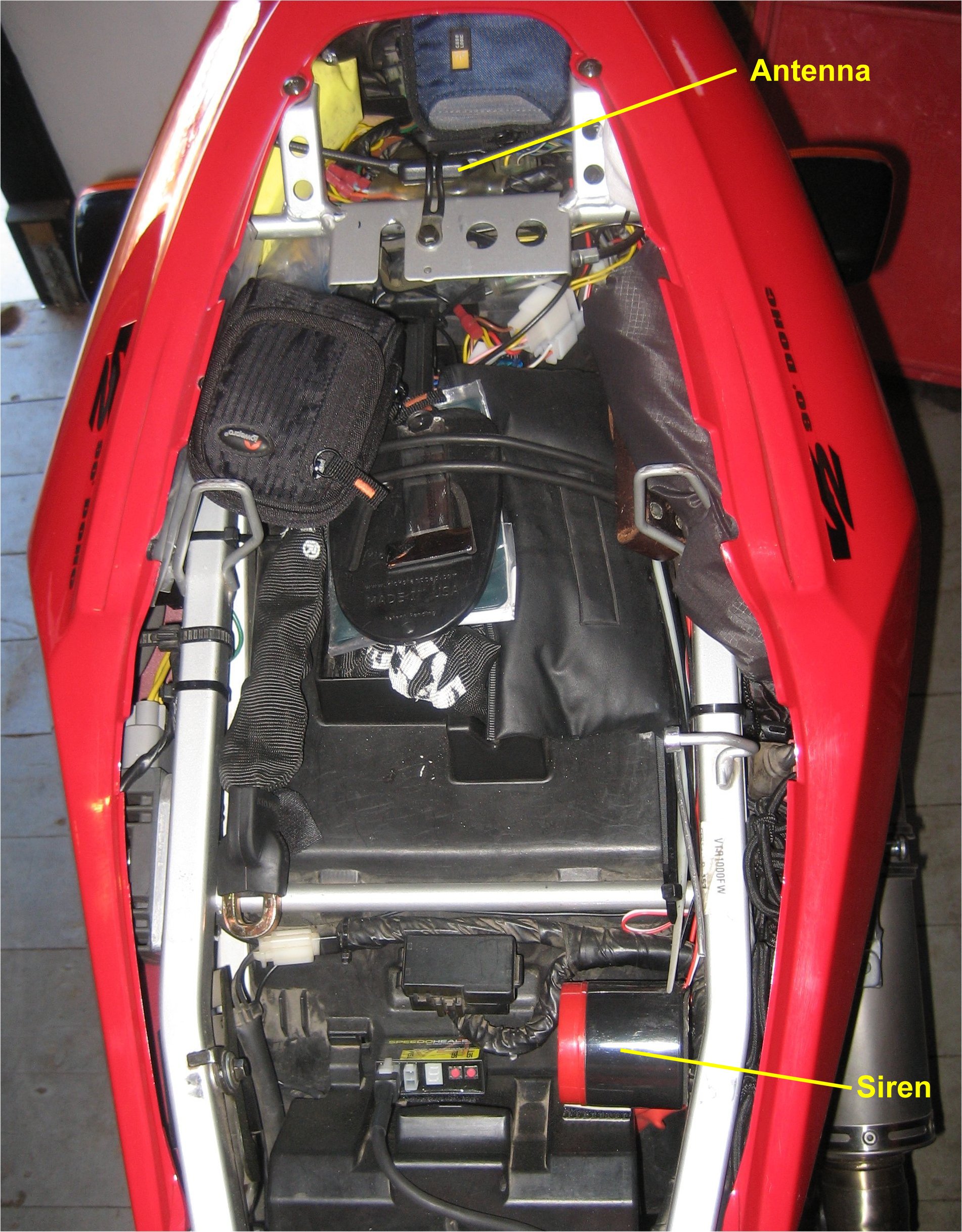

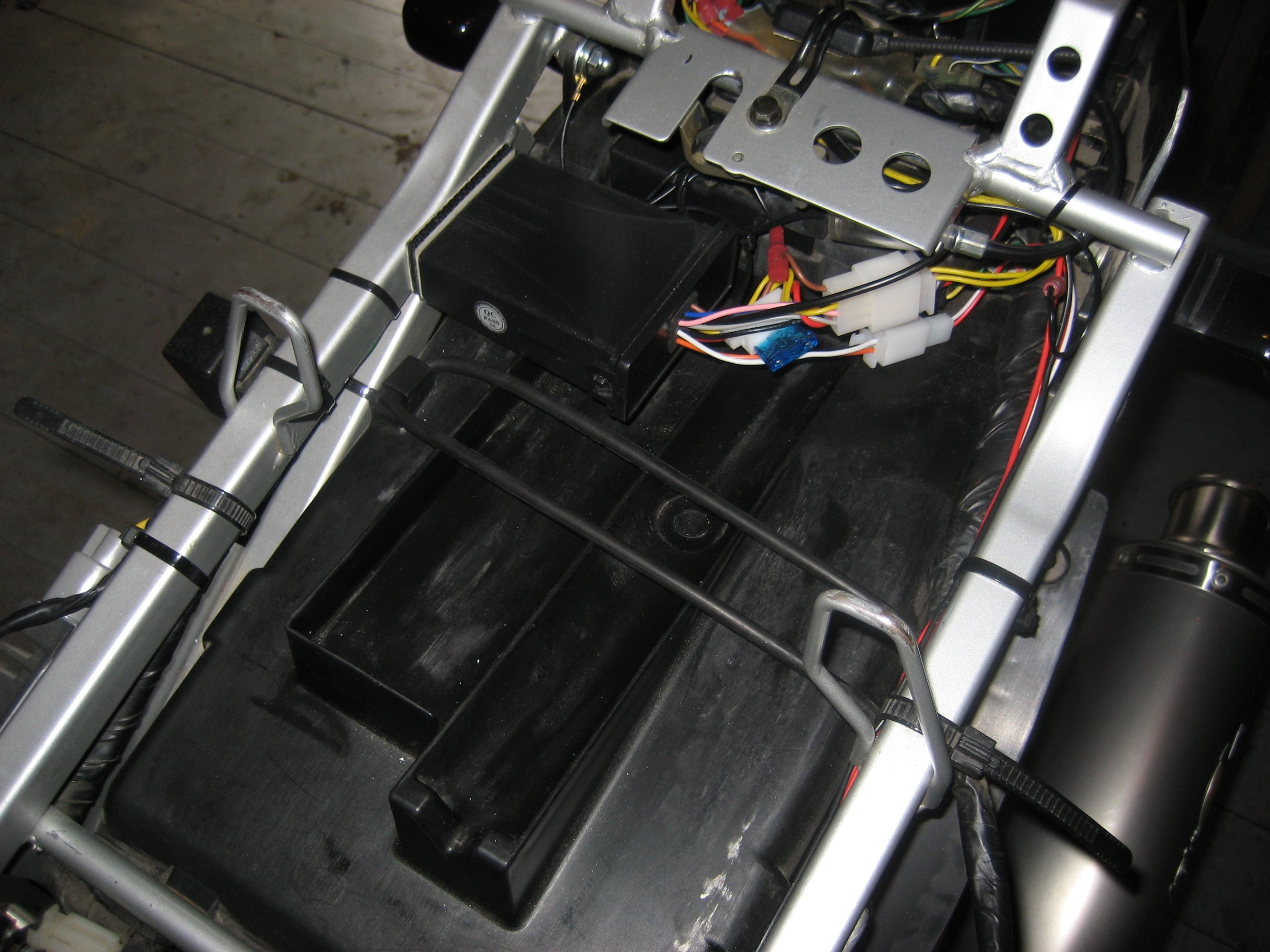

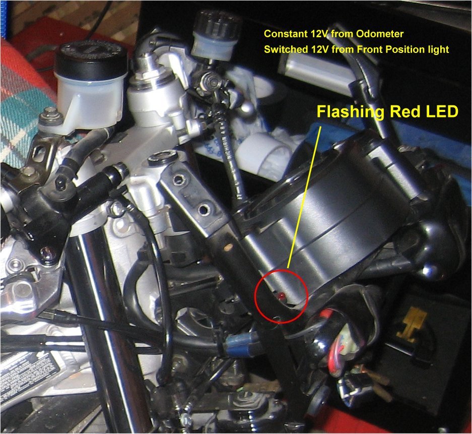

Hi all. Installed an inexpensive alarm on the VTR last spring as an additional theft deterrent. Bike is normally covered, chained and rotor locked but wanted to slow them down a little before it’s heaved into a van. Standard offshore two-way box with remote arm/disarm + activation chime. Shock sensor only (no proximity box) so I added a mercury tilt switch. The power on/off switch is handy if you need to cut system from battery. Easy integration with PosiTap connectors. A few of these cheap alarms also come with flashing ‘system armed’ LED’s. None on this one so I stuck a flashing red light near the instrument cluster hooked to constant & switched 12V sources. Light flashes whenever the key is turned off. Hook & loop install on rear tray and there’s still room for all the other stuff I lug around.
Steve – Halifax, Nova Scotia
Attached Thumbnails Inexpensive Alarm System-alarmlocation1.jpg   Inexpensive Alarm System-alarmlocation2.jpg   Inexpensive Alarm System-tailcontents.jpg   Inexpensive Alarm System-led-location.jpg
