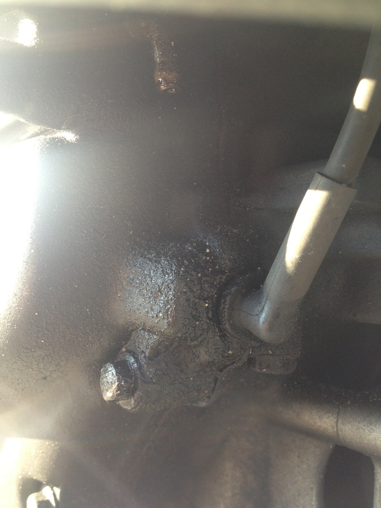

The leak at the front could be from the small relief hole in the front of the engine that allows coolant to leak externally rather than into the oil when the water pump seal fails underneath the clutch cover.

I found a wet spot, I'll upload a pic in a few minutes

its built up in this area, above it is dry.

yup that's a water pump seal gone if its dripping from that spiggot. You'll need to get the clutch cover off to fix it
Download the Honda service manual PDF from the workshop section for how to get at it.

Kid gave me the service manual with the bike, and it's oil not water or coolent O.o

Okay - put that on hold. Degrease the area and see more precisely where the leak is coming from.

That was exactly what I was thinking, pick up some parts cleaner spray, run it for a bit and see where it's coming from. Working 9-5 sucks lol
That's smart. It was my thought as well.
Clean up the grunge, then you can see whats happening with a possible leak.
If you're good with a wrench, I'd reccommend taking the fairings off, and inspecting everything for yourself.
It's a good idea to familliarize yourself with your new ride anyways.
