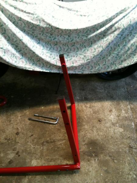

I had a little time on my hands today...

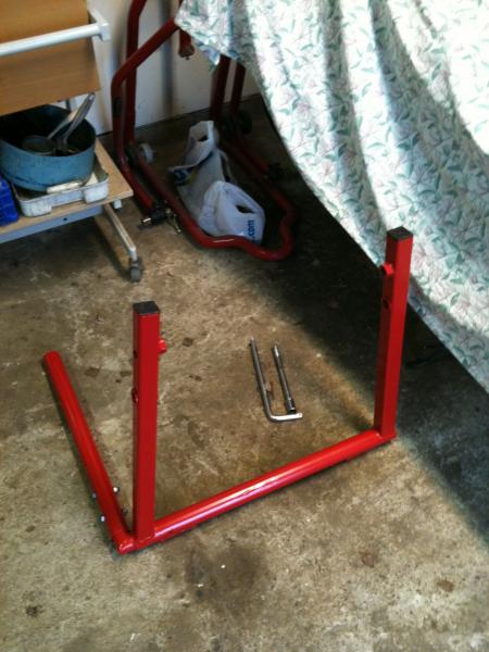

So as usual I managed to take something apart...
This time I molested an old bedframe with an anglegrinder and welder... The result was a workstand for my bike that's a lot easier than any I have tried to date... And all of those I forked over money for...
This was my inspiration: http://www.werner-staender.de/anbauanleitungenglish.htm
Attached Thumbnails I had a little time on my hands today...-img_0131-17.jpg   I had a little time on my hands today...-img_0131-18.jpg

And the bike cover?????
Bike, Bath, and Beyond????
Old Mar 30, 2010 | 02:37 PM
Hey! Don't mock!
Actually it's gubermint issue curtains from the local hospital ca 1990 or so... I have used it on the bike the last 8 or 9 years... I'm pretty sure she would feel funny going in winter hibernation without it now so I'll keep it...

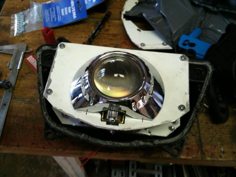

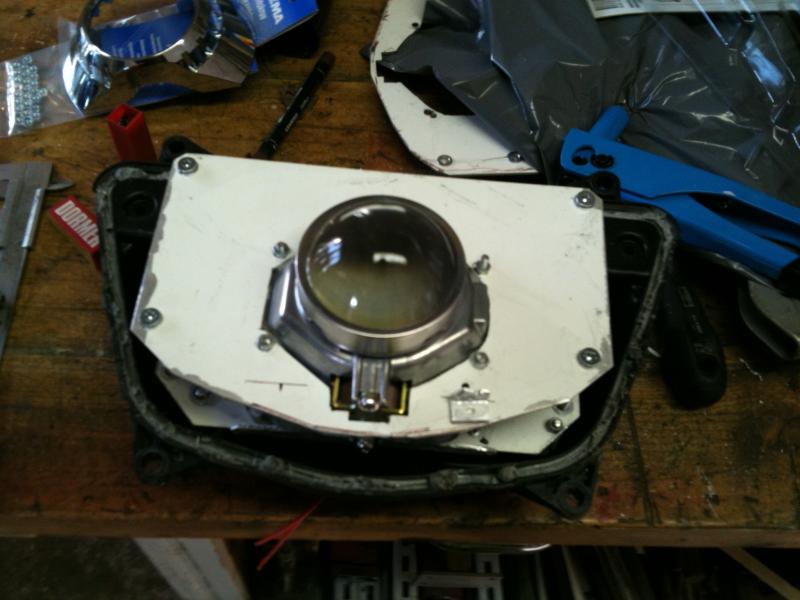

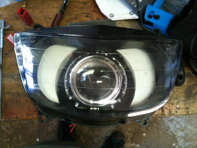

Ok... So I'm bored tonight...
Here's my other project today... Another (improved) HID projector setup... I'm doing this for a mate's VTR (he's been wanting one since I did mine)...
A G35 projector was used, the matching pair to the one already on my bike... But I decided that this time it was going to fit completely inside, not have the connector for the bulb poking out to interfere with the fairing/gauge bracket at the rear... Mine is a very tight fit...
Another pre-requisite (also on my original) was to keep the ability to aim it with the bolts at the rear of the housing, just like stock...
Some finishing touches and some matte black paint on the front aluminum plate and it should be done... Pretty sturdy, light weight and looks decent... The connector on the bulb sits flush with the edge of the hole in the housing, and has enough wiggle room to aim it, and remove the bulb... Though I doubt doing it with the faring on the bike will be anything less than a royal PITA...
