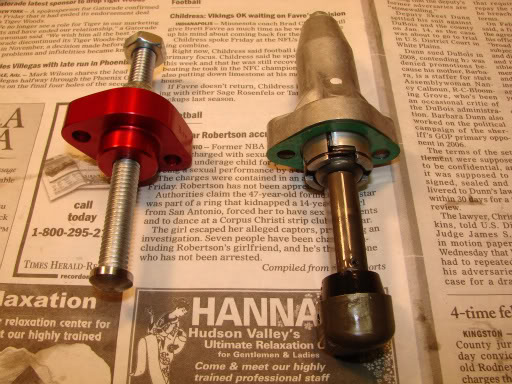

The rear CCT is located by the rear header, and is fully visible just by standing next to the bike... A stock CCT is a grey metal tube, slightly tapered with a small bolt sealing the end... An aftermarket manual one is usualy, bot not neccesarily a colored alu piece with a much larger bolt sticking out, that you can thread in to increase pressure... Ie exposed thread...

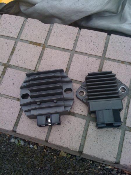

My pics from the R/R change...
(Big one is Yamaha, small Honda 2nd gen finned R/R)

Left After market, Right OEM.

Not too sure what you guys are looking for- inspecting an OEM CCT won't tell you much about whether or not it will fail. The spring inside breaks without much warning, and looking at the spring doesn't give much indication of how weak it is (at least I wouldn't imagine that it does).
A few posts up is a good pic of what a manual CCT looks like vs an OEM one. These are by far the most common- a few people on here have modified their OEM CCT to become a manual one- basically by using the stock housing and putting their own threaded bolt in. Bottom line is, find your CCTs, look at them from the outside to determine if they're OEM or not. You can see the rear one very easily from the right side of your bike. Just look under the back near your shock and it's mounted to the engine block. Your inspection is done at this point.
If you have manual ones, you don't need to worry about anything else. If you have OEM ones, they can fail, nobody knows when or exactly why, so your options are to leave it, replace it with another OEM one and keep doing that to avoid failure, or replace it with a manual one...
