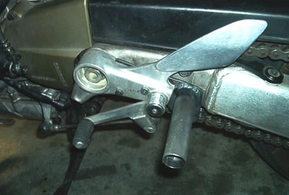

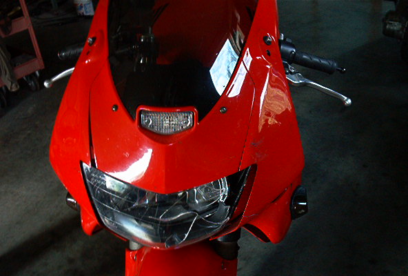

it was bound to happen sooner or later where i live, out on some PA back road. had less than 2 seconds to react, from about 65mph to maybe 45 at impact. full size deer- direct hit at 45 degrees from the left. snapped the footpeg, snapped off the bar end mirror, pushed the left fairing forward 2 inches, busted the headlight lens, bent the clutch lever...
i'm here to say you can ride one of these out. didn't lay it down. stuck my knee into it's ribs and leaned the bike into it like hip checking a hockey player. it's critical to not freak out or do anything sudden. i was lucky it wasn't a t-bone... got pushed to the rough, off camber right shoulder that was about 1 foot wide and rode the ragged edge for a couple hundred feet- woods over the bank on right... i credit calm nerves, the suspension and the tires for the save.
time to go do some repairs...

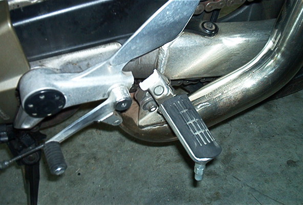

yeah, it's ironic. bought this bike because i'm tiring of working on vintage project rides. and it looked practically showroom.... anyway, minor damage and obviously could have been far worse. i've always said- it's not going to be me, but some damn animal or another driver. the former being more prevalent on my usual rides. used up another of my nine.
really was not in the mood to pull the whole swingarm bolt just to get the left footpeg bracket off, plus the cast aluminum can't be welded anyway without weakening it substantially. fabbed up a bolt on steel peg that will also hang the exhaust as per original. now to fix the smashed headlight and tweaked fairing...

Not bad as a temporary solution looks almost like an aftermarket foot peg

As an FYI someone has removed the swingarm bolt in the past and re-installed it the wrong way.
The nut should be on that side as you need to remove that rearset in order to pull the chain without cutting it.
