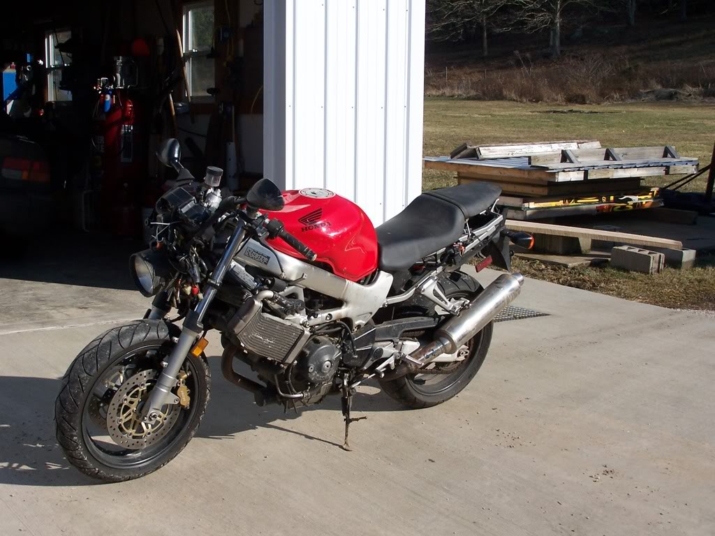

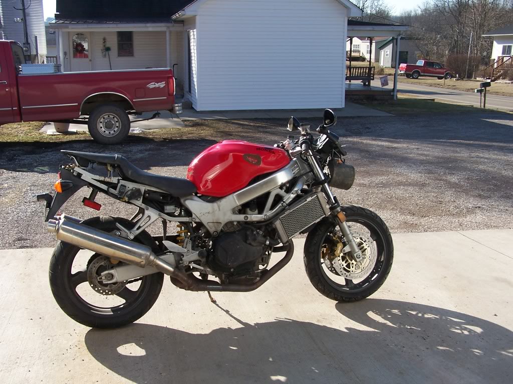

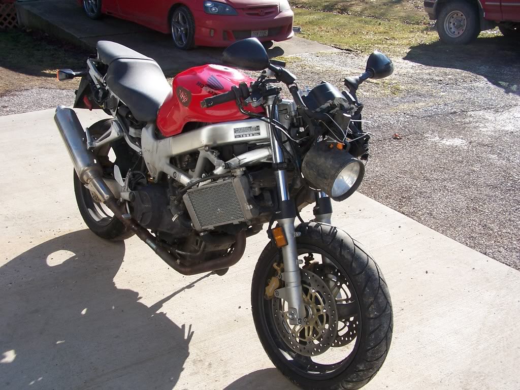

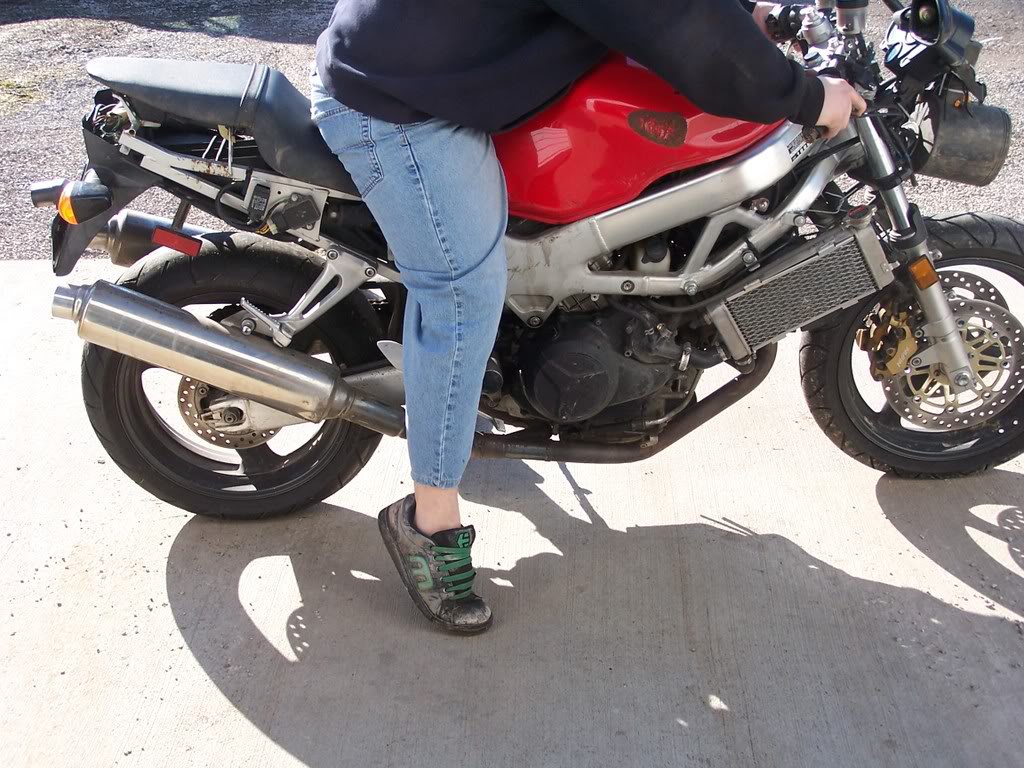

_lunch_box_'s Avatar
Posts: 32
_lunch_box_ is on a distinguished road
here you go boys
this is the $600 bike
Old Feb 8, 2009 | 07:07 PM
marmaladedad's Avatar
Hmm?
Joined: Oct 2004
Posts: 2,069
From: San Gabriel Valley
Ouch. That radiator got crunched. Otherwise, not too bad for $600. Headlight has got to go.
Straight forks and swingarm and wheels?

You might also check and see if anyone has added washers to the shock mount to raise the rear height. Like is said above, I'm 5'8" and have a 30" inseam. I think somebody has been messing with the rear shock. It's been spacer'd, replaced with the wrong shock or assembled wrong. Download the manual, print the appropriate pages and compare to your bike. Good luck.

Old Feb 9, 2009 | 04:18 AM
Posts: 32
yes i laugh really hard at that spot light, you can'ts see it but it has the cord raped around the trigger and zip tied it to the light assembly bracket
i checked the shock it doesn't have any spacers
and it looks to spec
i'm just that short that pic was takin with the preload all the way down
so is lowering the front just as simple as loosening the triple tree clamps and leting them slide threw???
Old Feb 9, 2009 | 04:31 AM
nothing's Avatar
ride it out
Posts: 745
From: NH
yes, it is that easy. but you bottom out faster and more easily so be careful
Old Feb 9, 2009 | 05:32 AM
RK1's Avatar
RK1
Posts: 2,547
From: Way Out West
Sorta. You have to lift the front end enough to unload it and block up the bike under the front of the engine before you loosen and have to make sure that each tube slides up exactly the same amount. If you just yank them up or shove a wedge under the tire you might get one moved more than the other.
Best to leave the clip ons on, lift the tubes a bit higher than you want them, stick spacers between each clip on and the top clamp then let them drop down before you tighten up.
Old Feb 9, 2009 | 09:33 AM
I want you to take a measurement if you can. I was messing with some other stuff down in the shop this morning and ran across my stock shock. I went back to your picture that shows the shock from the side. It looks like the coils on your shock are farther apart than mine. Mine is on the second to the bottom on the adjuster and the shock measures 13.5 inches from mid-eyelet to mid-eyelet. Our stock shocks are not the only ones that look like this and it could be that whoever got this bike for liquidation sale might have used a shock that looked the same but actually fits some other Honda.
