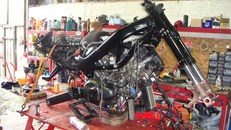

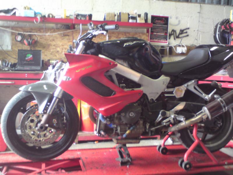

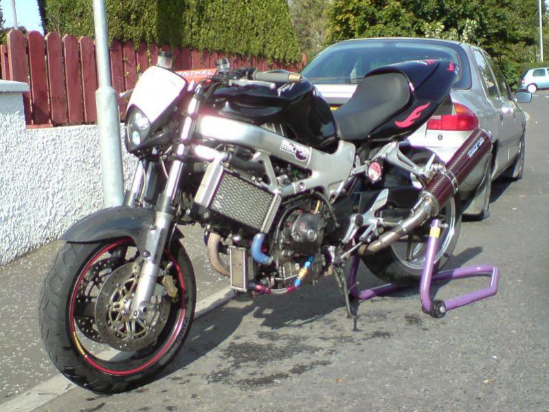

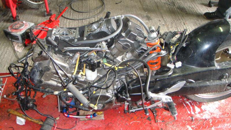

howdy , gonna start a thread on a build im undertaking at the mo , hope its of some intrest ! hoping it wont go on too long (expecting a month or so i can catch a bit of weather ) assuming we might get some this year ..
i bought a heavily modified naked style firestorm a couple of months ago , bike seemed like a good buy but had no history so a bit of a gamble .
running (i was told )
moriwaki pistons/cams flowed heads, full micron system, fuel pump ,aftermarket programmable ignition, modified airbox/carbs and close ratio gearbox.
(im guessin its ex track ..)
put a few miles on just to make sure everything seemed ok , and happy out, its nuts
not everybody is gonna like the style this bike is headed , dont ye know some fkrs just have to be different and some people are going to prefer it before i chop it up !!!
i believe the bike was sold on ebay in the uk , i than bought it in nortern ireland , currently in dublin
Attached Thumbnails hawk vtr naked/streetfighter build ireland-strm-ftr3.jpg   hawk vtr naked/streetfighter build ireland-storm-ftr.jpg

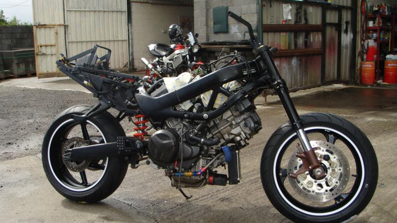

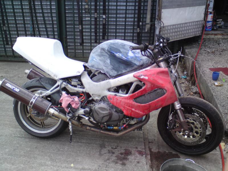

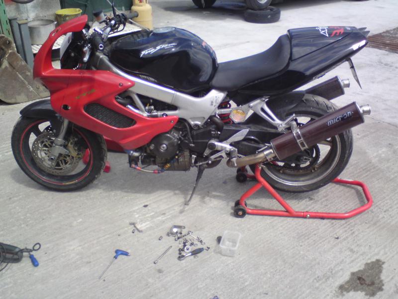

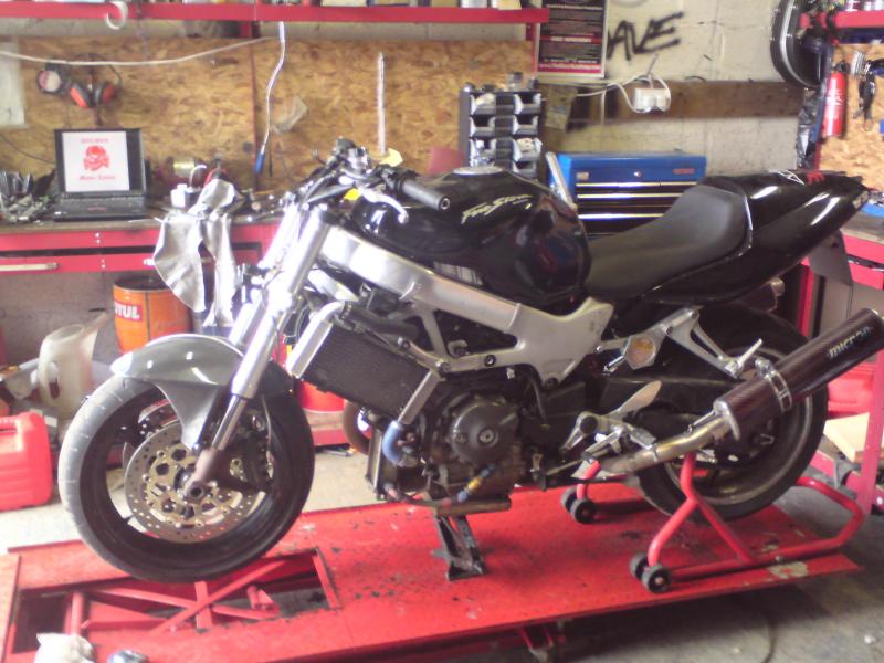

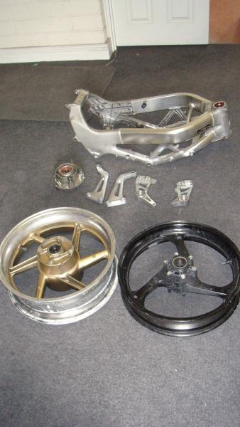

some more;
adding fairings to make a naked
cbr1000 front end
Attached Thumbnails hawk vtr naked/streetfighter build ireland-dsc00063.jpg   hawk vtr naked/streetfighter build ireland-dsc00067.jpg   hawk vtr naked/streetfighter build ireland-dsc00069.jpg

good luck with your build. the top picture looks a bit un balanced. kind of like a girl that is 5 foot tall with a a size cup and a 38 inch waist. put some **** on this bike the *** is to big. lol

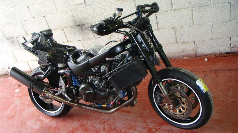

5150 , yup itll be getting a bit of fattening up alright
Attached Thumbnails hawk vtr naked/streetfighter build ireland-dsc00090.jpg

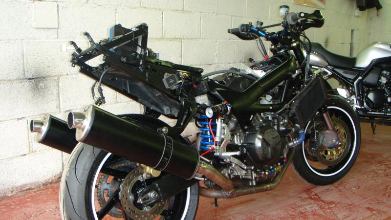

Old Aug 4, 2009 | 01:39 PM
motokraft's Avatar
motokraft
Posts: 111
From: dublin ireland
motokraft is on a distinguished road

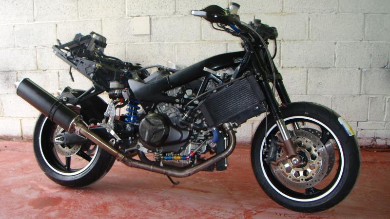

Attached Thumbnails hawk vtr naked/streetfighter build ireland-dsc00414.jpg

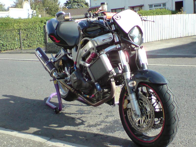

Old Sep 4, 2009 | 02:44 PM
motokraft's Avatar
motokraft
Posts: 111
another pic
Attached Thumbnails hawk vtr naked/streetfighter build ireland-dsc00417.jpg

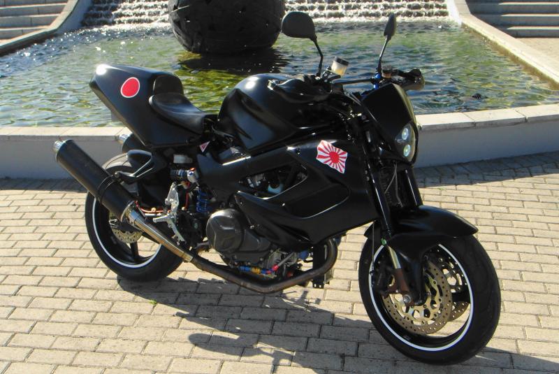

its comin on , few up to date pics
Attached Thumbnails hawk vtr naked/streetfighter build ireland-dsc00479.jpg   hawk vtr naked/streetfighter build ireland-dsc00480.jpg   hawk vtr naked/streetfighter build ireland-dsc00481.jpg

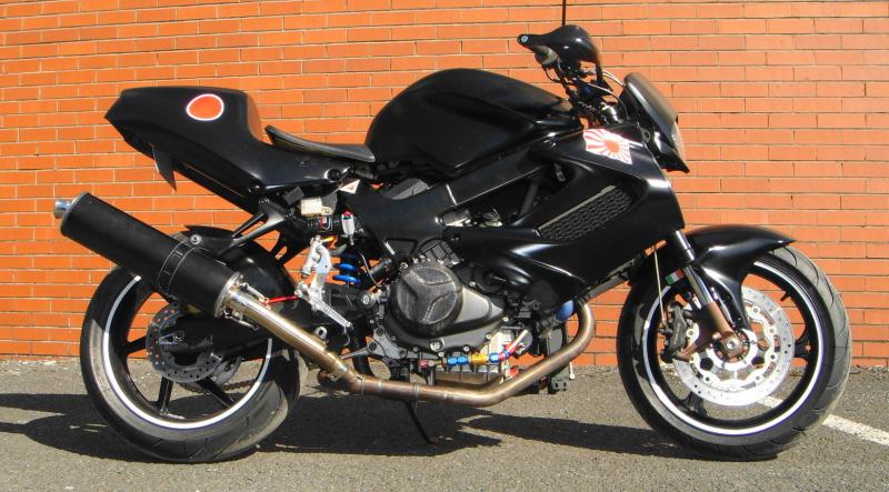

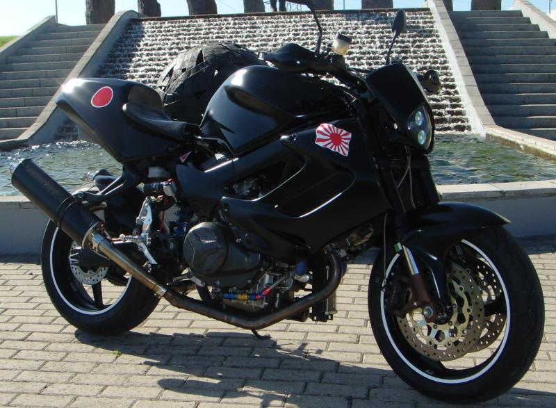

so final spec ;
MORIWAKI PISTONS
MORIWAKI CAMS
MODIFIED CARBS
MODIFIED CCT'S (THEY WORK)
MODIFIED AIRBOX
STAN STEPHENS PORTED AND FLOWED HEADS
SEBRING EXTERNAL OIL COOLER WITH GOODRIDGE BRAIDED LINES
CLOSE RATIO 1ST AND 2ND GEARS
PROGRAMMABLE RACE IGNITION VIA LAP TOP (SOFTWARE INCLUDED)
was geared high , so one off the front three on the back new c +s
cbr1000rr fireblade 06 complete front end
harris rearsets
pazzo levers
koso instruments
all new wheel bearings / steering head bearings
wilbers high spec race shock
iridium plugs new filters , race oil
braided lines/new pads / race fluid
vfr tank , ducati 900ss sl seatunit
carbon hugger ,
would be worse than a standard vtr in town
but when the go buttons can be opened
my arm and shoulders fucked , but managed an hour on it today
Attached Thumbnails hawk vtr naked/streetfighter build ireland-vtr222.jpg   hawk vtr naked/streetfighter build ireland-vtr223.jpg   hawk vtr naked/streetfighter build ireland-vtr224.jpg
