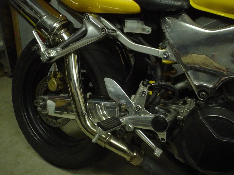

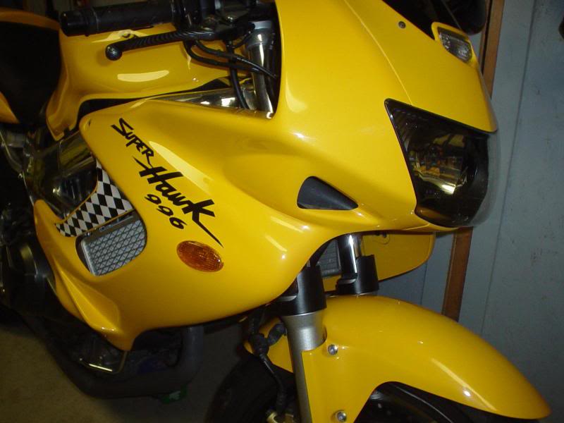

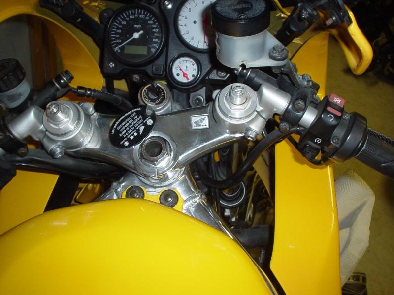

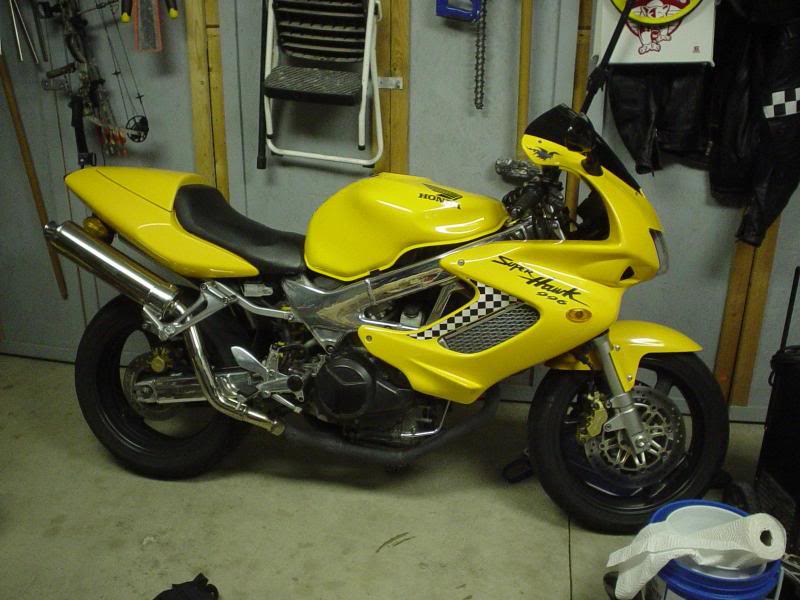

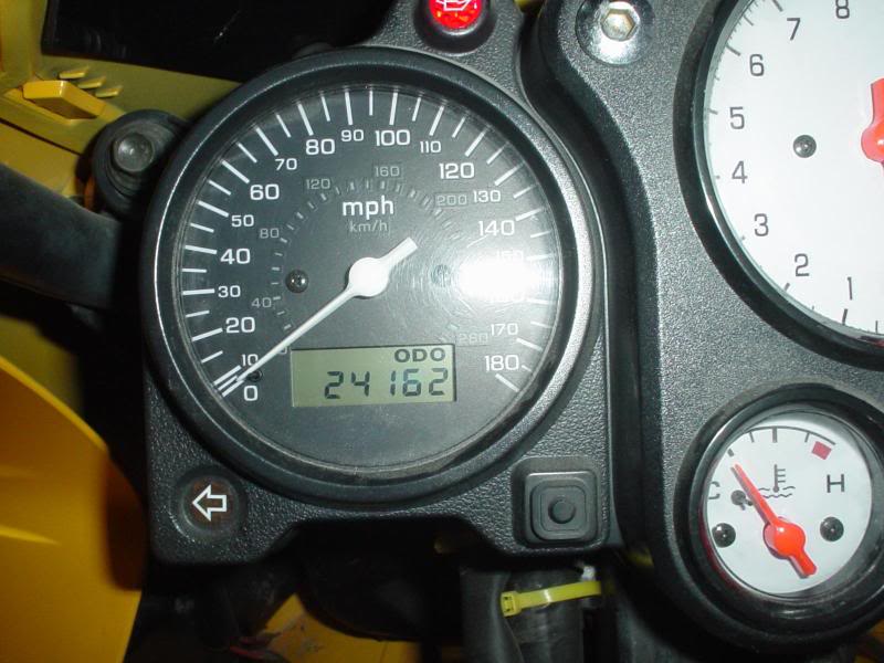

The guy I'm buying the superhawk off of wants 2500 for it. He originally wanted 2850 for it but I talked him down. It's a 99 with 24k on the clock. He claims the chain and sprockets were replaced along with a valve clearance check at 19k. I'd like to use this bike for street duty and a couple long sport tour rides down to the appalachian mountains this summer. I think its a good deal but want some current owners opinions first. Thanks for any responses in advance.
Here is the guys quote and the bike is adult owned and seams to be well taken care of.
Nick, the chain and sprockets where changed at 19,500 miles, valve clearances where checked at that time by a dealer in michigan. the guy that sold me the bike showed me the receipts. I would say its gonna need a battery soon, also a set of rear brakes they are getting thin. other than that its good to go. I rode the bike to virginia beach and deals gap before I parked it in garage in 08. I drained the fuel and put on trickle charger. added a few gallons and it started right up. This has been a great bike, NO PROBLEMS!!!!! I bought a harley thats why I am not riding it.

Old May 17, 2010 | 01:05 PM
Common problems are Cam Chain Tensioners and Regulator/Rectifier... If the CCT's are swapped at regular intervalls for OEM ones or swapped for manual one's they become a non issue... The R/R is prone to failure, swap for a newer generation with fins or an Yamaha R* R/R and that as well becomes an non-issue... Other than that it's the standard maintainance and condition that decides... Price seems reasonable...
Flaws that I and others have adressed by small adjustments are plentiful, but none of them are a dealbreaker, the VTR is a much more allround bike than the SV, but share some similar traits...
