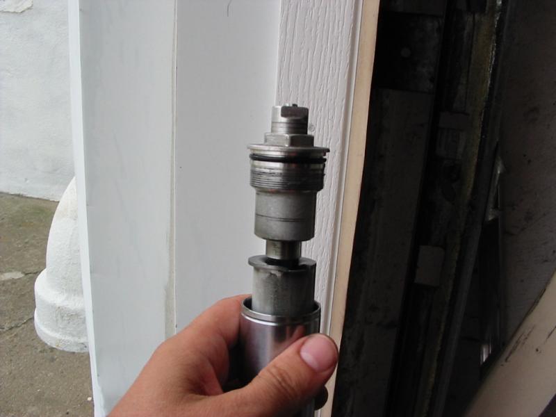

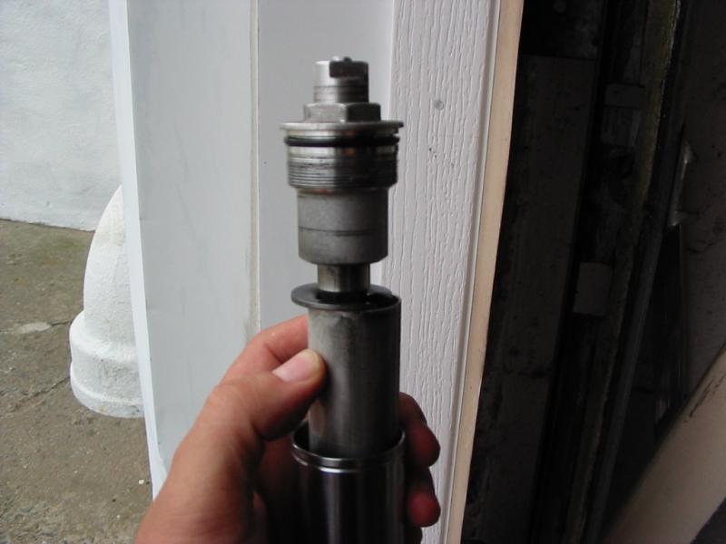

Glock, for the seal, check out this vid
Most fork seals that have "gone bad" just have a bit of debris causing the leak.
Also, for the preload, you can open the forks, on the bike, one at a time (brace the bike from sag) and add a spacer to add preload and stiffen the front end. You can either make them of pvc and split it, or aluminum and make only one cut, put it in and button the fork tube back up.
And you can add like an inch of heavy fork oil (30wt) while your in there. Less air space and greater viscosity will give you more damping to go with the spring.
Some may call these temporary, but really, you can get pretty close like this and NO disassembly. Forks stay on the bike.
Its mostly between race racetrack tricks to tweak suspension but I did it on the (daily)hawk and it is great. I also have cbr1000rr forks on my SSS hawk. Those are another level but this is very good.
